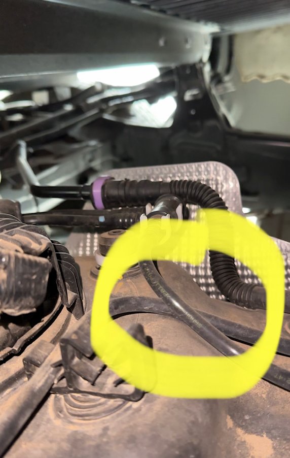

    Using the description and pictures posted in the other thread on this topic, I looked under my truck and I think I found the problem. In my case it is indeed a flexible plastic tube/hose laying on top of a metal (brake line I suppose) tube. The plastic tube can be moved easily. I can see evidence of them touching in that the plastic tube has some scuffing on it where the dirt is rubbed off. But I don't see any evidence that the plastic tube is damaged in any way. But yes, over a long term this could turn into a problem. For the time being I'm going to let the recall process play out.

    can you take a pic of what your talking about?

    I am pretty sure he is talking about the spot in my photo on the previous page. You can clearly see the plastic line crossing over and perhaps touching the metal brake line. it would touch there as it bounces as you drive because it is not clipped down to the frame or to the brake line. This area is straight in under the truck toward the center through the front of the rear passenger side wheel well.

    thread "23TA09" has posts with FB pics - they describe and show the area in detail. I took a look and none of my metal or plastic lines are in contact and all are secured in clips that prevent them from contacting. In all cases where they cross you can easly put your finger between them. No preventative measures here for me - just going to wait for the dealer to do their thing when they get around to it.

    Checked clearance on my non-hybrid June 2022 build today.
    Ample clearance between the two brake lines and the fuel line in question. It was nice and dusty under there which made it easy to determine there had not been recent contact between the two. Did a closer inspection and it appears they have not had any contact which resulted in chaffing to the fuel line. I just used my eyes and an inspection mirror. Bore scope certainly would have been handy, but not necessary.
    Big thanks to all those that contributed photos and information throughout the thread. Made finding the area in question very quick and easy.

    thanks to raylo. It is in the rear passenger side. here's some pics:

    that is wild, if one is metal and the other is rubber without a force acting upon it in downward pressure. I do not see any way that the rubber hose would wear enough to go through and leak fuel.

    Exactly. Same spot shown in my photo in post 214 above.

    Maybe with heat? Is the risk actually melting and not rubbing?
