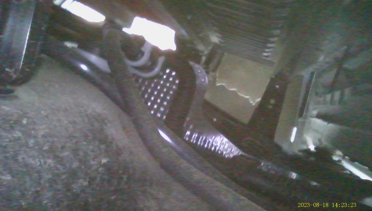

    I took my boresope out today and got a photo of the offending tubal intersection. The black fuel tube crosses over the metal hard brake line... this right above where the passenger sway bar end link terminates. On mine, it seems that there is a bit of separation between the two lines but I suppose that black fuel tube could vibrate a bit underway and maybe make contact. It seems this could easily be fixed by making a clip to keep the lines separated. Or even just cover the black fuel tube with one of those split corrugated wire looms. I believe that this spot can be reached pretty easily with the right rear wheel removed so this kind of fix should be pretty painless. But if someone had one with significant wear that tube might need to be replaced, which would be a much bigger deal. I'll probably pull my wheel off one of these days and see if I can design a 3D printed clip, small side to snap onto the brake hard line and a big end for the fuel tube, to give them a firm separation.
  30. Aug 18, 2023 at 2:06 PM
    #150
    Breathing Borla
    Jan 21, 2020
    #41531
    6,624
    Northern Illinois
    do you have a cleaner pic?
    Im going to see if I can look at mine, and see anything.
    worst case, a few wraps of Tommy tape and it would keep it from wearing until the fix is out
