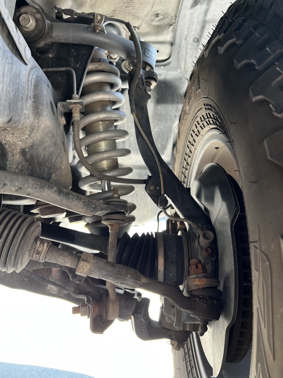

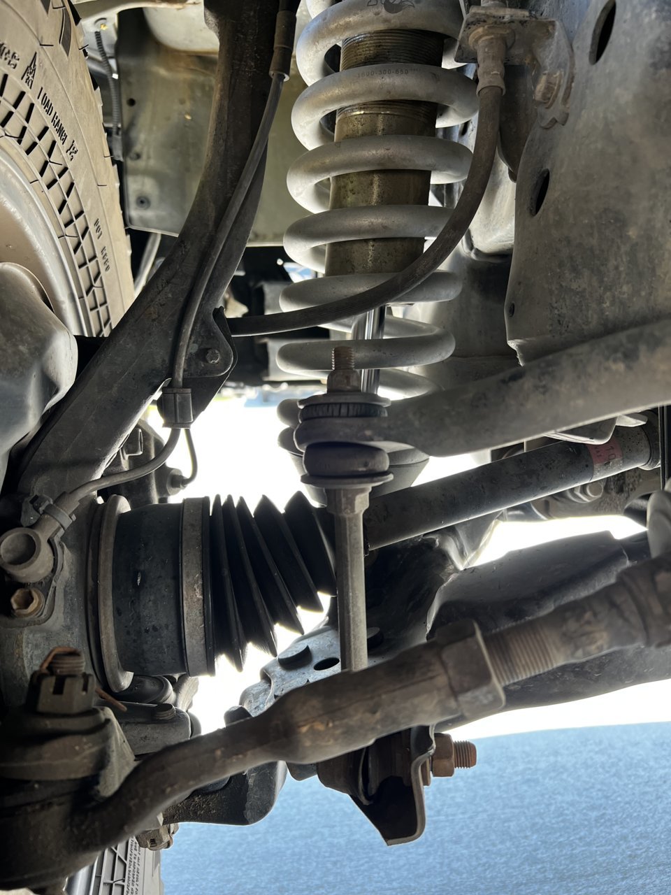

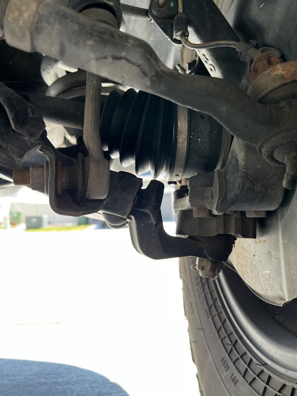

    As you guys can see everything is pretty clapped out, obviously replacing oem with better suited parts is the goal. I'm just trying to find out in what order I should go about in the process. I've gone to two shops here in the Meridian/Boise area of Idaho. The last shop was a bunch of guys my age (20-21) and I definitely trusted them at first, but I'm thinking its not all their fault as my parts are under a lot of stress.

    The best thing you can give to us: Your current alignment numbers.
    Also, are you just having issues getting an alignment that doesn't lead to wander? Or issues with getting into alignment, period? Or are you having issues keeping alignment once set?
    I consider @assassin10000 to be an alignment guru. I've seen him time and time tell people these trucks ride best with the following alignment, even though some shops will say it's wrong. Dozens of first gen owners haven't been lead astray with these numbers:
    -0.1 to -0.3 camber
    2.6 to 2.8 caster
    0.1 to 0.2 total toe in
    Camber -0.1 if mostly freeway driven.
    If you like corners/onramps at speed then -0.3 to offset outside edge tire wear somewhat.
    Total toe in 0.15 - 0.20​

    If your alignment is changing, you need to fix why first.
    Again, what do the alignment cams and bolts look like? Are they OEM or aftermarket? How are the control arm bushings? Etc.
