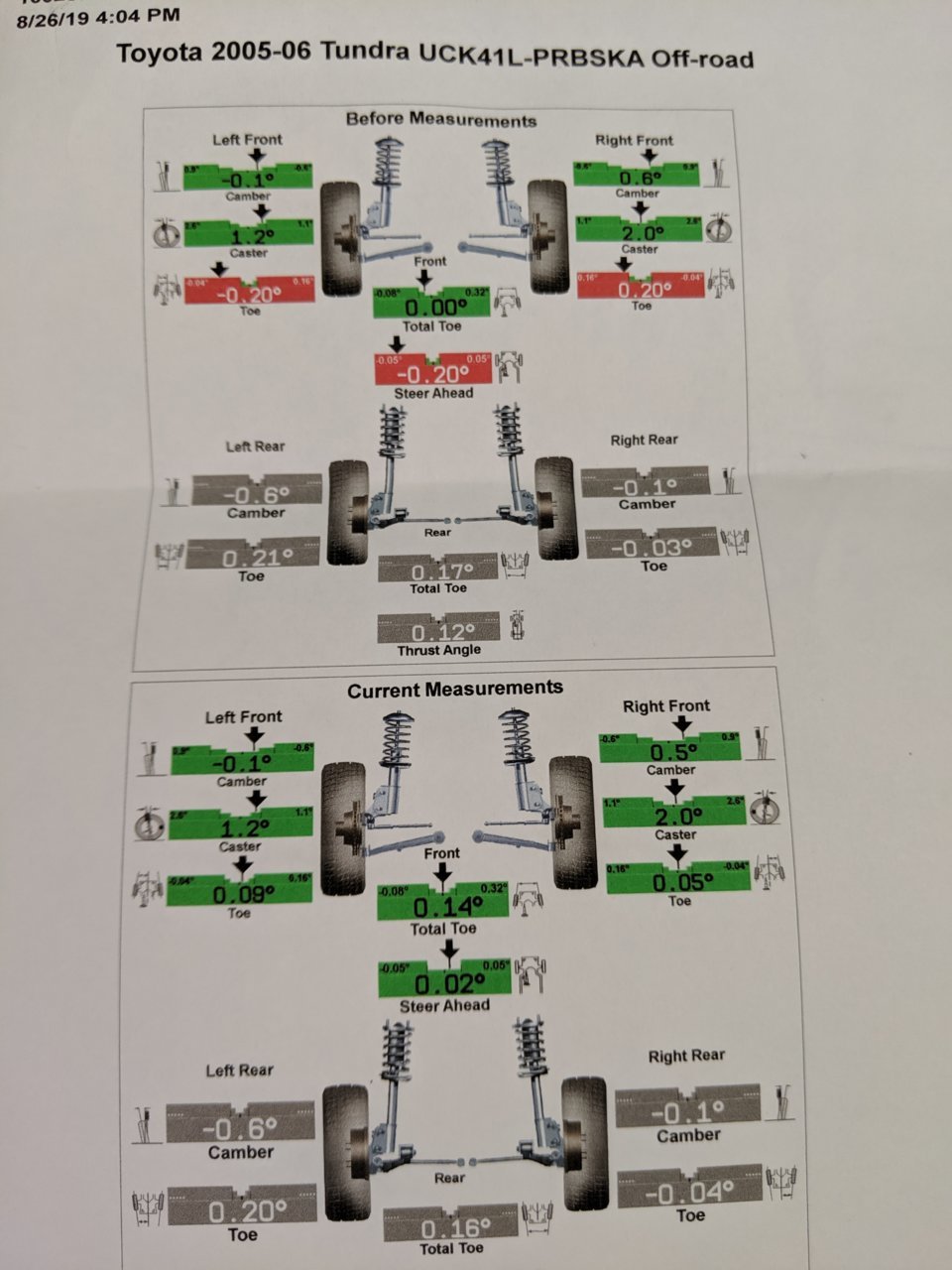

    What do y'all think of these numbers? Had it aligned after replacing lower control arm bushings. First is where we got it set manually with a level after replacing bushings

    Looks like you did pretty damn good with the level. The alignment tech practically had his work done before he started.

    You're probably right. Toe was out some probably from having the rack loose. 100 bucks is cheap insurance not to destroy new tires

    It has amazed me that these trucks run such little caster. How did you check caster yourself? I am measuring it off the upper ball joint adapter. I've seen other ways like turning the wheel xdegrees both was and subtracting each measurement, but that's hard to do with a wheel off.

    I had the cams marked so 1 side was easy. The other side (with new cams) I was up in the cab turning wheel. Had tires on. We just got it close as I was getting it aligned the next day or so
