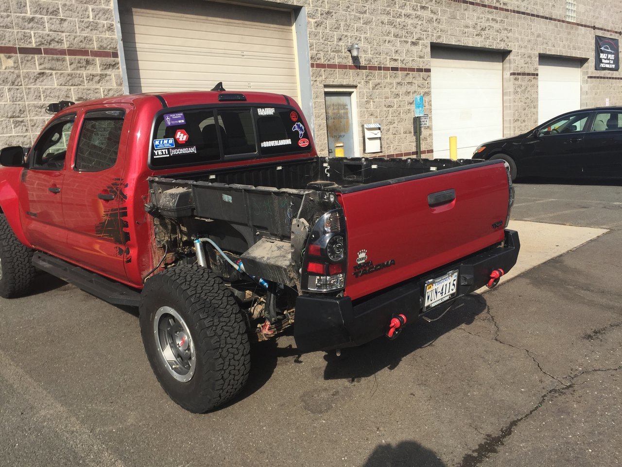

    You can search Tacoma bed flexing and read till your heart is content....it applies to the Tundra just the same....maybe more so since the bed is wider and longer. If you are not putting your truck in those situations that cause flex you are probably fine, as lots of Tacoma owners have been. If you are putting it in situations that can cause an issue then stiffeners might be the trick for you.
    I have no idea why people thought that the composite bed on the Tundra would be any different than the composite bed on the Tacoma.
    This is what the bed looks like (this is a tacoma but same thing) skin quarter panels on the out side and you can see why in some situations it needs a little help flexing.

    Ugh that looks like a condom plastic cover for the actual sheet metal, why isn't the sheet metal itself more rigidly built before throwing this over it, is my main concern
  21. May 2, 2024 at 3:20 PM
    #51
    Jaxyaks
    Jaxyaks New Member
    Jun 9, 2021
    #64091
    715
    There is no sheet metal underneath, it is a composite box.sits on frame. ..the quarter panels (outside bed panels) skin the outside of the box. Like this...the Tundra bed works the same way.
    kabar kabar and Fxclm5[QUOTED] like this.

    Wow, this indeed screams you need to reinforce your bed if your strapping things to the top of it.
    Guess me loading motorcycles 500lbs in dead center is where they design the load to be shared, down the core of the bed instead of the side rails
    Also, I remember in the late 90s using a 1/4 ratchet and like 10mm socket to unbolt a 1ton GMC dually bed and it literally was able to be folded by hand, the rust is no joke

    This is a cool skin removal! but it proves at the same time that metal was the best route to go back then, clearly topper MFG's are ignoring this is what trucks look like underneath nowdays.
