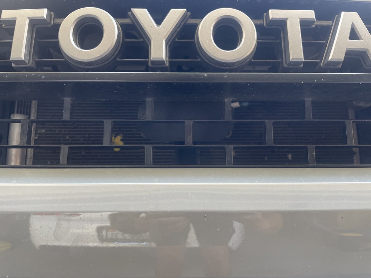

    Real quick picture taken after install of the old style pro grille and your face plate. Obviously not much to see, but that’s a good thing. It’ll get several hundred miles of testing over the next week or so.
    Tundra234[OP] likes this.

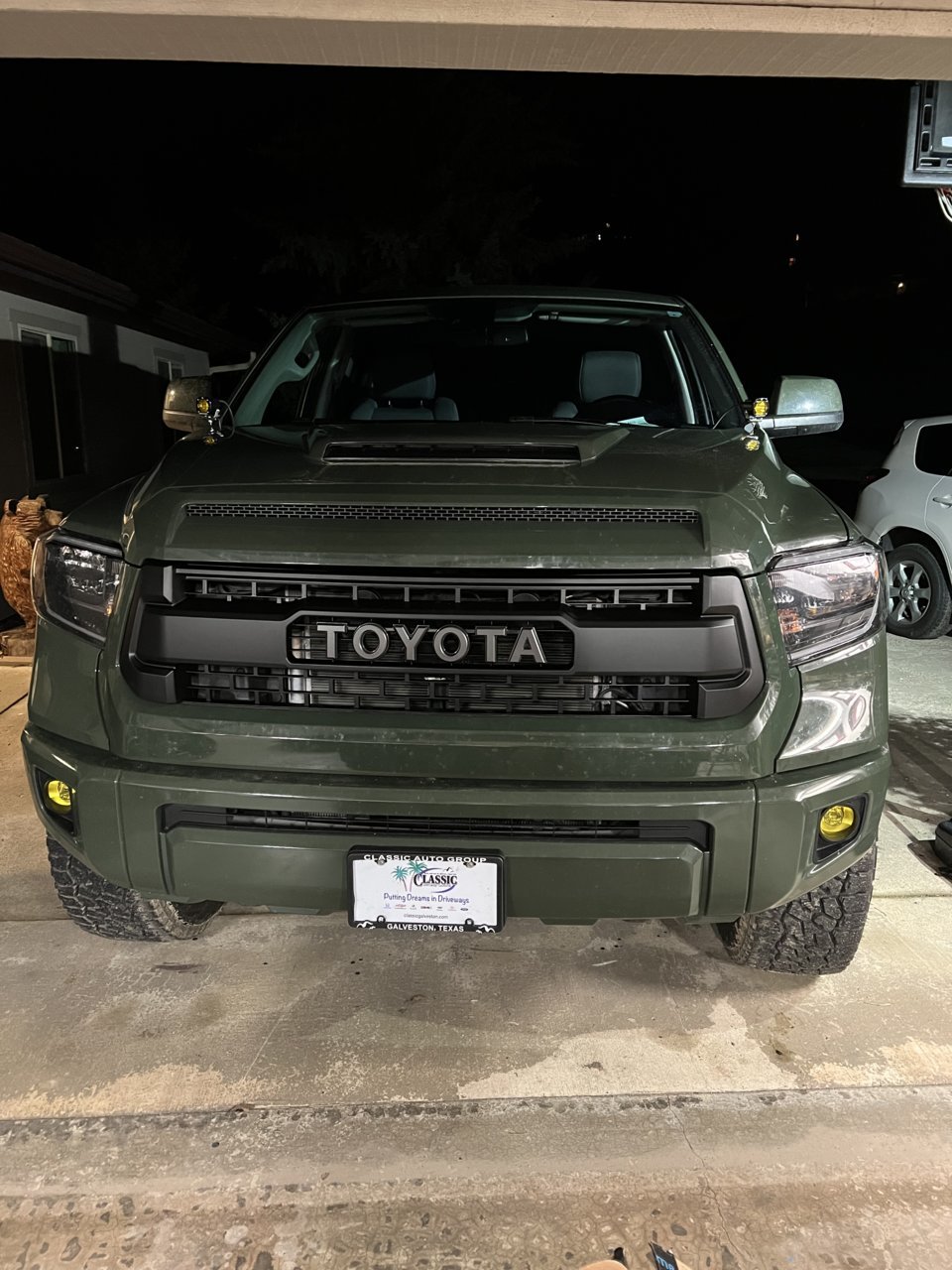

  16. Apr 10, 2023 at 11:44 AM
    #46
    Tundra234
    Tundra234 [OP] New Member
    Nov 30, 2018
    #22402
    18,456
    George
    Florida
    2020 Tundra DC SR5 Barcelona
    Alot of them
