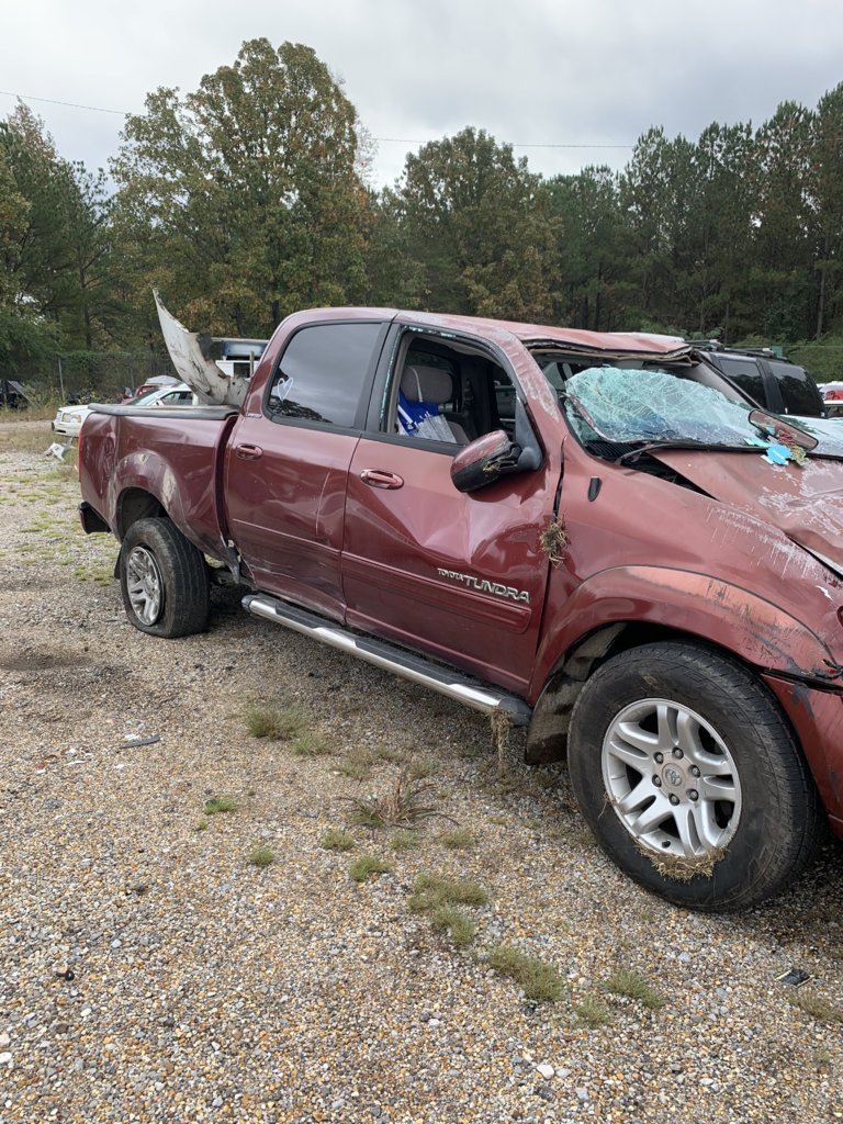

    On 11/4/24 I was in a wreck in my 2004 Toyota tundra and the airbags didn’t deploy. I’ve read on some of the threads that the gforce has to be a certain amount in order for the airbags to deploy. I flipped 6 times… I will say despite the airbag situation, I’ve never seen a truck take such a beating and stay in one piece. I got hit by a small white car that “wasn’t paying attention”… but I digress. I’m looking for another vehicle (preferably Toyota) but the airbags have me a little concerned.IMG_4494.jpg IMG_4486.jpg IMG_4492.jpg

    I have a concussion, abrasions and knots on my head, left thumb is in a soft cast, from the top of my head all the way to my toes (no exaggeration) is covered in cuts and bruises. I’m alive thank God but that’s a ride I’ll never forget.

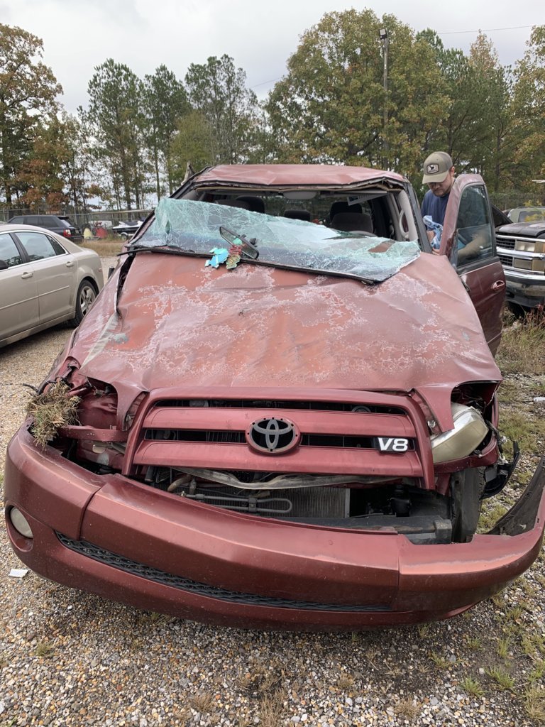

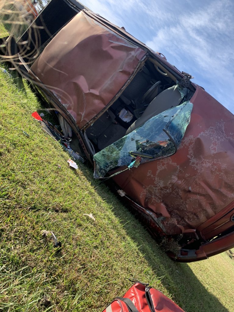

    @Upshot Knothole rear passenger door you can kinda see the white marks in the dents at the bottom. I was told when he hit me my back tire went over his hood, I slid on my side and roof then flipped 6 times off into a ditch. I truly can’t believe the truck is still in one piece.

    I don't think the 2004 had side curtain airbags. The frontal bags would not have gone off with a roll that didn't have the right angle of frontal impact. It isn't the amount of force, but the angle of said force.
    Your seat belt pre-tensioners should have activated and yanked you into the seat.

    I looked it up, side curtains were optional starting in 2005, DC only. Have to agree, without any significant frontal impact, the airbags shouldn't have gone off, but the seat belts should have.

    Generally steering wheel and dash airbags will not deploy unless the airbag control module senses a negative accel/change of speed in the longitudinal axis. Lateral Accel and Roll Angle will deploy side curtian airbags if you have them.
    I have seen alot of rear impact wrecks where the drive is pushed back into the seat. The wheel airbag never goes off as it wouldn't help anything, your body is accelerating in the opposite direction. .

    This is a rollover. The lack of damage to your front bumper would indicate minimal decelerative force in the X-axis. Airbags probably are working as designed.
