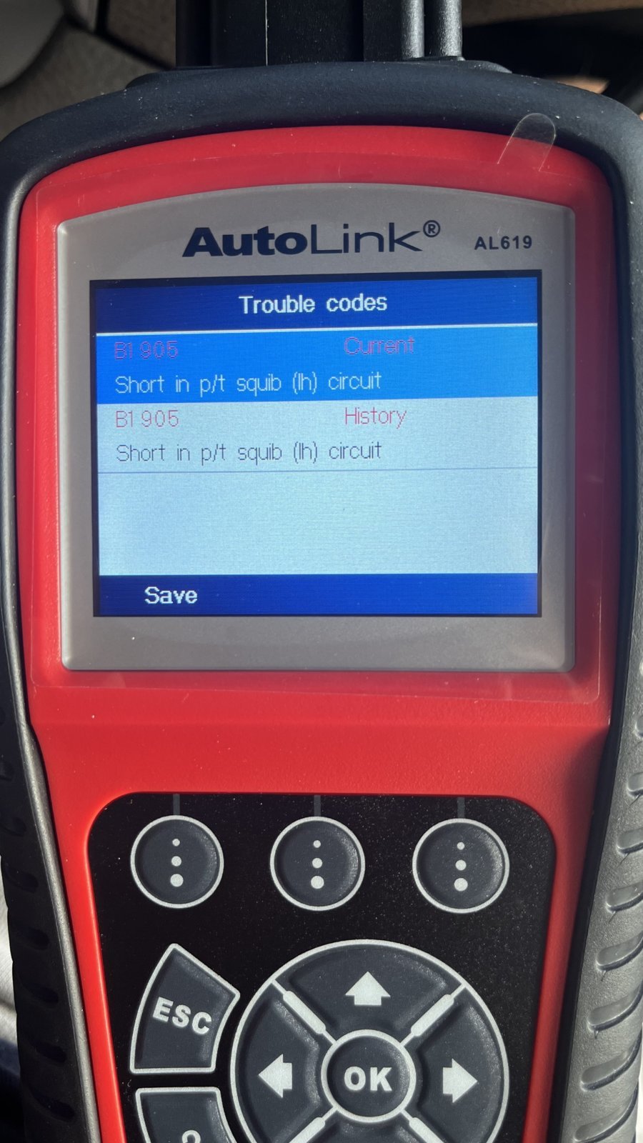

    I have been looking everywhere for a fix to my airbag code. I only have the code b1 905 and I wanted to know if anyone out there has had this problem and knows the solution. Anything helps thank you!

    Has the truck ever been in an accident ?

    yes it has, idk anythuing about the accident all ik is that its a salvage title that I'm trying to fix up

    That code is for the passenger side seat, seatbelt, seatbelt retractor area I believe. Try checking all the airbag connections under the seat and on the door.
    im guessing it’s the seatbelt retractor was never replaced or fix after the accident

    Thanks for the info. Let me go check it out when I can. Btw where did u go to see the codes and what the problem/solution is?

    Just googled B1905 Toyota, you might have been looking up B1(space)905
