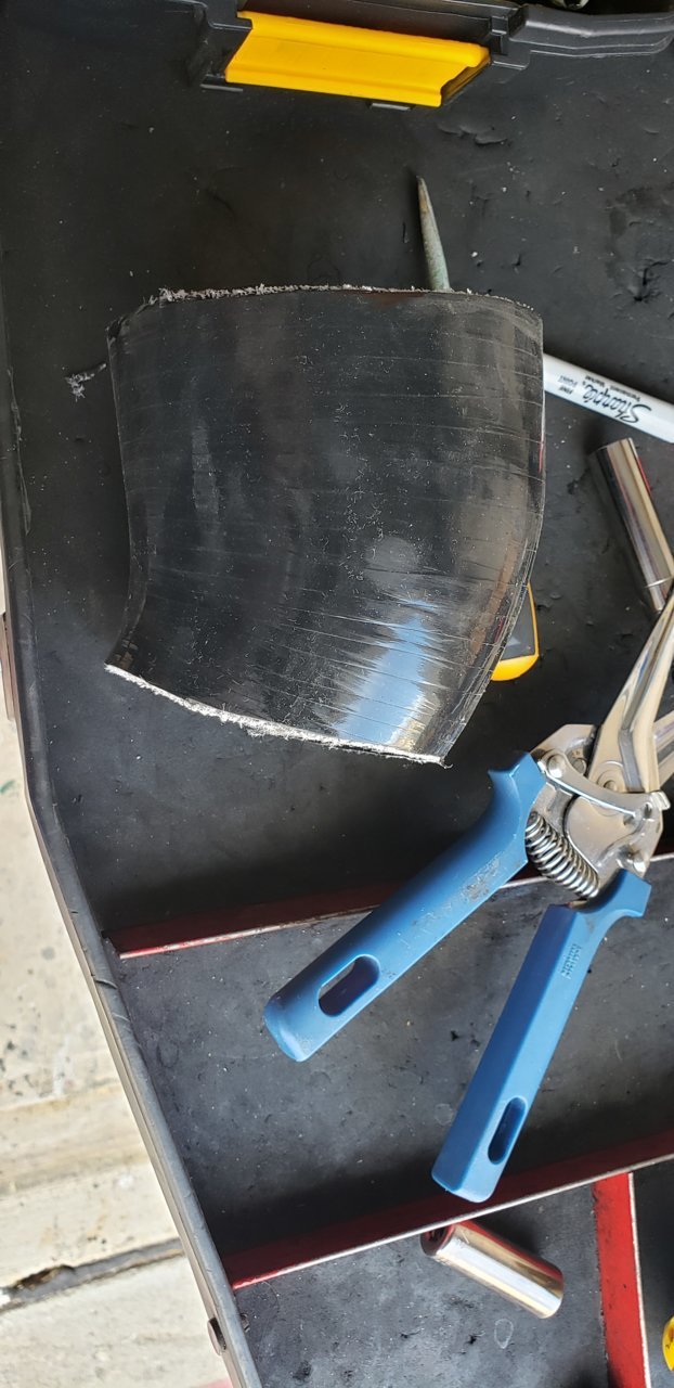

    Try #2: trimmed down reducer; 4" to 3" Inch 45 Degree Coupler Elbow Black Silicone Reducer Coupler Turbo Intake Pipe Black https://www.amazon.com/dp/B09CD7RLMV
    $17.55
    Airbox side coupler; Ucreative 4'' Length Hump Black Silicone High Temperature 4-ply Reinforced Straight Hump Coupler Hose (4.0" (102mm)) https://www.amazon.com/dp/B08YZ2VVK9
    $14.99
    TRD Tube= $40.86
    Total: $73.40 into this project.
