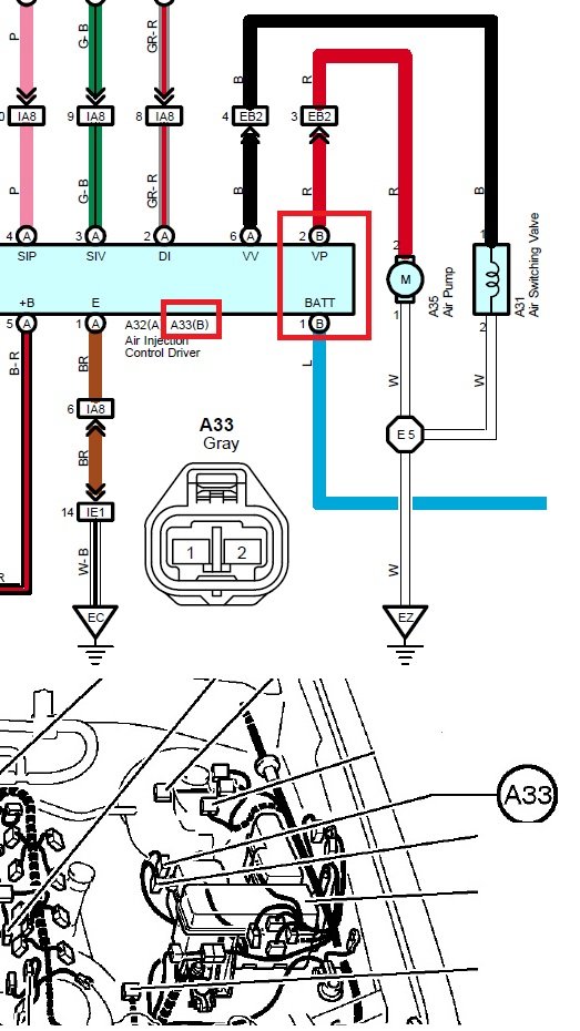

    If still around, my suggestion(as a green horn on SAIS) would be to unplug the gray plug A33 by the fuse boxes underhood that feeds the air pump. If check engine light is on, see what the codes are and report back....possibly P2445 Pump Stuck On.
