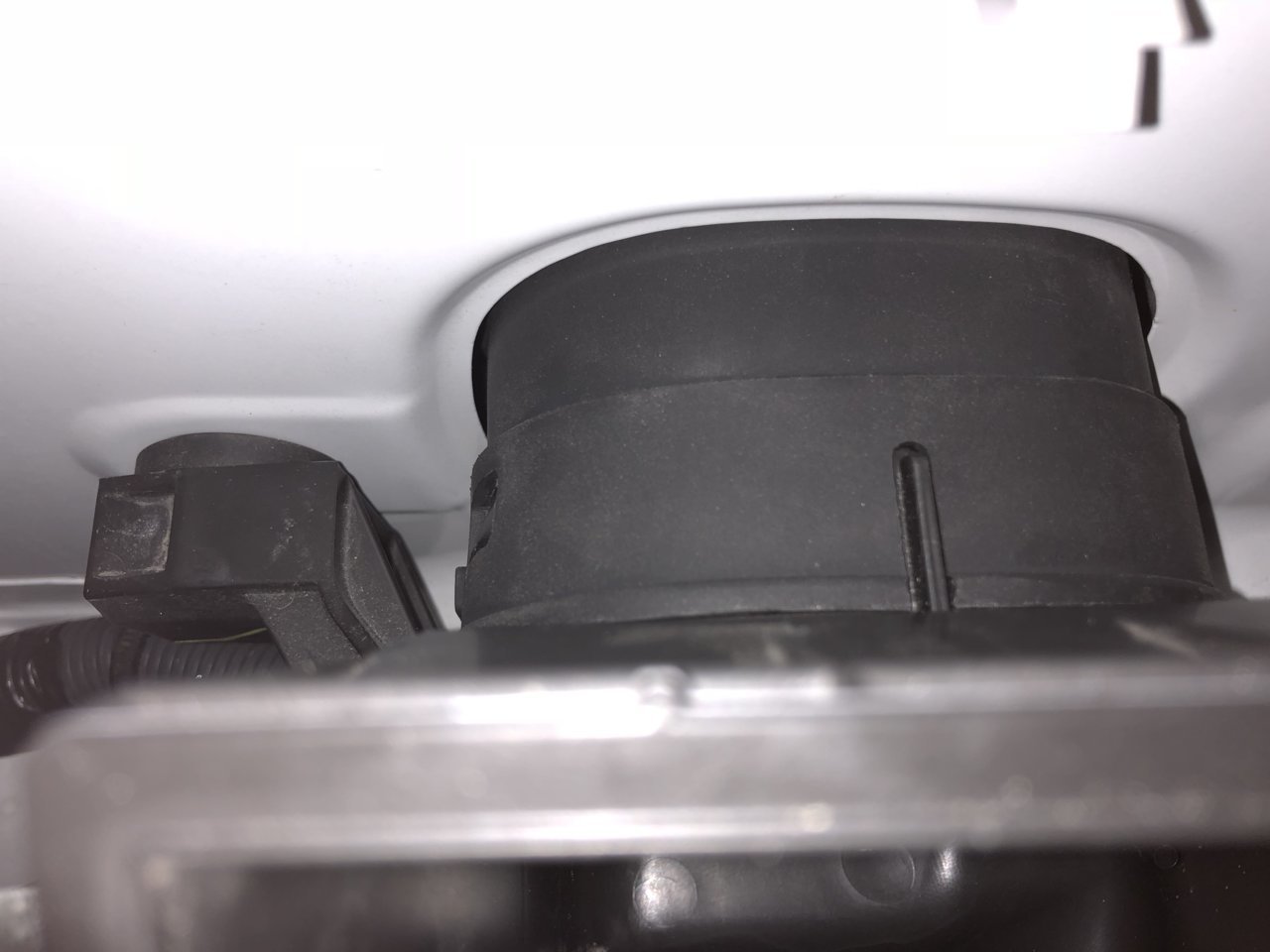

    Tried to install mine but ran into a fitment issue (user error?).
    If the air flow accelerator is seated then the air box will not seat properly and - vice versa.
    Help/thoughts?

    Bottom photo is correct. Raised portion goes through the opening. I know it’s not a perfect seal from the engine bay but it doesn’t matter.

    @PATTEN - thanks for the reply and picture.
    @Skippy - I also installed the aFe filter. By saying it fits good, does it fit like the bottom picture in my post and like patten’s? Thanks.

    bottom is the correct fitment
