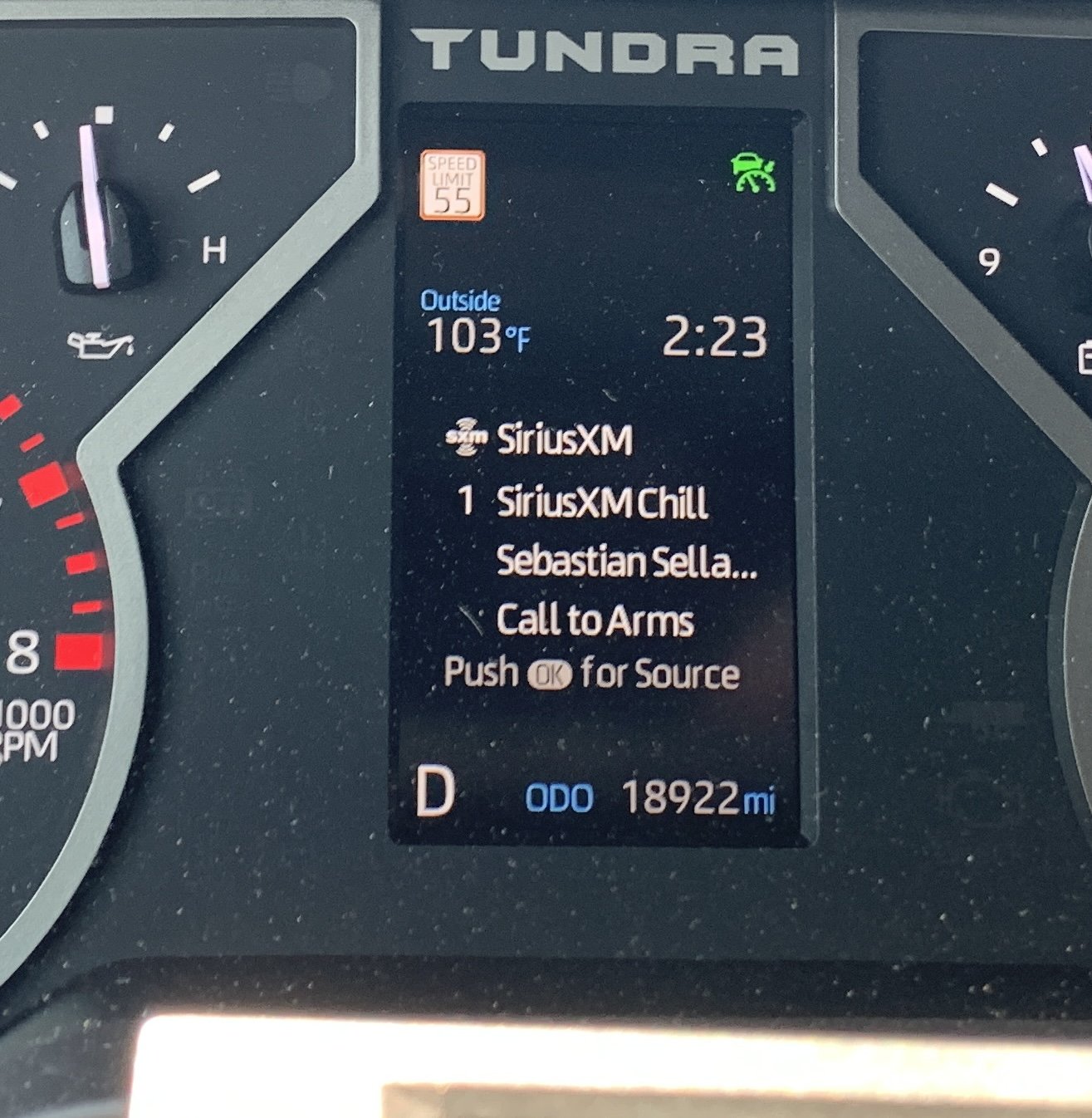

    Tundra A/C working fine and keeping me cool in this absurd heat wave. This from yesterday and not just starting out but after 10 miles of driving. I can't say the same thing for my home A/C which died about 4 days ago. I have a new condenser and coil coming freight today and will install them this evening or tomorrow.
