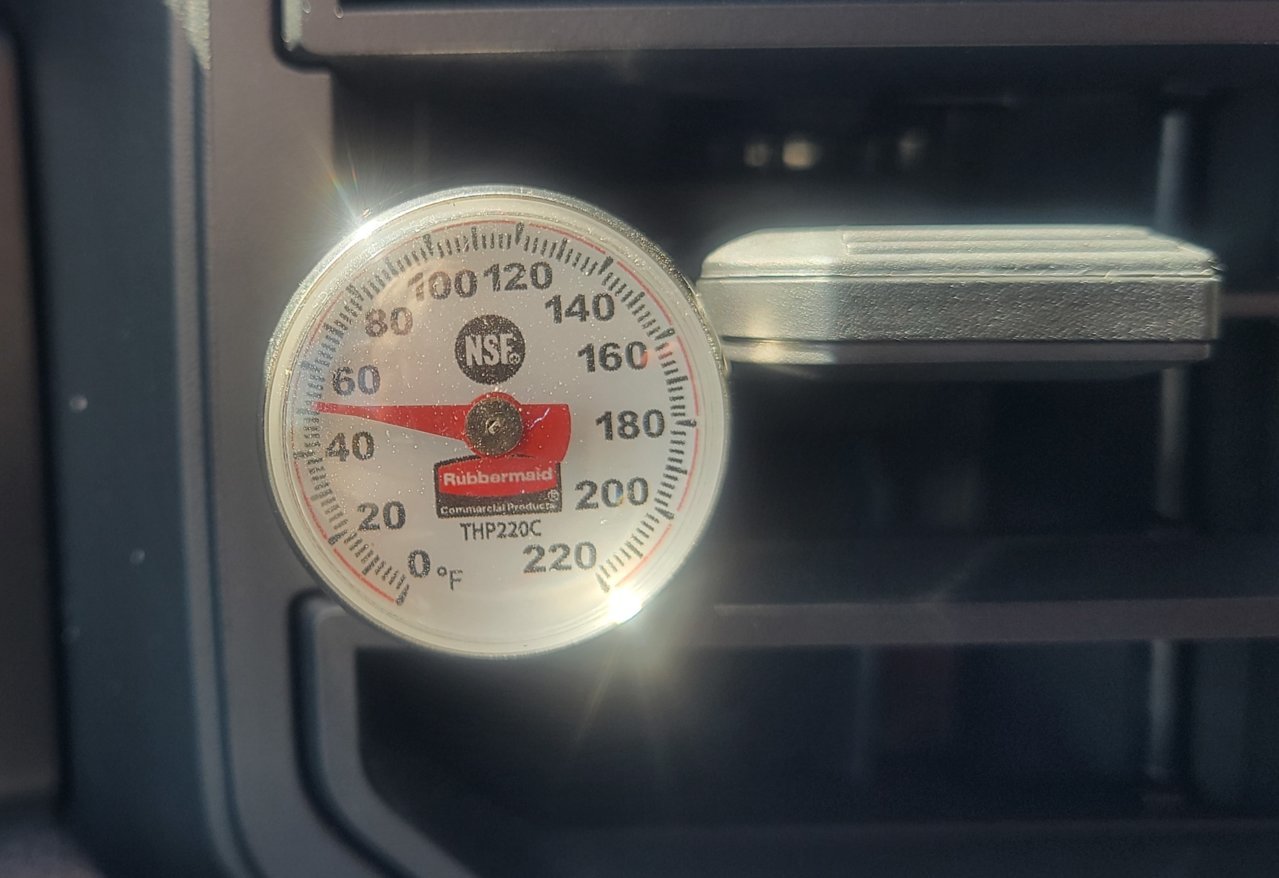

    Easiest way is to take a meat thermometer and stick it in the center vent at idle with the air set on 68-70 degrees. The temperature of the air coming out of the vent should be 35-40 degrees lower than the outside temperature. So if it's 90 degrees outside the air coming out of the vent should be in the low to mid 50's.
    Tomnola and LayK[QUOTED] like this.

    I just did the -2 ac +2 ambient change and it made a HUGE difference for me. 100 here today and I was able to get COLD vs barely comfortable before.
  29. Jun 26, 2024 at 1:36 PM
    #119
    BlackNBlu
    BlackNBlu Justa Member
    Dec 27, 2023
    #109152
    963
    Rich
    MN
    24 Limited CM 5.5 Blueprint TRD OR
    5100's, 285/75/18, Air Lift bags, bits and bobs
    (U/L by me) This is where I am at AFTER -2C Carista change. And it's only mid-80's here.... Once I bring it up a few degrees from LO, 62/64 or so, and fan speed down one notch from full, it just doesn't seem to blow very cold. No way it will keep up once we get some real heat/humidity.
