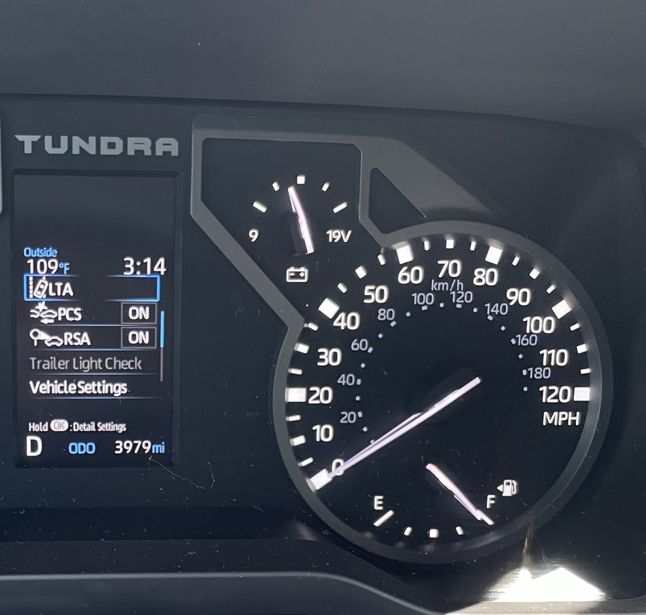

    Not bragging but maybe providing a frame of reference.
    This was the temp today (one of the hottest cities in USA) when I arrived to get in a 1/2 hour drive thru wait.
    Before leaving, temp was hotter. Engine coolant temp was same as when cruising and the A/C was very cold (we had to lower it to the 3rd lowest vent setting).
