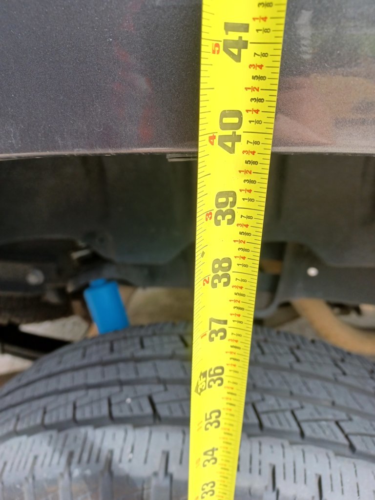

    Sorry I didn't answer your question. I am using stock tires and fender measure is 38 3/4". I also compared the shackles to OEM specs and they match. 4 inches from center to center.

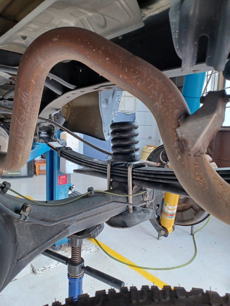

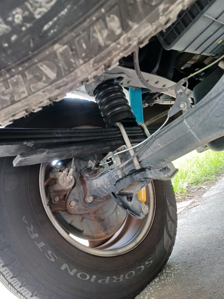

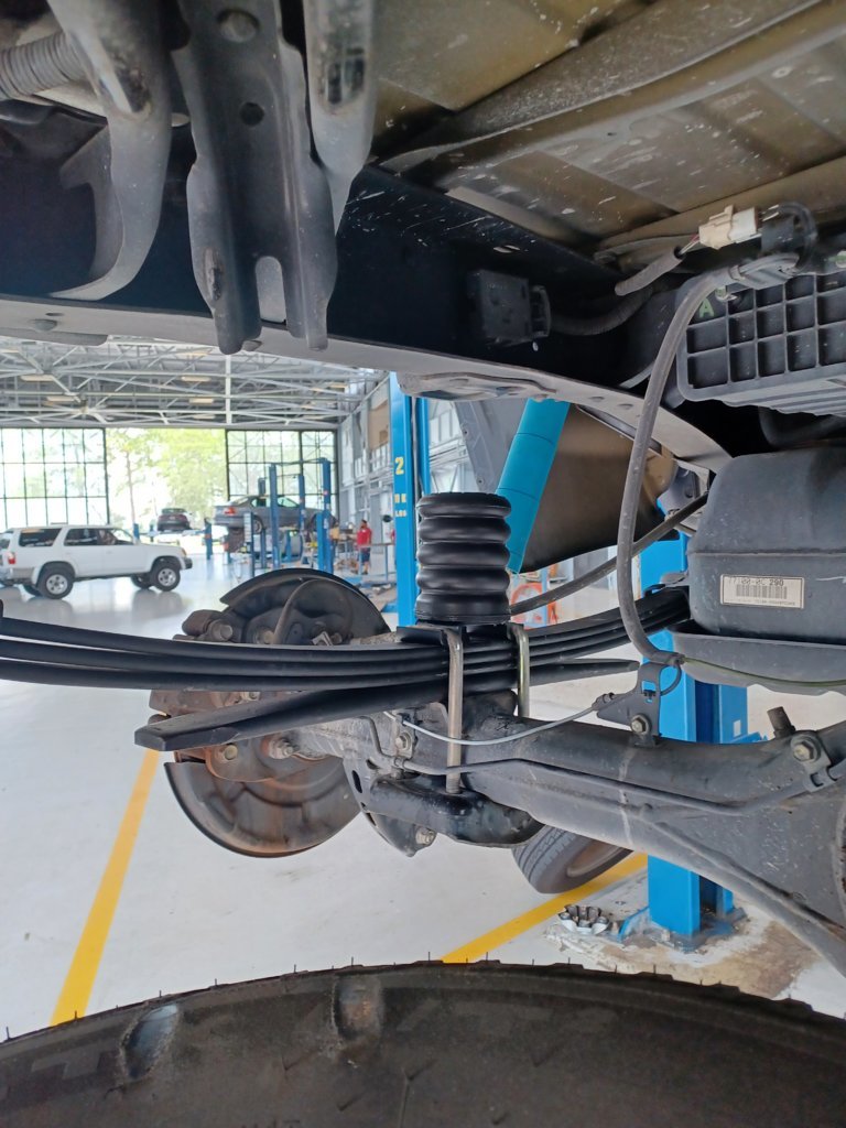

    FINAL UPDATE (I hope) - Spent about 4 hours today, which included many breaks, and got the new ATS leaf springs and black SUMO's put in. I bought a new set of Dorman u-bolts but whomever did the bend on them must have been having a bad day. Two issues with them. The bends were too close together and the horizontal part of the bolt would not rest flat on the SUMO base plate. This plus the length was about a half inch shorter left the bolts too short once the saddle was put in place. Add to that problem the SUMO base plate is twice as thick as the Timbrens. So out with the new and in with the old. I still don't have a warm and fuzzy feeling about reusing the u-bolts so I'll either pay a visit to the dealer or have some made locally. I am now sitting at 39 3/4' height so I got a nice little boost. Enough to where I'll have to re-aim the headlights probably. But it rides 1000% better!!!
    Other areas I feel compelled to share;
    1. Not sure about other years but the springs are different, left and right. ATS marked mine but I come to find out that they are different front to back too. About 5/8" longer when measured from the center stack bolt to the center of eye. Bob at ATS was a big help in getting me straight on the spring orientation.
    2. You will thank yourself if you drop the spare tire! Makes getting the shackle out much easier.
    3. The torque specs I found online were:
    a. U-bolt 90 ft lbs
    b. Leaf spring eye bolt 115 ft lbs
    c. Shackle 67 ft lbs
    d. Steel wheel lug nut 154 ft lbs
    Thanks again for all the advice! :cheers:
    blenton and joseph_womack like this.
