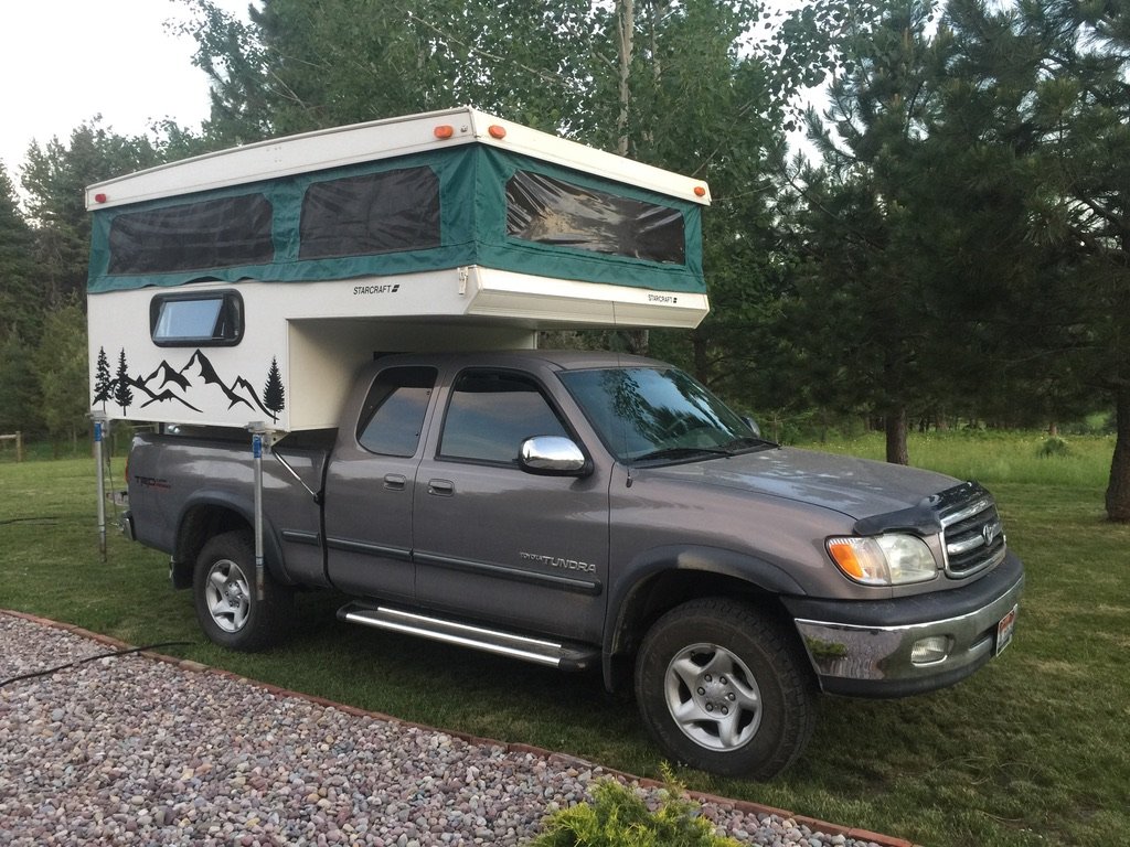

    Well I finally made it back with the camper and got to test the airbags out. Here she is all loaded.
