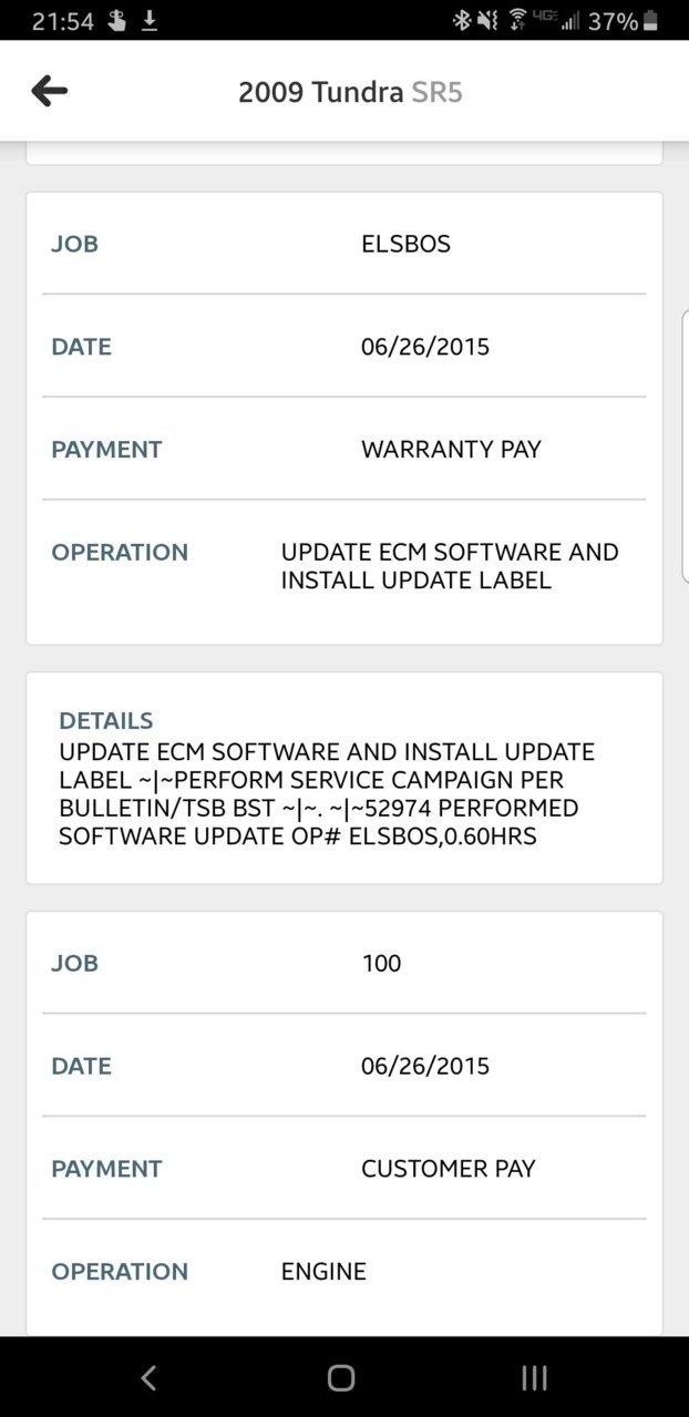

    Currently my truck is running great. But, reading through the thread, it would seem if the dealer flashed the ECU, I cannot do the DIY fix. Is that correct? And, if so, does this entry mean I could be hosed if trouble begins with the AIP?
    Cheers!

    Nope. The reflash makes the pumps cycle at random times. This will cause you to get codes when a system check is run.
    The bypass can't be used.
