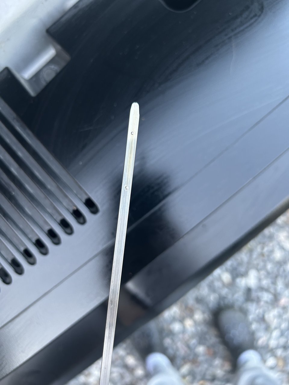

    The procedure usually calls for a warm engine that has sit 5 or more minutes to check the oil. If you’re checking a cold engine, you’re not getting the intended reading.

    Yes it was a cold engine........I will check again when I get home. Thanks

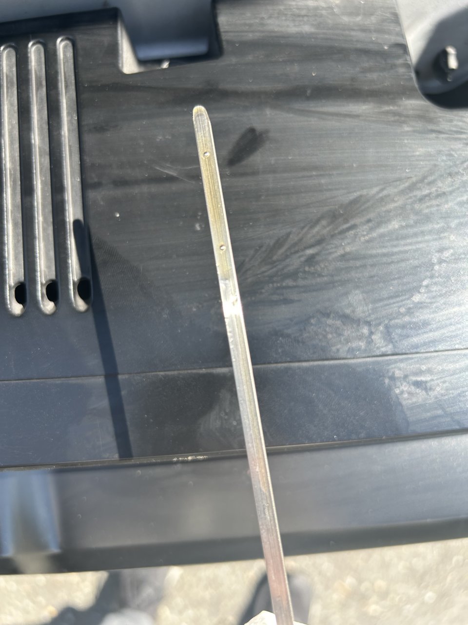

    got home and started the truck; let it sit for 15 minutes and rechecked. Still reading above the second dimple; removed a half a quart from the fumoto valve. Repeated process and it’s right at the second dimple now ;hard to see from the picture). Next time this will not be such an adventure

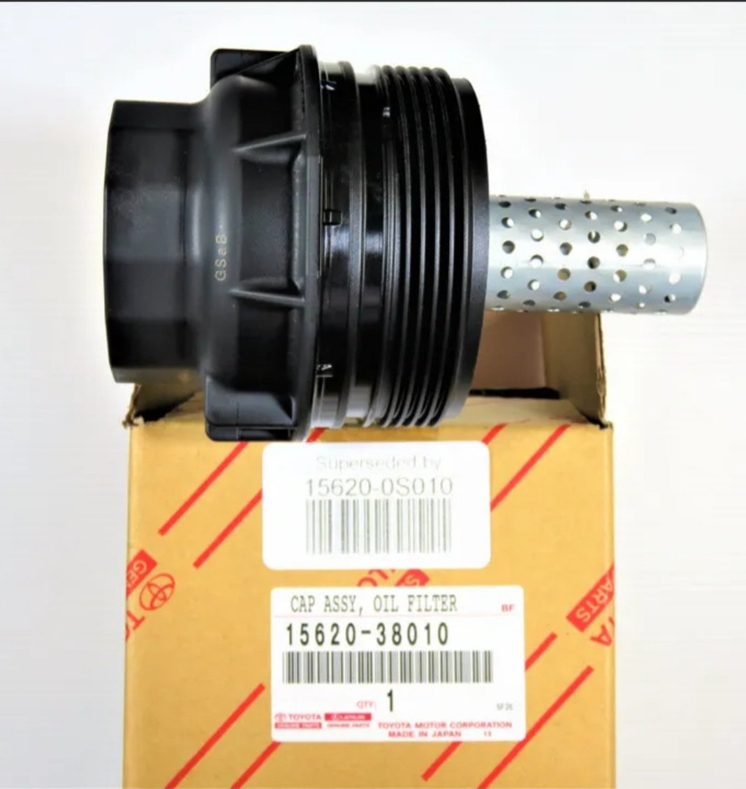

    One thing i was able to find was a Lexus 4.6 which is is a 1UR that used this part number 1562031040 for the filter cap which appears to maybe have the longer tube in it. Not the same as the 3UR but similar, I'm curious if this one at least uses the correct tube length.
    Edit: After looking at photos of the Tundra cap I dont think the Lexus one would be long enough. Photos attached

    Old thread, but I purchased the 15650 part number and it has a little lock/retaining clip on it that prevents the housing from screwing on, 2021 Tundra w/ tow package in this case so maybe it has an oil cooler? Toyota parts website says the 15650 part is for non tow package. 15620 is for tow package with oil cooler. 15650 fits on a tow package equipped tundra if you slide off the clip, but I’m not sure what else might be different about that housing specific to a non-tow package (no oil cooler) tundra.

    Interesting, looking at the photo you can actually make out a clip on the side now that I look closer.

    right, and I don’t know if the filter itself will actually function the same as the 15620 part? Oil bypass function, etc? Clip was removed to install it so it would fit on. The clip just slides off.
