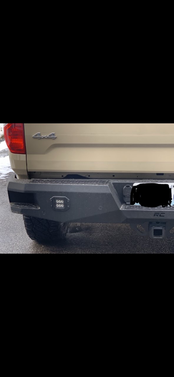

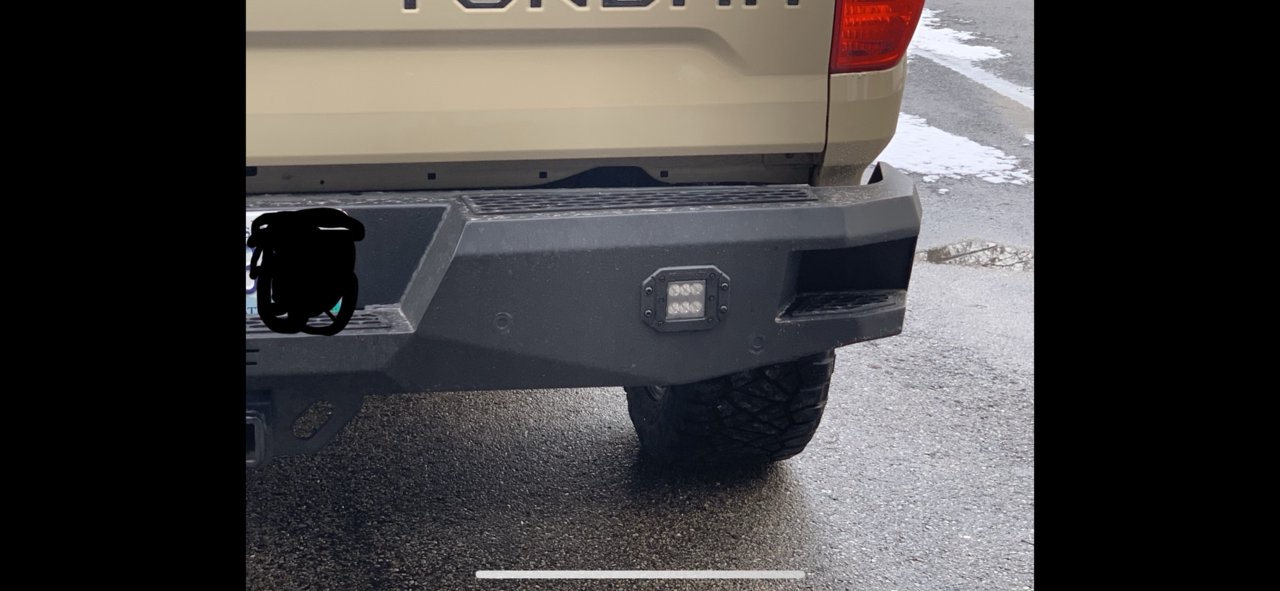

    I installed a Rough Country rear bumper. I like the bumper itself, but how it fits isn't that great. I hate how much space is showing between the rear bumper and tailgate. It looks awful. Has anyone come across anything like this? If so if anyone can point me in the right direction. I don't think this bumper can go up or in any further. Not sure if they sell anything to cover up the underneath part so that gap isn't so noticeable. Thanks!IMG_3784.jpgIMG_3785.jpgIMG_3787.jpg

    Damn. That sucks. I was thinking of getting that bumper some day. Maybe take it off and paint the gap black so it's less noticeable. Otherwise, it looks good.

    The side profile looks off too. Hard to be sure from those angles though.

    It looks great over-all, not a game changer; it's just more noticeable because you have a light colored truck.
    I wouldn't obsess about it.
    Some people have made a filler piece. Others used a light kit. I think some painted it black [on the black truck, it's not noticeable.]
    Nice bumper, enjoy it!

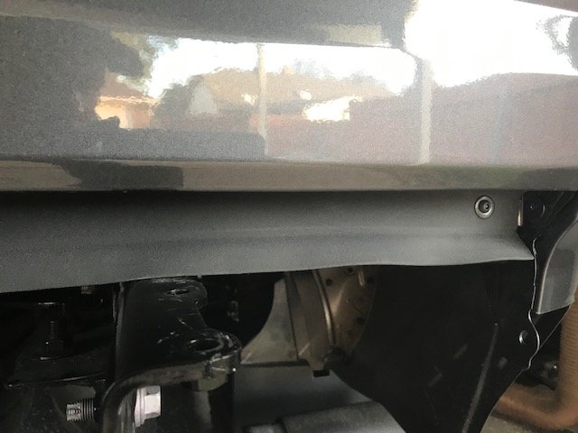

    I'm installing this bumper tomorrow and came up with a quick fix to fill the gap. I bought some garage door seal and bolts at Lowes. There are 4 threaded holes below the tailgate ( M6-1.00 ) that I used to mount it. I'm not sure if this will be a permanent fix. I'll probably decide once I see it with the bumper on.IMG_1070.jpg

    Good looking fix, only thing I would suggest is maybe cutting out acces to your spare tire lift

    So I installed the garage door liner option mentioned in the previous posts. I like it. There are only 4 existing bolt holes so I used 4 self tappers with washers to further secure it. Looks better than before imo. The spare tire access slot isn't necessary for me as I do not have a tire there.

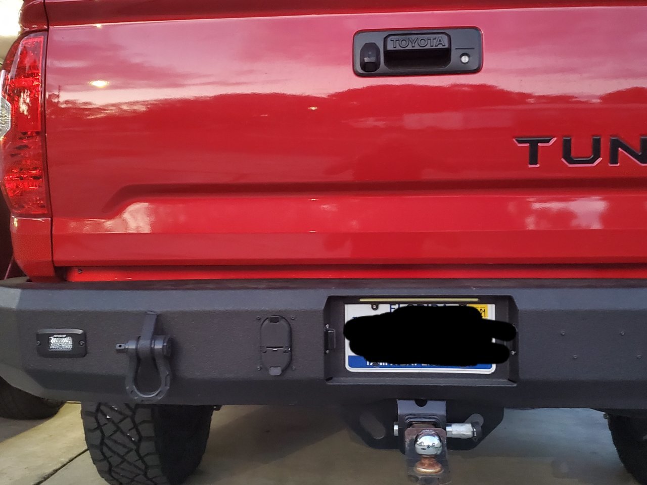

    I have a different rear bumper but I used aluminum on mine. I have the RC front bumper...here's mine.
