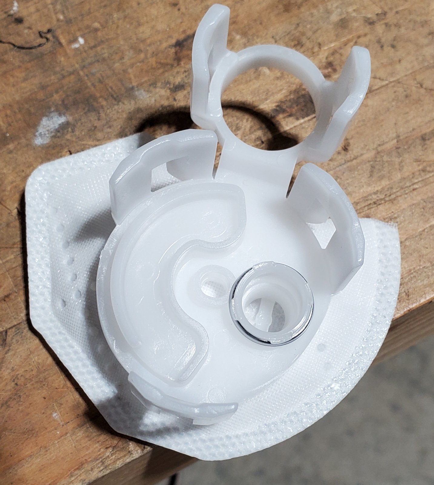

    The Deatswerks DW300 is the best plug and play pump for the flex fuel. I would use an internal 100 micron filter as fuel contamination will ruin the pump and shorten its life.
    You can use these filters. They fit on the bottom. They do need to be trimmed of the excess plastic. I just wrapped the filter in painters tape and used a dremel to carefully cut away the excess.
    I'm not flex fuel but adapted the FFV canister for my fuel system.

    Regular blue painters tape? Gas won't eat it up?

    The tape is to cover the filter media while you shape and remove the excess plastic from the filter. You remove it when you're done. This is the closest option as Toyota or Denso don't sell a filter for the pumps. Ones provided by walbro etc are too large.

    Understand Now. So you are just covering the filter with the tape to keep the ground up plastic out of the filter

    Yes
