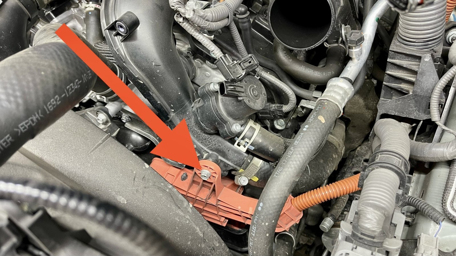

    Just watched this video on youtube, Any issues installing? On their site it says excluding hybrid so i strayed away. Youve got me double guessing though

    Wasn’t the easiest install I’ve ever done but not too bad…if ya follow the video step by step it’s pretty straightforward…just have to be patient with aligning the couplers…they will definitely work with hybrids, I show the difference and why they say it won’t at one point in the video…just has to do with that orange bundle of wiring, no biggie…hope that helps!

    oh right on, that was that clip in the back right? and thanks for the reply!

    No prob, happy to help!…it’s this bolt pictured here…the new pipes don’t have that threaded insert for the bolt, so I used a thick zip tie to secure it…rock solid, won’t go anywhere
