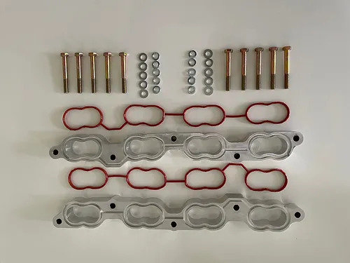

    So I wanted to wait a little bit before I made a formal review thread for the AES Intake Manifold Runner Kit for the 5.7L V8. For reference, my truck is a 2016 1794 4x4 with some performance mods already installed. Some performance mods already include:
    • DAP Tune
    • Modded TRD Exhaust w/ H-Pipe and Dual Helmholtz Resonators
    • ARH 1-3/4" Long Tube Headers w/ 3" Catted Midpipes
    • TRD Intake
    • Gigs Performance Ported Throttle Body
    All in all, these above mods made for a fun, good, well-rounded daily driver. The exhaust was tame at idle and around city driving, but sounded wild at full throttle. No performance issues whatsoever for a naturally-aspired build - or at least so I thought.
    I read up on some reviews of the AES intake manifold kits used on some of the 3.5L V6 Tacoma builds, saying how it helped when going to larger tires and helping to build low-end torque. The more I started thinking about it, I did notice that when I put the long tube headers on, I did lose some low-end torque - hence the need to add a custom H-pipe to help with scavenging and reduce some weird resonance with the long tubes at around 1900 RPM (the Helmholtz resonators helped with drone at around 1600-1800 RPM cruising around 60-70 MPH. So whenever AES announced the open pre-order for the 5.7L kit, I decided to try it out - figured it couldn't hurt so why not?

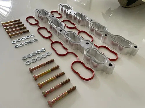

    So full disclosure, these aren't actually pictures of the parts I received... I was too pumped to get them on the truck, I completely forgot - whoops. But, the kit is exactly as pictured - came with (2) manifold spacers machined out of billet aluminum, (2) new intake manifold gaskets, and (10) associated longer bolts along with flat and lock washers. Really, no complaints with the quality of the parts - fitment was great. The only thing to note was the lack of installation instructions - but luckily, install was not too difficult (if you can change spark plugs, you can do this).

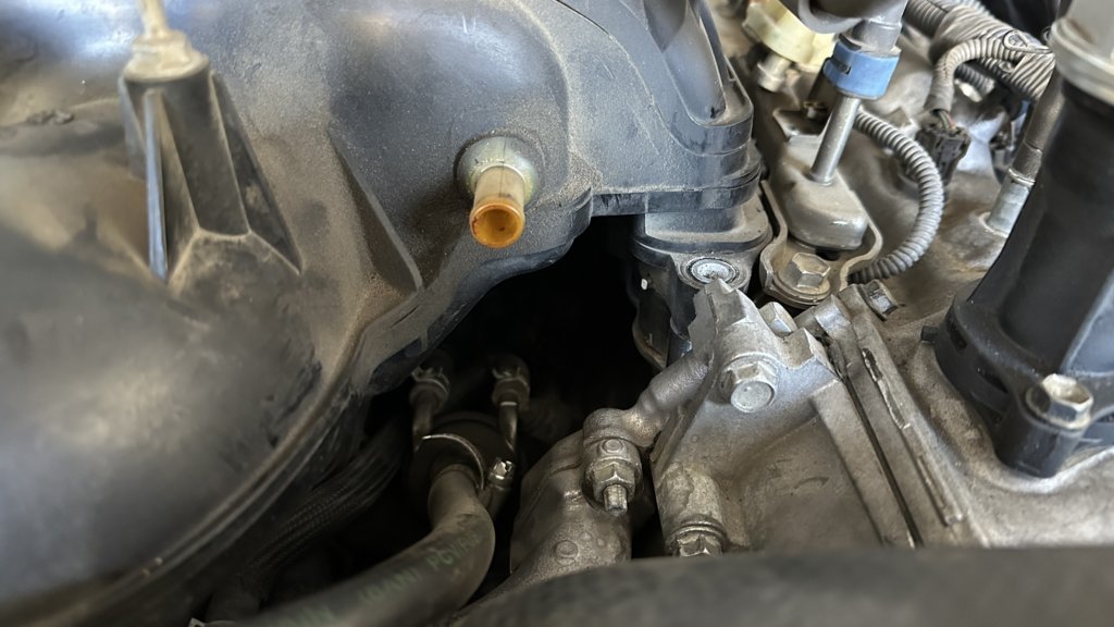

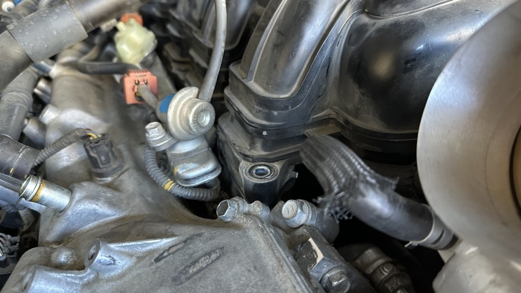

    I'll outline some steps for the install as I remember, but again, use this as a guide at your own risk.
    NOTE: I did not disconnect the battery before attempting installation, but this would be a good first step. And also make sure the area is CLEAN. Might as well install the included gaskets into the manifold spacers as well at this time before starting disassembly.
    1. Remove engine cover and set aside.
    2. Disassemble and remove intake air box and tube from throttle body (disconnect MAF sensor, PCV hose, and vacuum hose).
    3. Disconnect electrical connector from throttle body.
    4. Disconnect brake booster line at back of intake manifold.
    5. Disconnect PCV vent hoses leading to each valve cover.
    6. Disconnect two electrical connectors and hose from driver's side of intake manifold.
    7. Remove (8) bolts and (2) nuts securing down the intake manifold (at this point, be careful to not drop anything into the exposed ports.
    8. Remove (1) 10mm bolt holding the wiring loom to the intake manifold located at the back of the passenger side.
    9. Remove PCV hose located at the front of the intake manifold (I have a Radium catch can system installed, but principle should be the same for stock).
    10. At this point, the intake manifold should be able to be lifted up from the front.
    11. I did not obligate to completely remove the intake manifold in order to install the manifold spacers. If you do decide to remove the intake manifold, there are an additional 2 clips at the very back that hold onto the wiring loom (major PITA to remove these). It is not necessary to remove the intake manifold from what I've seen.
    12. Lifting the intake manifold up in the front, slide in each bank's manifold spacer (these only go in one way, so make sure everything lines up correctly). There are two studs at the front of the intake manifold that helped secure the intake manifold down - I used these to line up the manifold spacers (NOTE: these are too short and will need to be removed).
    13. After both sides are lined up front-to-back and side-to-side, lift up one bank's manifold spacer at a time to remove the aforementioned stud. I used a set of channel-locks to break them loose and a 6mm socket to turn them all the way out.
    14. After stud removal, line everything back up and use the included hardware to bolt the intake manifold down, making sure the spacers are correctly lined up with all the ports.
    15. Torque everything down and reconnect everything else, and you're done!
    I attached the finished pictures below, but honestly, you can't really tell there's anything there unless someone told you where to look. Very inconspicuous and low-key.

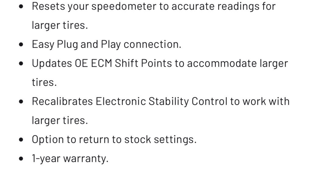

    Wait. I thought this device only modifies the ODO/Speed?

    It does, but it also fixed some of the odd shifting from the transmission due to the speed difference. When I put the 34’s on, at certain speeds, the truck would somewhat hesitate and not know exactly what gear to be in (upshifting or downshifting sporadically). This fixed that issue as well as the speed accuracy.

    I am skeptical it does anything for the transmission shifting since the device only intercepts signals going to the ODO/Speed and the dash isn't transmitting speed data.
    None of the signals going to the ECU or transmission from the wheel sensors are intercepted with this device.
    https://s3.amazonaws.com/roughcountry/install/919001700.pdf

    I was skeptical as well when I first put the tires on - but I figured I could buy it on Amazon with a hassle-free return if I didn’t think it was worth it. Ended up keeping it since it made the truck drive and shift like it did before.

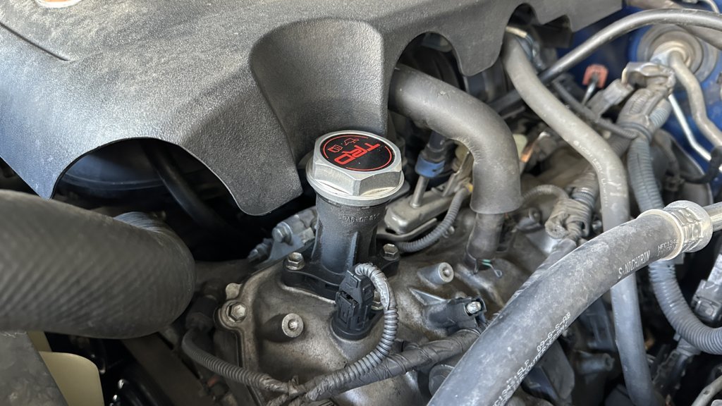

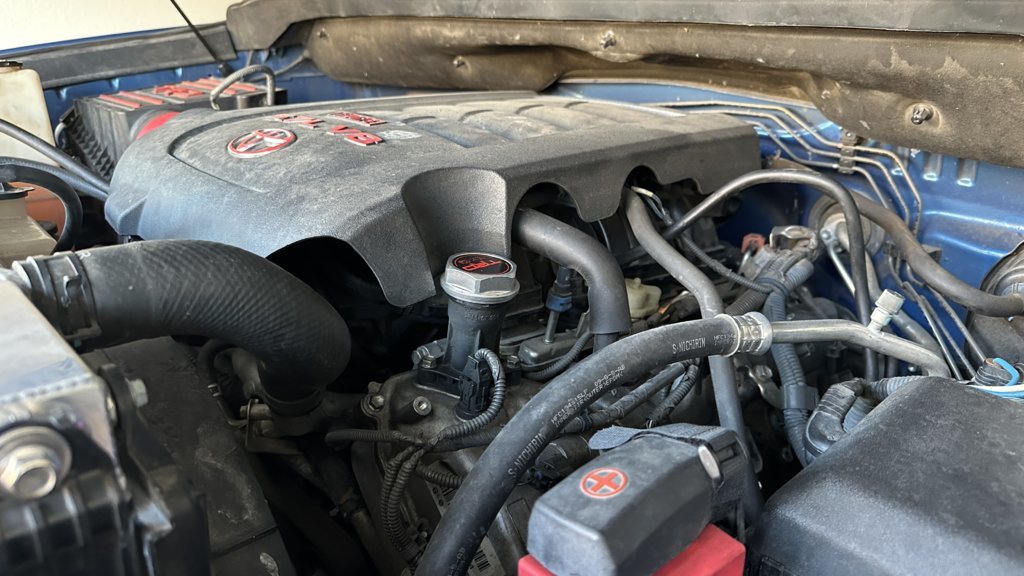

    So on the hunt for a picture of the PCV location, I stumbled upon this thread. Anyone else try these yet?

    PCV on my 2018 is to the right of the TB. Remove the foam insulation, and there’s a hose going to it behind where the TB is.
