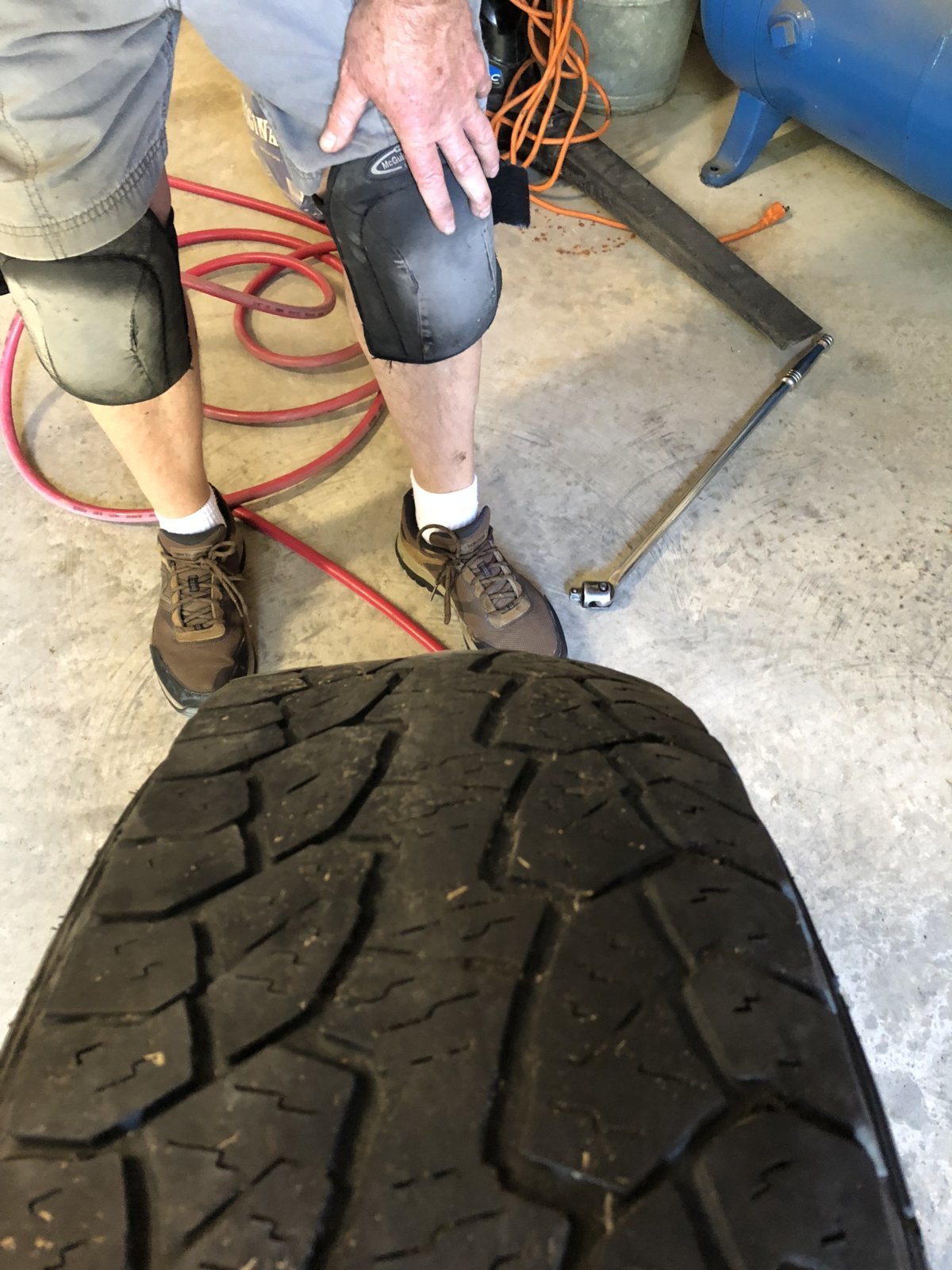

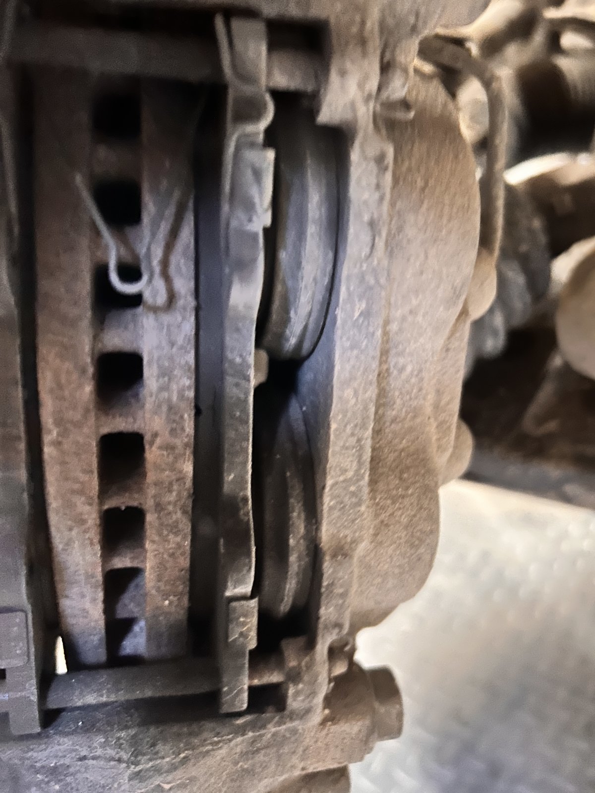

    Finally back to update the thread. Took me a while to get around to pulling the tire. It seems that @KNABORES was right regarding the caliper. The brake pads on the passenger side (the direction in which the truck is pulling) were worn completely unevenly. With one pad almost gone and the other almost full thickness. I could, however, rotate the wheel freely and the rotor freely by hand so it wasn't as thought the caliper was jammed up.
    I'm planning to replace the rotors and pads, and am trying to figure out if I need to replace the caliper as well. Obviously there's something that's not working properly there, but I was hoping the group could chime in on what the potential causes are too look for. Bent pin? Something with the brake fluid? The caliper isn't rusted and appeared to be in decent shape.
    I had read that the parking brake can affect the entire braking system, and currently my parking brake needs to be adjusted as that it doesn't stop the truck.
    @shifty` I did test the lower ball joint for movement while I was in there and it was fine. I pulled outward on the tire and that seemed tight but I only did it in one location, Ill have to look into doing a push/pull/slap test.

    Awesome. I feel like we got derailled with two different issues posed on two different trucks starting at reply #15, with stuck caliper as the likely cause of your issue a few posts above that. As for why it's sticking, I'm guessing old fluid or garbage in the lines could be why, and the piston is getting stuck on that side. A caliper rebuild or replace will fix the issue. I'd recommend being careful about the brands you look at if replacing. If you want to rebuild, video below for WL calipers, exactly the same as what's in the '04-'06. Flush brake fluid completely while in there, following standard ordering (RR, LSPV, LR, RF, LF).
    On the parking brake... If your rears haven't been adjusted in a while, if it's operating correctly, you should be able to set and release the parking brake multiple times to get it to adjust the rears down. If not, you need to figure out why that's not working. I highly recommend reading the rear brake sticky: https://www.tundras.com/threads/rear-brake-adjustment-theory-and-practice.99575/
    It may help with ironing that out.
