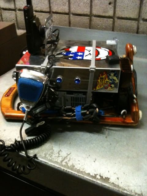

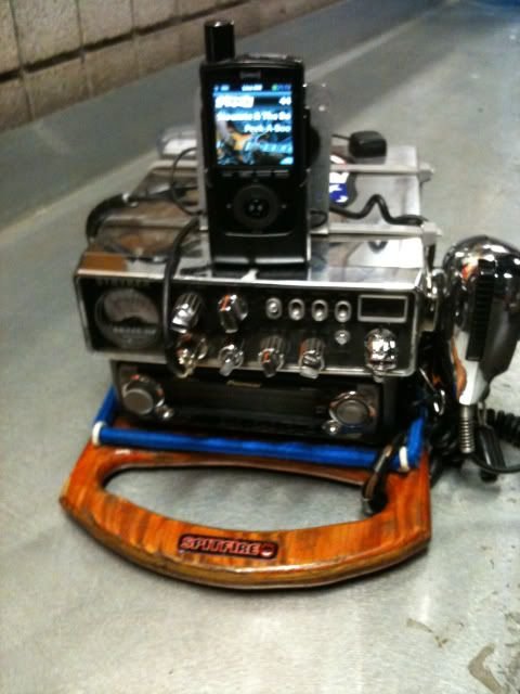

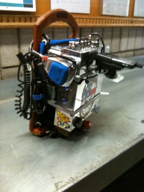

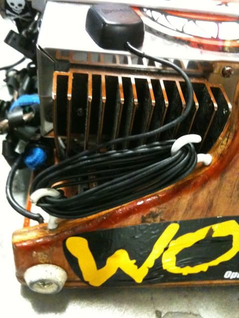

    Citizens Band radios certainly aren't what they used to be.
    Not so much the radios, but the people that use them.
    I had them as a base station and in my first car in the late 1970s in my teens.
    1969 Ford Fairlane with a huge spring whip antenna mounted to the rear fender and of course the PA speaker under the hood.
    I then used them in the mid 1990s when I started driving semis at work.
    We would travel in groups and the time certainly went by faster having someone to talk to.
    But as cell and smartphones came around I stopped using mine.
    I found I'd rather just listen to my music and comedy audio shows instead.
    I guess if you had a group of friends offroading or something it would be useful.
    But out on the road, the CB channel 19 is nothing but big mouths and agitators these days.
    I always ran them off an accessory because most of the time I drove a different tractor every day..
    Back then we had to have AM/FM radios as well because the tractors only had speakers in them.
    Now all the tractors have factory radios and I long ago lost interest in CBs.
    I sold mine on eBay years ago..
    Ah, the good old days..

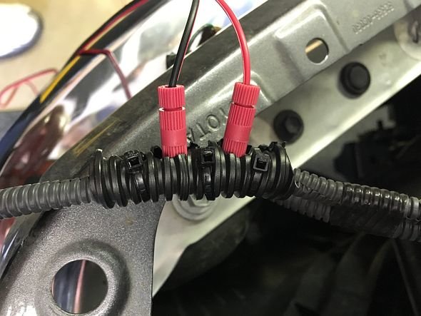

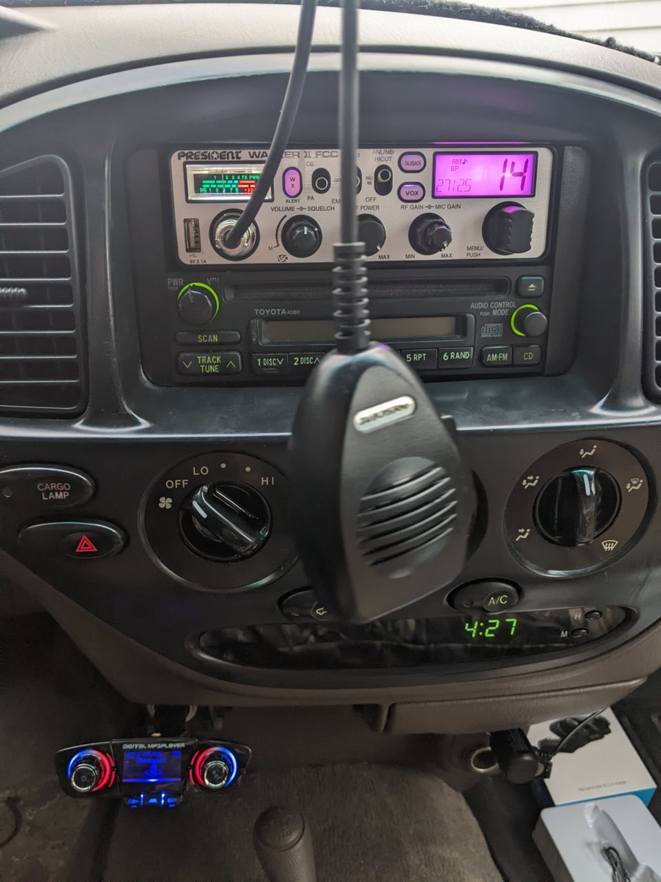

    So, as far as my research has figured out:
    The CB has an inline fuse on the positive lead -- Great! No need for an additional fuse. It's a 4w CB, and it seems like a 2-5amp fuse is okay, but I'm just going to run with whatever is OEM in the pos lead.
    I'm going to attach this lead to the positive battery terminal -- I got 12 gauge wire and heat shrink tubing and some eyelets that can connect to the pos term bolts.
    I'm going to connect the negative lead closer, almost inside the cabin.
    There may be some battery drain. If this proves to be an issue, I'll redirect the pos lead from the battery and into the ACC connection in the fuse box under the driver's side dash.

    This is right up by the CB itself right? You need to put a fuse right after the battery to protect the wire before it gets to the CB.

    All set. Need to tune swr. Should've fine that before oops.
    5A inline fuse. Neg to frame, pos to battery.

    Sick. So you had a portable am/FM + cb unit? How'd it power and connect?
    #42
  13. Mar 12, 2023 at 2:04 PM
    #43
    1lowlife
    1lowlife New Member
    May 4, 2016
    #3296
    11,253
    DADA
    THE GREAT STATE OF TEXAS
    2014 MGM DC SR5
    All the tractors had power, AM/FM, and CB antenna plugs.
    They also had speaker connections in the dash..
    The wires bundled up under the microphone were the power and speaker wires..
    In some tractors we bungied the unit on top of the dash, some we had to put it in the passenger's seat..

    Looks good, what are you using for an antenna, the most important part of a mobile install?
