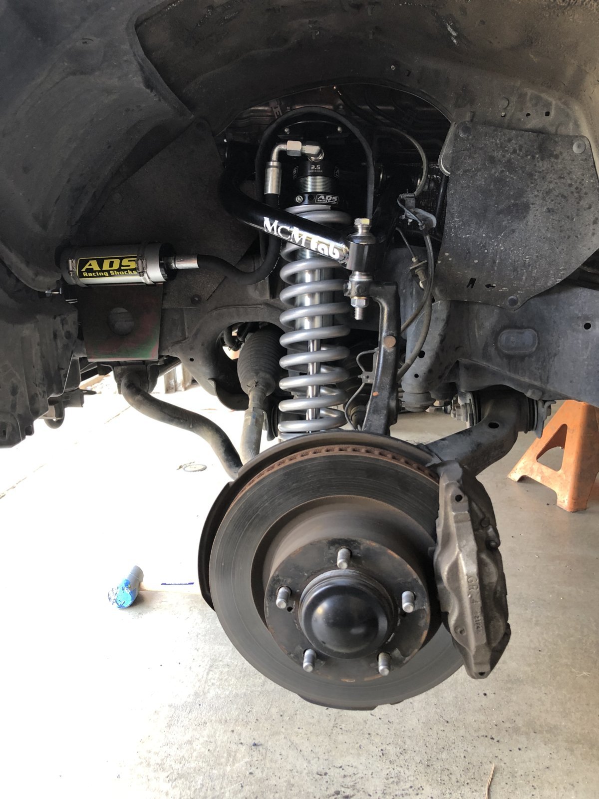

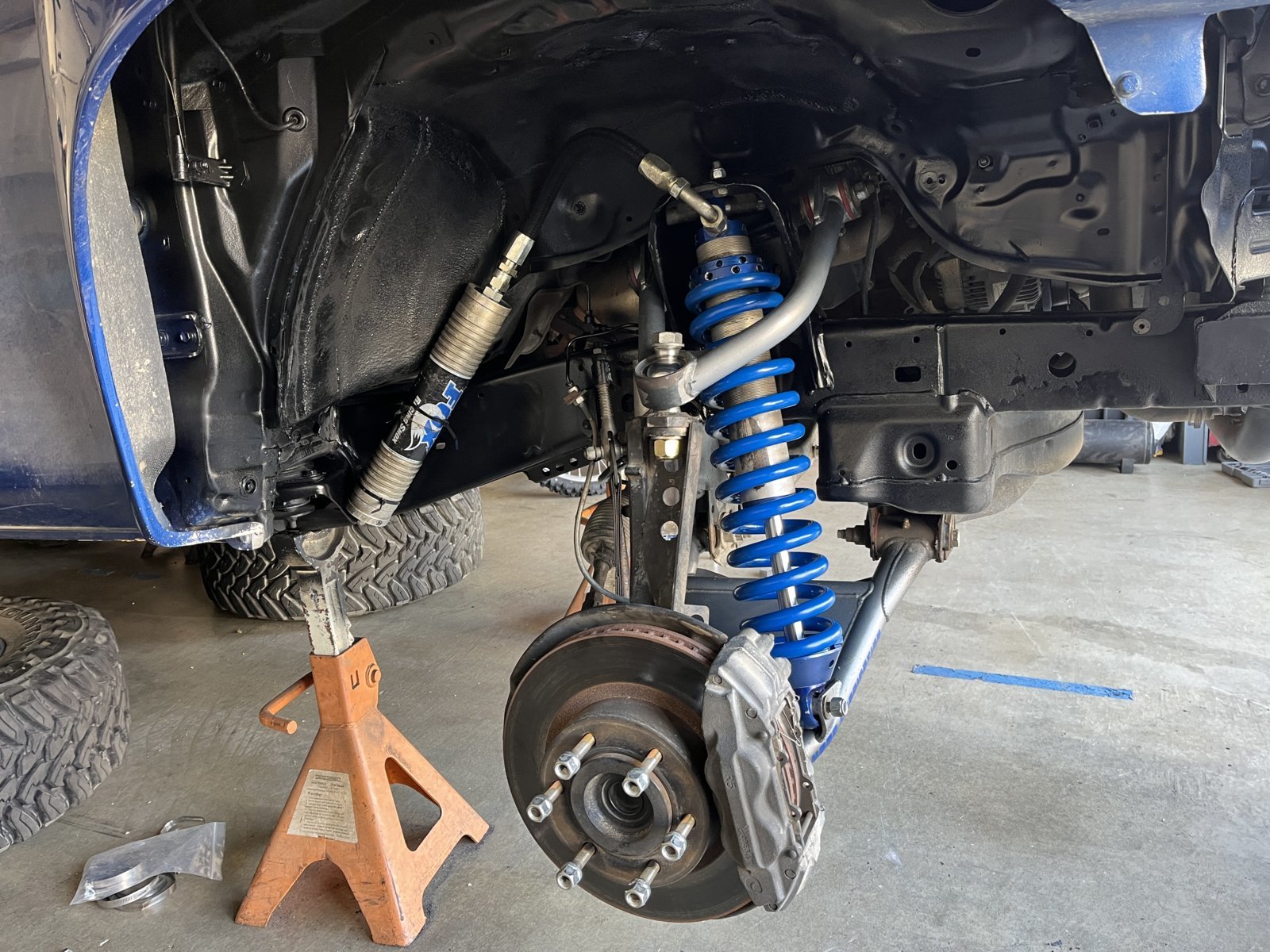

    I’m running 2.5” ADS coil overs on my 2014 with MCM Fab uppers. Four years and zero complaints.

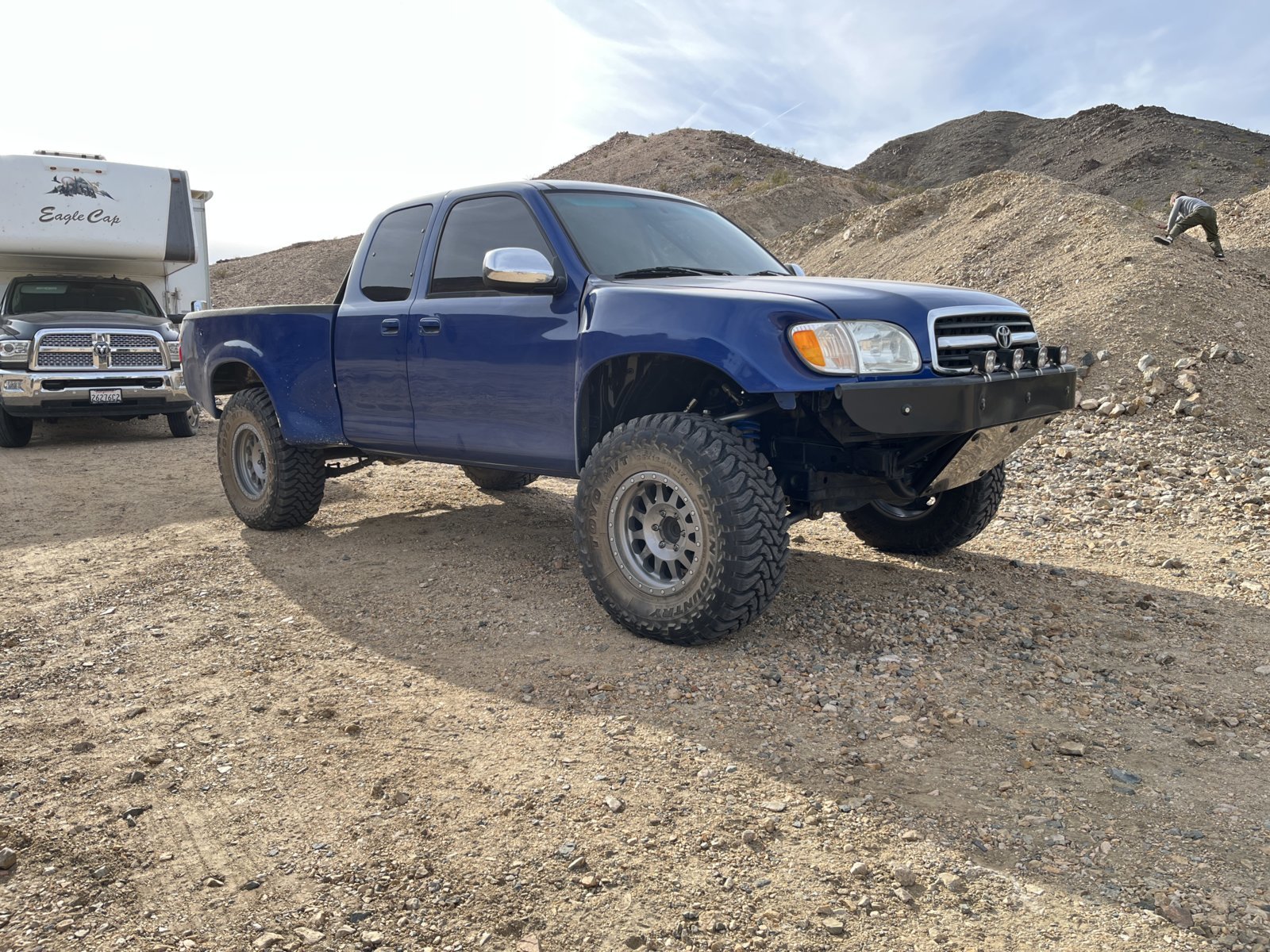

    I’m running 3.0x16” 4-tube bypasses on my 2001 with SUA Deavers. I’ve been running these for 8 years and have zero issues. I’m still running the valving ADS included, though now that my truck is caged they could use some tuning. I’ve rebuilt them once and they were slightly more difficult than doing Foxes or Kings, mainly due to the reservoir cap requiring a special wrench from ADS. Outside of that, the rebuild was the same.

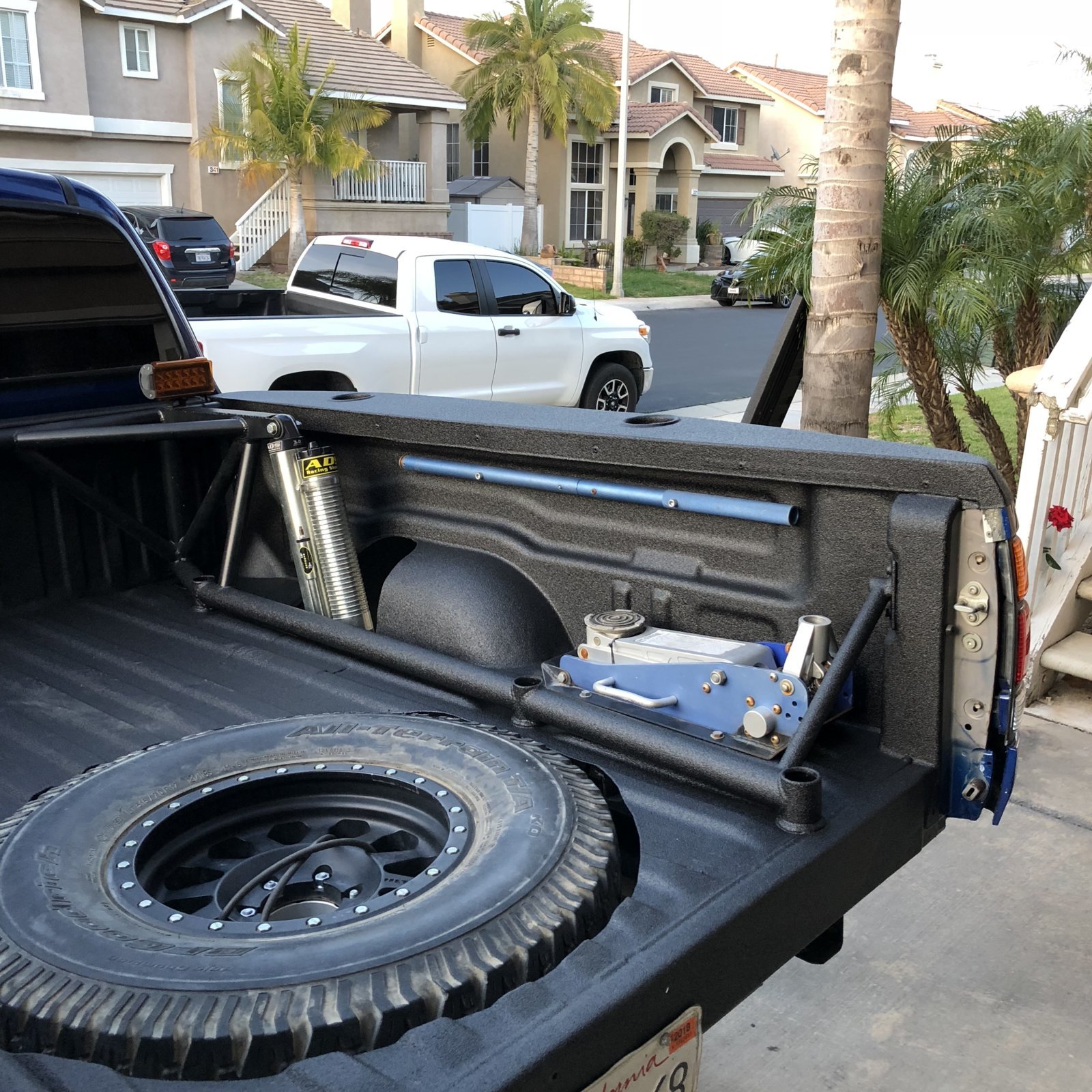

    Nice! That's a super clean bed solution you have there for your jack and handle. I'll bet your 01 is pretty fun! What's the front setup looking like?

    Thanks. It fits my dirt bike and I have a mount for two 5-gallon gas cans opposite the jack. The truck is fully caged, frame is fully boxed, front end is Total Chaos LT with Fox coil overs and bumps. Hopefully I’ll build a new front end this year with big hubs and brakes, possibly converting it to I-beams, at which point I’ll switch to ADS coil overs and big bypasses up front, maybe a 3.0/4.0 combo if funds permit.
