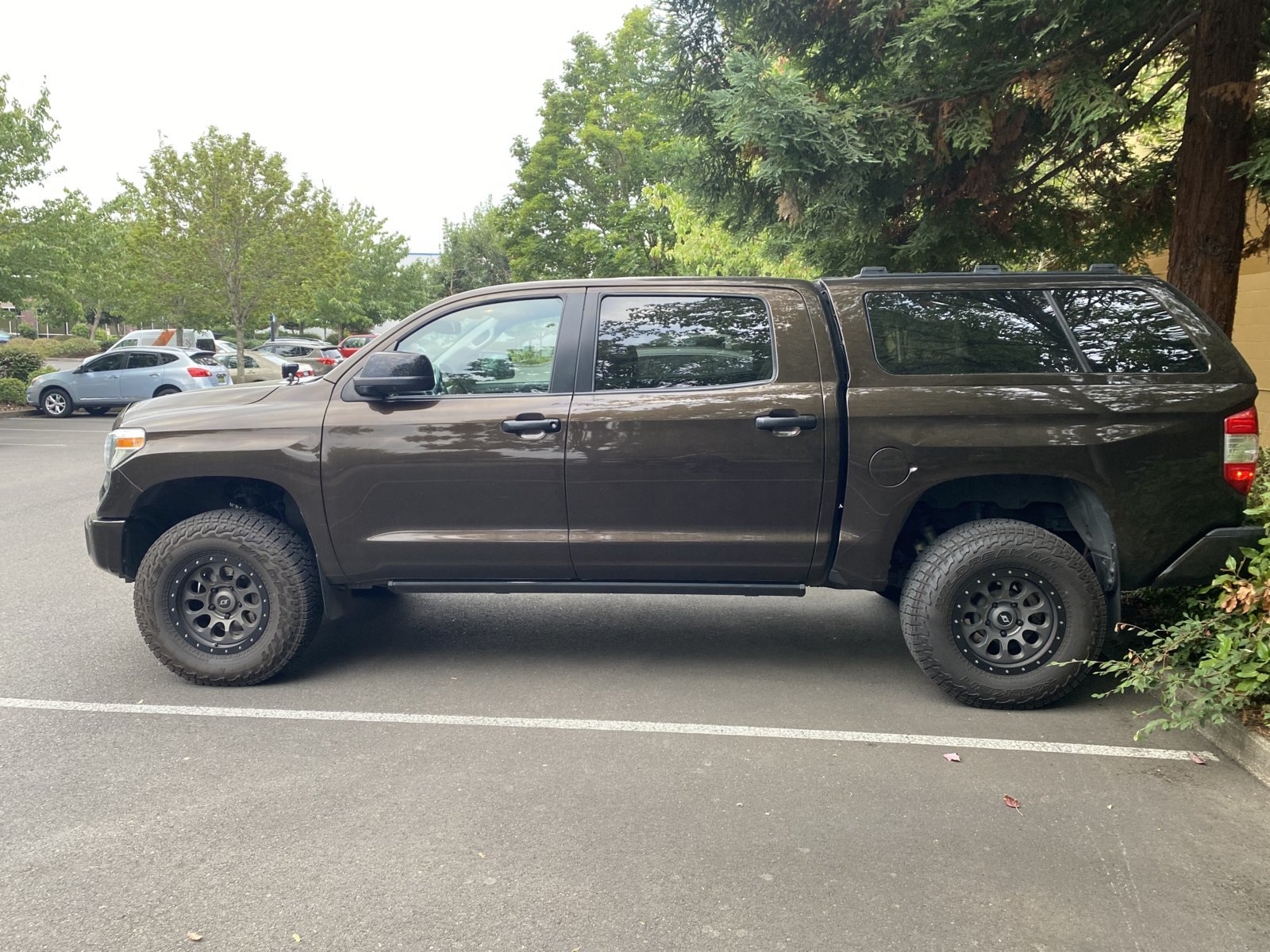

    What is the measurement from fender opening to centerline of rear wheel hub? I just took a couple quick measurements that I hope help.
    My wheel hub centerline to bottom of fender opening is 26.5”.
    There is 6.5” of exposed shaft on my “Deaver spec” ADS 2.5” smoothie rear shock.
    From my understanding, ADS’s Deaver spec shock offers no additional travel over their OEM spring spec shock. It is merely 1” longer. If your Kings are stock length, they’d have 7.5” exposed shaft on my truck. With your new springs, I’m not surprised that they’re another inch higher. They will settle…
    That said, you should have the correct length shock, regardless of brand. If I were in your shoes and my shocks were too short, I’d be looking at the King 12” set (to match colors) with a relocation bracket.
    And for reference, here is my rake as she sits right meow:
    Don’t laugh. She’s a dirty girl this morning…

    Well since we're taking parking lot photos measurements this morning I'll definitely chip in!! :)
    My rear is sitting at ~27" from center of hub to fender lip. I can't get a measurement on exposed shaft because I'm running the flexible boots. I'm relatively light compared to @Chad D. Nothing in the bed, just a softopper and some tools under the back seat.
    My front is ~25.5" from center of hub to fender lip, so approximately 1.5" of rake.
    Picture for reference.
