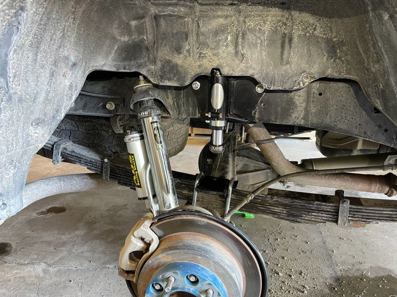

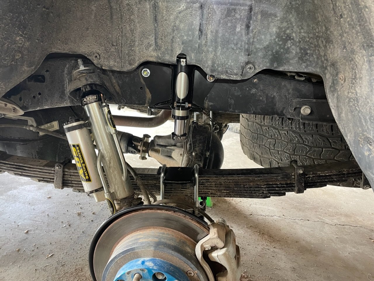

    I removed the stock bump stop brackets today and got the ADS hydro bumps in there. The rivets holding the stock brackets to the frame were a little bit of a pain, but not the worst job I’ve ever undertaken. Had to trim the inner fender liner a bit to make access for the Schrader valve on the bump. Strike plates slipped under the u bolts no problem. Bump stop brackets lined up with the holes in the frame no problem. ADS even put a relief cut in the drivers side bracket to accommodate that bolt that sticks through the frame and holds some plastic box inside the frame rail.
    While I was in there I tightened the top nut on the rear shocks all the way down as ADS recommended. Seems unlikely that they could twist under this kind of torque now.
    I also opened up all the bypass valves to see how soft I could get the rear. I had already opened the ride zone bypass all the way last time I was messing around. The bump zone bypass was probably about halfway open and I opened it fully. The rebound valve was already full open, as well. The ride is pretty soft around town like this, it’s nice. When I hit a dip hard it sort of feels like it bottoms out (but it’s definitely not). I hit some trails later in the day to see how it felt off-road. It ride s pretty plush, especially at higher speeds. I hit a section of whoop-ish potholes and the rear started bucking a bit so I probably need to decrease bypass on a few tubes to firm things up. Learning as I go on these things!
    Seems like the front 2.5’s may have trouble keeping up with this rear setup. Wondering if I should have spent the extra money for 3.0’s and forgone the bump stops. I suppose I could always upgrade in the future! Why do I get the feeling I’m headed for LT at some point?…
    chugs likes this.

    The 2.5 would be fine up front with a bypass. I’d play with those tubes in the rear a bit more. What leaf pack do you have? How much weight in the rear? Also how much pressure in the shocks and bump stop?

    Deaver 748. Only thing in the back is a husky tool box, no more than 200 pounds there. Not sure on shock pressure (assuming you are talking about coil overs?). Also not sure on bump stop pressure but Tyler at ADS says they ship with about 150 psi in them. I don’t have any N2 gear for checking/adjusting shock pressures. Probably need to do something about that. So far, bumps haven’t even made contact with the strike plates but I’ve only had them on for like 6 hours at this point.
    I was probably a little rash with the 3.0 comment. I’m sure I can get a 2.5” system working really well. I don’t really want to, but could probably go down the rabbit hole of revalving and changing shims in the coil overs. I’ve read some on it and it sounds like you can really change the way shocks perform if you start playing with internals! Adding a front bypass may be an option, too.

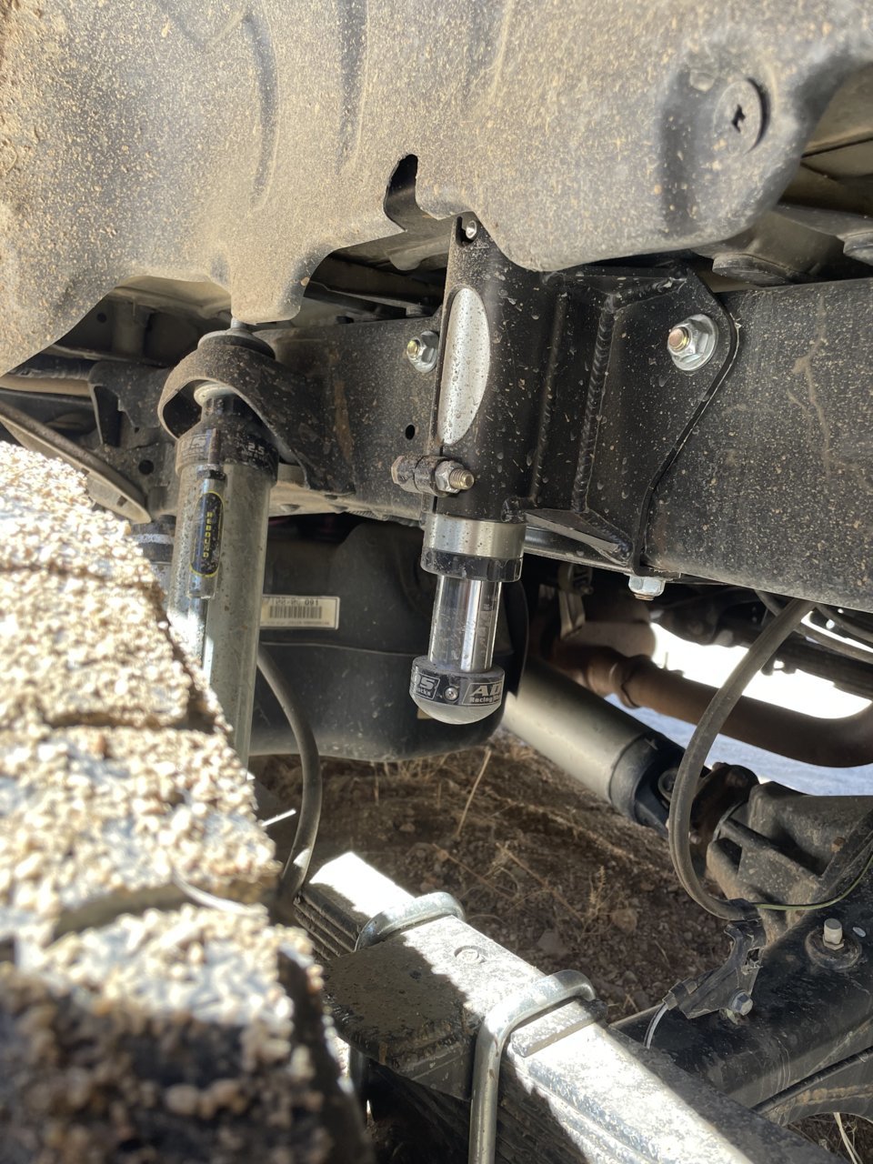

    Different as I'm' spring under. The bumps contact a strike pad welded to the housing. Yours is basically hitting a semi solid block on top of the housing You can put an O-ring on the shaft of your bump stop and it'll move upward, indicating how much you're getting into the bump. It's my opinion that you don't wanna be bottoming out the bump.
    Though it was a bummer having to replace the housing I learned a ton. I got to fit a Ford 9" backbone brace to new housing and weld it up w/o warping the new housing. Break it....build it back stronger... rinse and repeat. LOL
    Also, the nitrogen fill kit can be really helpful with the bumps, not to mention shocks. Too much nitrogen and the rear will donkey kick, at least this is what I found on my truck. I usually check the nitrogen before heading out on a several day trip and usually find a little top off is necessary. IIRC I ran the coil overs, when I had the same set up as you, at 200psi.

    Great info, thanks for your input! I had forgotten that you went SUA, makes sense about the bumps in that config.
    I don’t have an O ring on the bump shaft but I was able to see how far it travelled by the mud/dust that was wiped off when I hit them. Looks like I’m only getting into them about an inch, probably less, right now.
    I think I’ll need an N2 setup at some point if I want to tune this at all on my own. I’ll be looking into that.

    Weird they didn't come with o rings on the shafts. Could always put a rubber band on it if you wanted, but obviously not totally needed as you noted.
    For the nitrogen setup, all you need is a tank and a nitrogen regulator for like $40 off Amazon, and then a hose and chuck rated to like 600psi. There's lots of fancier things people do, but you should be able to put one together for like $150-$200. There's "no loss" chucks and stuff, but I just have a normal shrader chuck and that works fine in my experience if you pop it off fast. I got my tank from a home brewing website online and just traded it in at the welding store, but if they're anal about that just get the smallest nitrogen tank you can.
    One of those tools that's kind of useless but you buy once and don't need to refill it for years and will end up using it on your truck and friends and random stuff. Definitely worth it if you plan on messing with your shocks much.
