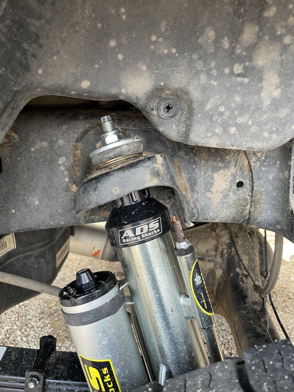

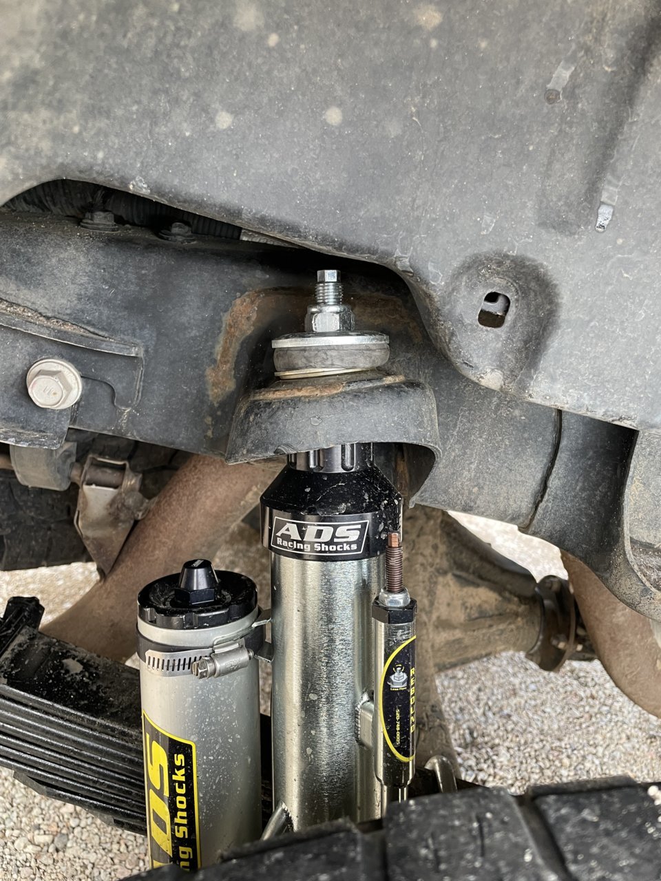

    On the rear bypasses, did you guys notice that the rubber bushing under the top hat nut "squishes" out sort of unevenly when you tighten the nut? It just seems to be a product of the angle at which the shock fits into the stock mounting locations. Not sure if it's a problem, just wanted to see if others noticed this.
    Passenger side
    Driver side
    Also, I now understand the fuss regarding the potential for the bypasses to rotate. I've got the top nuts tightened to the point that it's difficult to rotate the shocks by grabbing them and trying to spin them, but I think there is still potential for them to rotate given the forces that could act on them when driving. Any input from you guys about how to torque these things down further or avoid rotation? Matt at MCM is saying to tighten the top hat nut until it stops then back off a 1/4 turn, but that's a bit subjective. We're talking about tightening a nut on top of a rubber bushing and I'm using a fairly standard 7/8" box wrench to turn the nut. I could probably get a wrench that would be long enough to put enough force on this to crush the bushings and bend washers, but that doesn't seem like what I'm after.

    Whats ADS say about this?
    From what I see, those nuts are way too tight. That stud is likely threaded into the top cap and being too tight can have it loosen and unthread from the body entirely. I bring this up because its happened to a lot of Fox shocks. Just giving you a heads up on that, would hate to see it happen to you

    I havent spoken directly to anyone at ADS to pose the question. I've been trying to deal directly with MCM since he sold me the shocks and seems to be a go-to guy for things Tundra/ADS related. I may call ADS today and see what they think.
    What in the photo makes you say the nuts are too tight? Is it the amount of compression on the bushing? Amount of threads showing on the stud? I'd hate to see the top cap unthread, as well. I only have the nuts this tight in to try and mitigate the shock rotating. I don't see a way (other than more tension on the stud/bushing) to keep it from spinning. I don't want one of the bypass tubes making contact with anything on the brake rotor assembly.

    Are your top nuts tightened down as far as mine? Were you able to get a reading on the actual amount of torque on the nut?

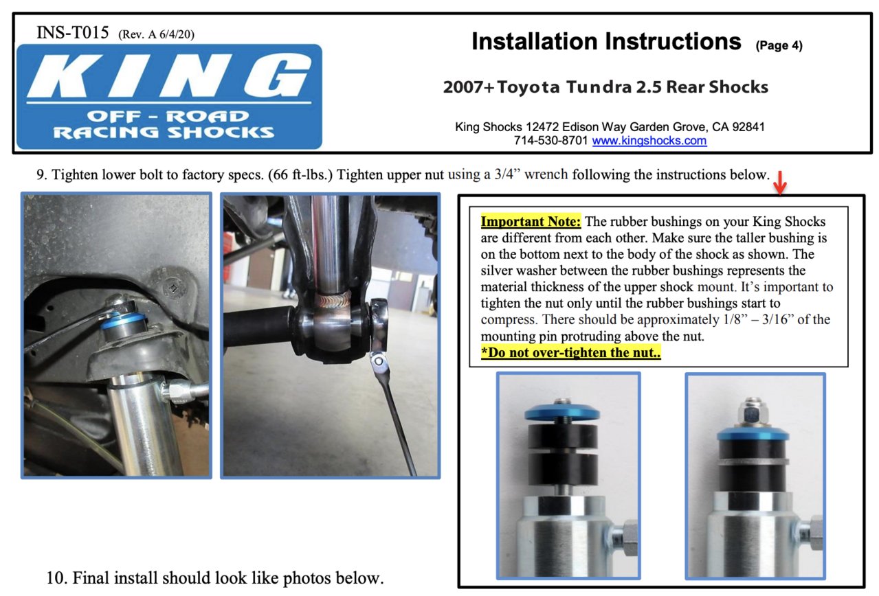

    I understand, and the shock manufacturer may be able to provide additional support. We install a lot of Tacoma suspension, both have similar stem top mounts in the rear. Fox clearly states in their install guide "Tighten top locking nut until 5/8’’ of total stem is showing." and when we do this, there is not quite this amount of bulge in the bushing. Looks can be deceiving and totally understand your concern about keeping the shock body from rotating.(King install guide reference attached)
    Did ADS provide any type of install guide with their shocks?

    The bushing is definitely bulging a bit on my install. Could be an issue, might not be. Sounds like even Fox or King doesn't specify a torque value. It's more based on the amount of thread showing. Do you guys just use box wrenches to tighten these things?
    It's obviously more of an issue for external bypass shocks to rotate in the mounts, but rotation seems like it would be an issue for any shock with any sort of external fitting, right? What I mean to say is, properly torquing and securing a rear shock isn't purely a triple bypass problem. Anything other than a bone stock, smooth body shock is gonna have problems if it tries to rotate.

    Tyler says the "squishing" of the rubber bushing is pretty normal. He said "you ought to see the 4runner ones!" He also confirmed that tightening the top hat nut until it stops is the correct torquing procedure. To elaborate on this a bit, the threaded stud steps up to a larger (and unthreaded) diameter down lower on the stud. By tightening the nut until it stops, we're running the nut down tight to where the threads stop and the larger diameter stud stops the nut's travel. Because the torque on this nut effectively changes as the suspension articulates, this keeps things nice and tight so the shock body doesnt rotate.

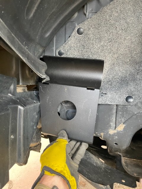

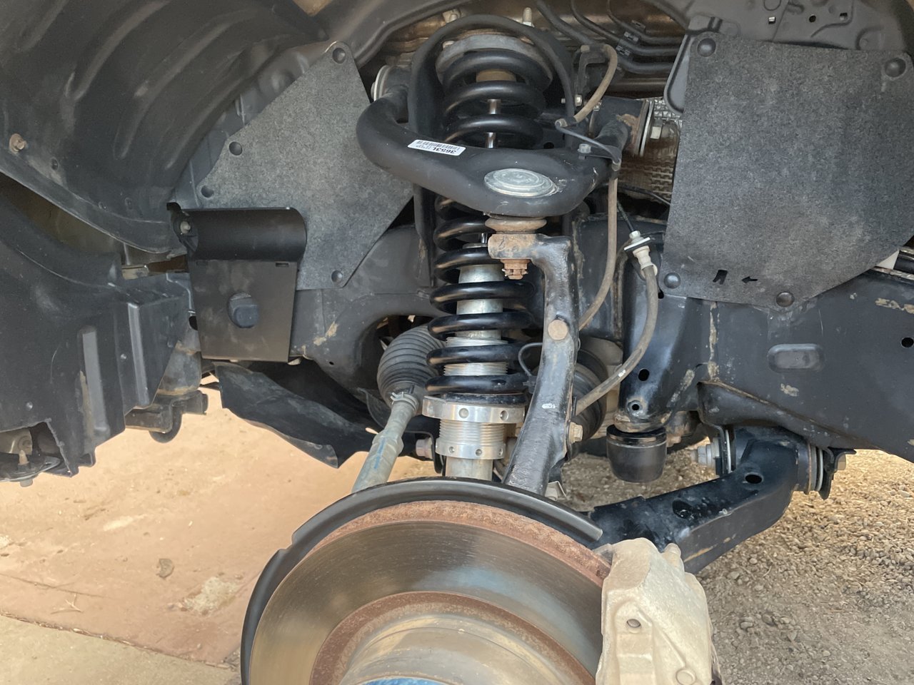

    Does anybody know which way the front coil over reservoir brackets go on?
    they have an angled side and a straight side. It seems like the angled side should face toward the rear of the truck. Am I stupid?

    Mine aren’t ADS but the angle faces the rear on my kings.

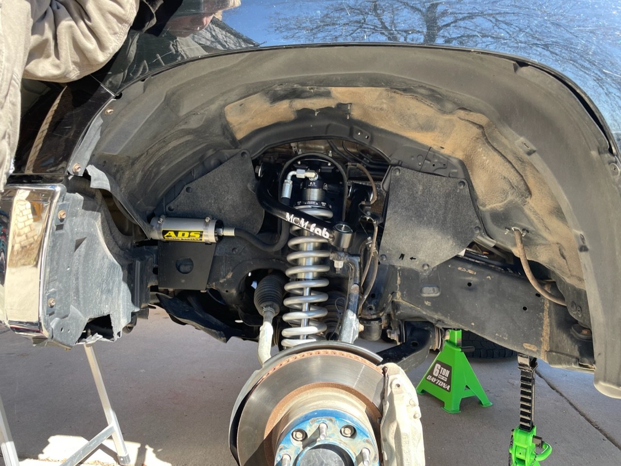

    Giddyup! I can’t see how this would work with the angled side facing toward the front of the truck.
    I won’t be able to get my coilovers and UCA’s in today but I wanted to make some progress. Mounted the resi brackets and durobumps.

    The fender liner on the passenger side looks like it’ll need trimmed or remolded in order to accommodate the reservoir.

    Yep, easy peasy. It’ll be a few areas of fitting

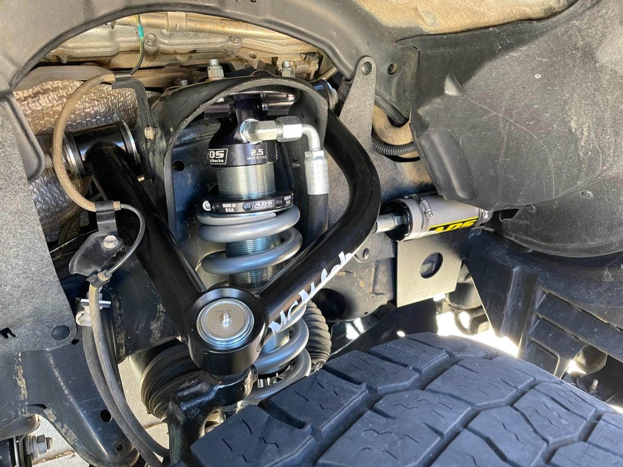

    Coil overs and UCA’s went in this morning.
    UCA’s were a bit of a struggle bus on the drivers side, but went super smooth on passenger side after I figured out the tricks.
    Took her out on some trails this afternoon for a break in. Yikes. You can party pretty hard with this kit. I am not disappointed. Hammered some pretty rough (and tight) sections around 30mph. Looking forward to dialing things more but very happy so far!

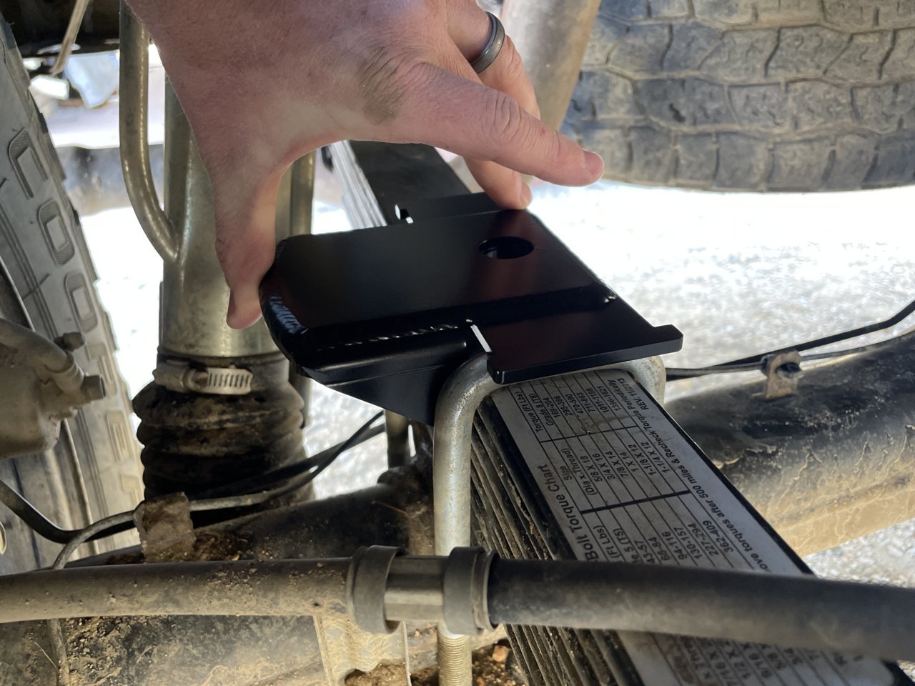

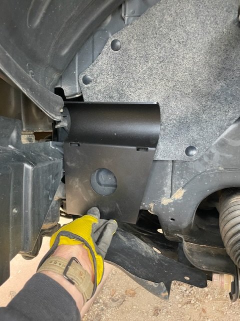

    This might be a dumb question, but I’ll ask anyway…
    The rear bump stop strike plates should probably be installed with these little “wings” pointed down right? Seems like that’s what someone smarter than me would do..
    Mocked up for clarity.

    How you have it here is how they should be mounted.

    I don't know what I was thinking when I didn't install the strike plates when I did the leaf springs a few weeks ago. It's not a huge deal to put them on, but I should have saved myself the trouble and done it with the leaf packs.
    This suspension is pretty neat. I'm trying to get my rear bump stops installed in the next week or so and that'll clear all the ADS parts off my work bench!
