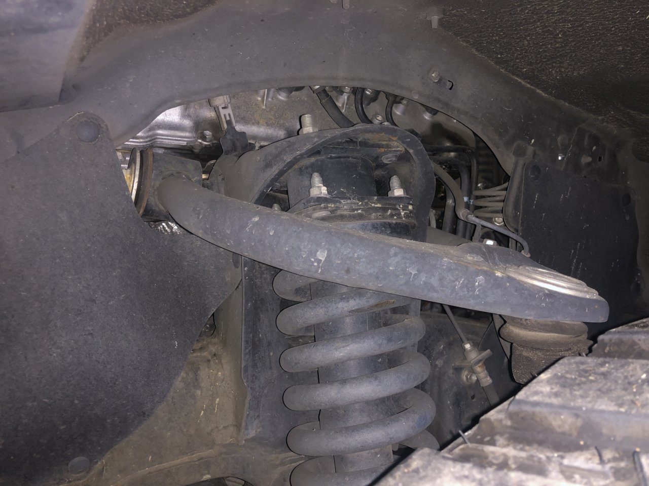

    Ok, I’m back in the states. This is what I’m currently working with. How can I raise this beast 2” more or so with the current set up I have ?

    UCA’s look maxed.

    What’s the measurement of the spacer on top of the front shocks? Whatever it is, double it and that is how much lift you already have.
    At 3 inches of lift is where you start to need upper control arms so that your alignment can be adjusted correctly. Also the higher you go you will start to have issues with your CV angles. Spacer lifts and my eyes are only for aesthetics. You also risk bottoming out your shocks and destroying them without bump stop spacers. In the rear you probably have a lift block underneath the leaf springs just above the axle. I wouldn’t suggest going with giant lift blocks either. A set of lifted Springs is probably the best. You can also dude lifted shackles and get up to about another inch and three-quarter’s of lift that way. You could also do an add a leaf.
    If you want your truck to sit any higher than it already does, I suggest ditching all of it and going with one of the popular bracket lifts. They’re not the best for Hardcore Offroad but they will give you the height you want and you can also get some adjustable coil overs to go with it. With that, you can get a decent riding suspension and the lift you’re looking for.
    How capable do you want your truck to be? A bunch of lift doesn’t necessarily mean it’s capable and able to rock crawl.
    So that some of these guys around here who are suspension gurus, and have more experience than I can help with... What are your goals for this truck? Just big tires and sitting up skyhigh? More of a mall crawler? Or do you want a truck that can do some high-speed offloading? Or maybe something in between?

    Just looking at that can on top of your coil over, I'm guessing there's more to this. We need a picture of the cross member, from straight ahead. I suspect that can is part of a bracket lift.

    I was kinda funnin ya.
    We need more pics of what you got.

    Agree. Is there a block between the leafs and axle? Looking again I think it's a 1.5" can w/o the bracket lift
