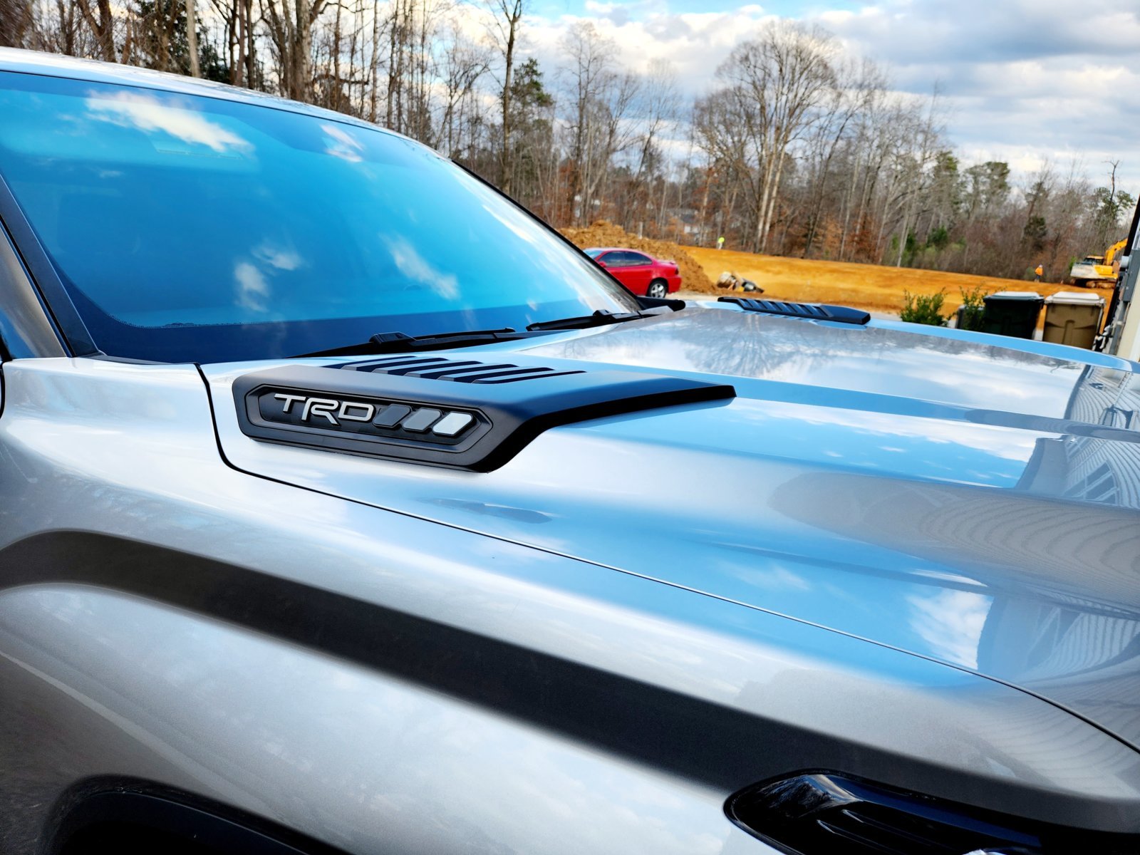

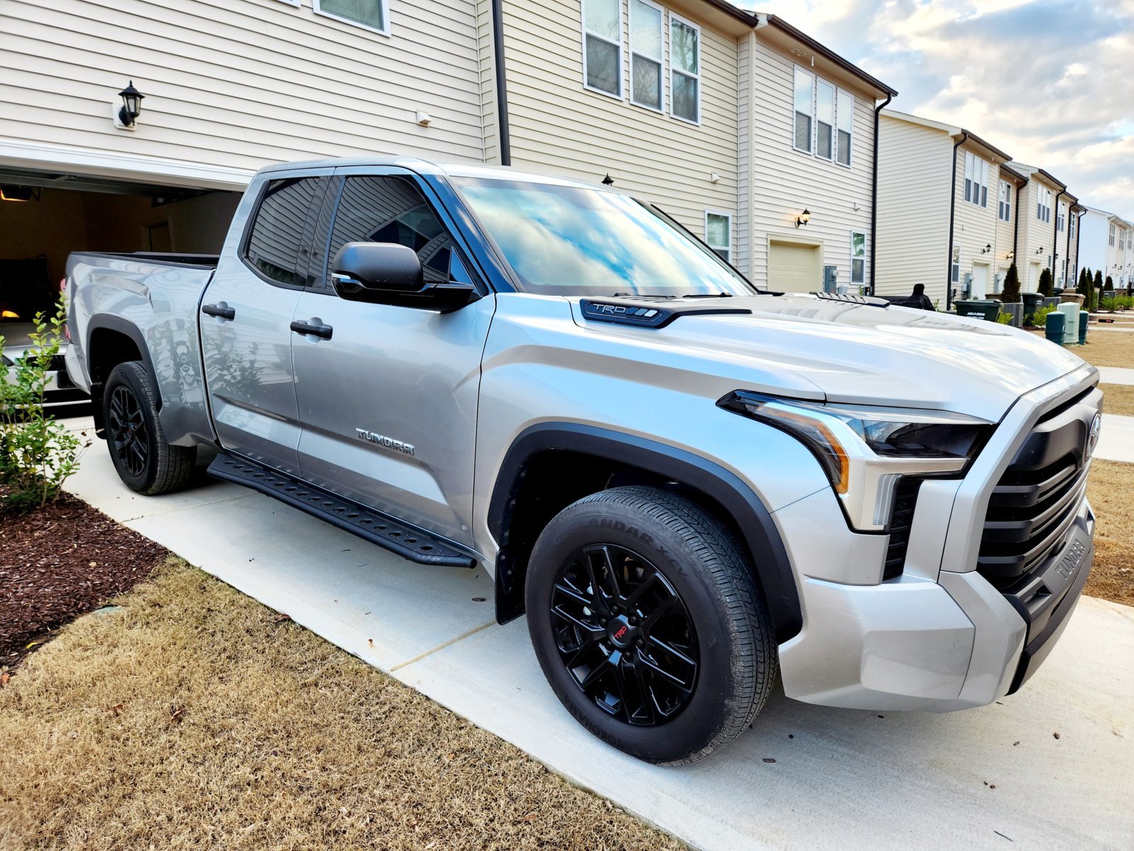

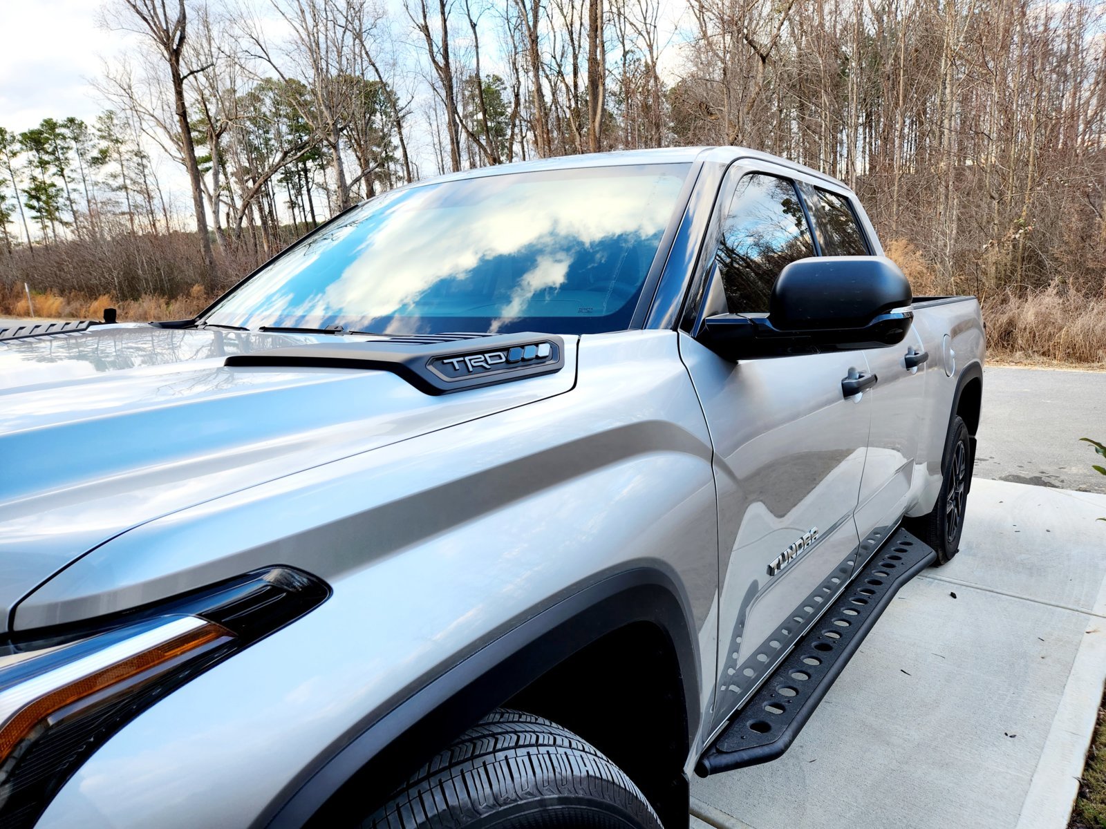

    I’m doing it and there’s nothing anyone can say or do to stop me! IMG_5056.jpg
  2. Nov 17, 2023 at 7:32 AM
    #62
    Ipaddick
    Ipaddick New Member
    Apr 16, 2023
    #95577
    688
    Canada
    Platinum hybrid w/advanced package
    W
    Well done. Ever considering selling them? Or posting a how to?

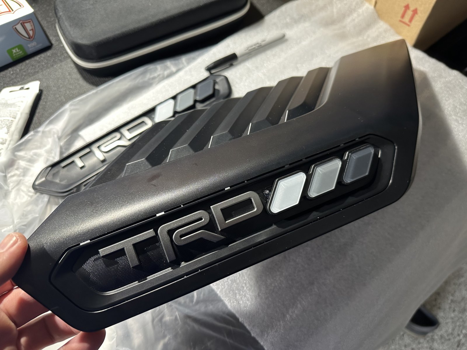

    Thanks. Definitely wouldn’t sell them. I should have posted a how to but it only took me 30 minutes or so.
    These are the emblems you want to get. The length, height and thickness is damn near flush with the TRD.
    TRD Grille Decor Badge, Tri-Color Grille Badge Emblem Decoration Accessories Car Truck Label Fit for Tacoma 4Runner Tundra Sequoia Rav4 Highlander (Grey) https://a.co/d/gf6hBx0
    I used my soldering pen and melted the tabs that are holding the “pro” on. Just push through from the back into the lettering a little and then you can take some needle nose pliers and pop them off.
    From there you taped the emblem and the mount it comes with. This step is crucial because I’m horrible at math and measuring. I put small and I mean small double sided tape on the mount so that when I line it up on the molding the emblem pops off. I attached the mount to the molding with scotch tape so that when I pop it off, the mount stays on the molding so i knew where to drill.
    From there start a pilot hole and work up to a 1/2 inch drill bit. That’s it. Place a small strip of double sided tape on the back of the emblem and the mounting holes will sit flush with the molding. I used some silicone to plug the holes on the back side etc. I didn’t want to bolt the emblem on because this way I can swap them
    out for any of the other color options they have.

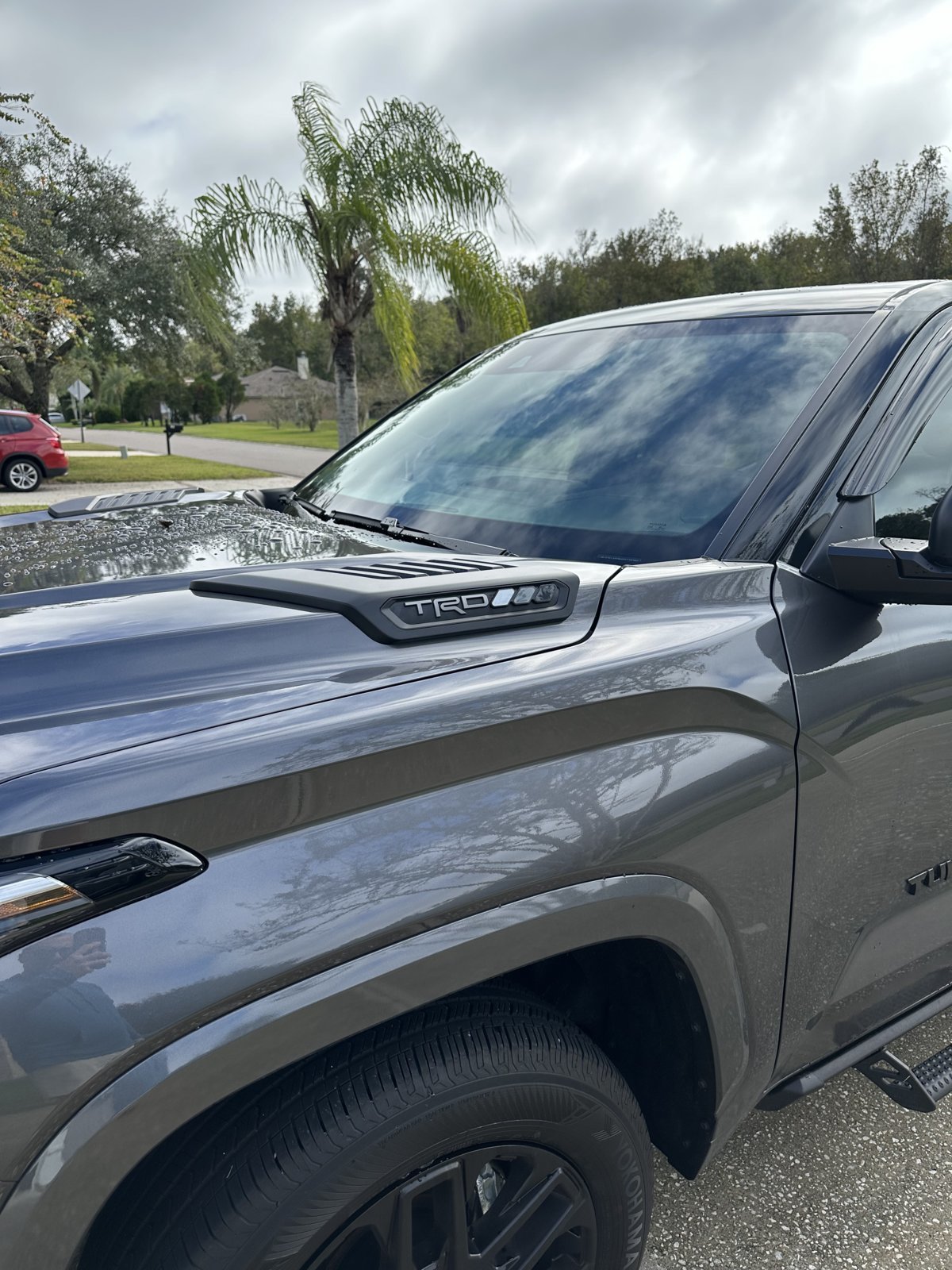

    Do you have a pic of them mounted on the hood yet? Just ordered two and will give this a try.
    Did you attach the tricolor emblem with anything, or just used double sided adhesive?
    Rykr[QUOTED] likes this.
  5. Dec 5, 2023 at 4:10 PM
    #65
    Rykr
    Rykr New Member
    Sep 16, 2023
    #103981
    114
    2023 SR5 TRD Sport 4x4 MGM
    just drilled 1/2 holes so it would sit flush and used a 1/4 inch wide piece of 3m tape and pressed it on. I did use a little silicone on the back to seal around the holes to keep water out so that secured it a little extra. Been on for about a month now and holding strong.
  6. Dec 5, 2023 at 4:17 PM
    #66
    GingerGremlin84
    GingerGremlin84 New Member
    May 21, 2023
    #97373
    22
    2021 Black TRD PRO
    Looks great. Definitely giving this a go on the wife’s Lunar Rock Sequoia.
    The tri color emblems don’t have the “glass” look on Amazon like it does in your pic, might pic up the grey and the red sets and see which one looks best against the lunar rock.
    Thanks for the quick pic on the truck.

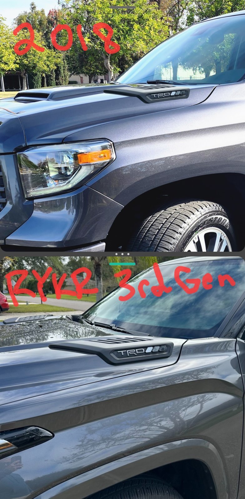

    That looks awesome! Love the look. I'm a 2.5gen but do you think that these would fit on a 2.5 gen hood? The curvature seems almost exact, maybe the height looks a little different but I would think as long as the curve matches, they might work? I would definitely consider doing this mod on my Tundra if I knew for sure they'd mount flush to the hood. Here's a comparison of yours and mine... Whaddya think?Screenshot_20231217_061921_Chrome.jpg
    Any 3rd gen in So Cal have one I can meet up that has one off their truck that I can just test fit?
    Jim LE 1301 and Rykr[QUOTED] like this.
  12. Dec 17, 2023 at 6:38 AM
    #72
    Rykr
    Rykr New Member
    Sep 16, 2023
    #103981
    114
    hmmm the curvature looks the same it’s just raised more. I think it might be worth ordering. You don’t have ti stick them on to know if it’ll work. Just place them and you’ll know right away. If they don’t send them back.

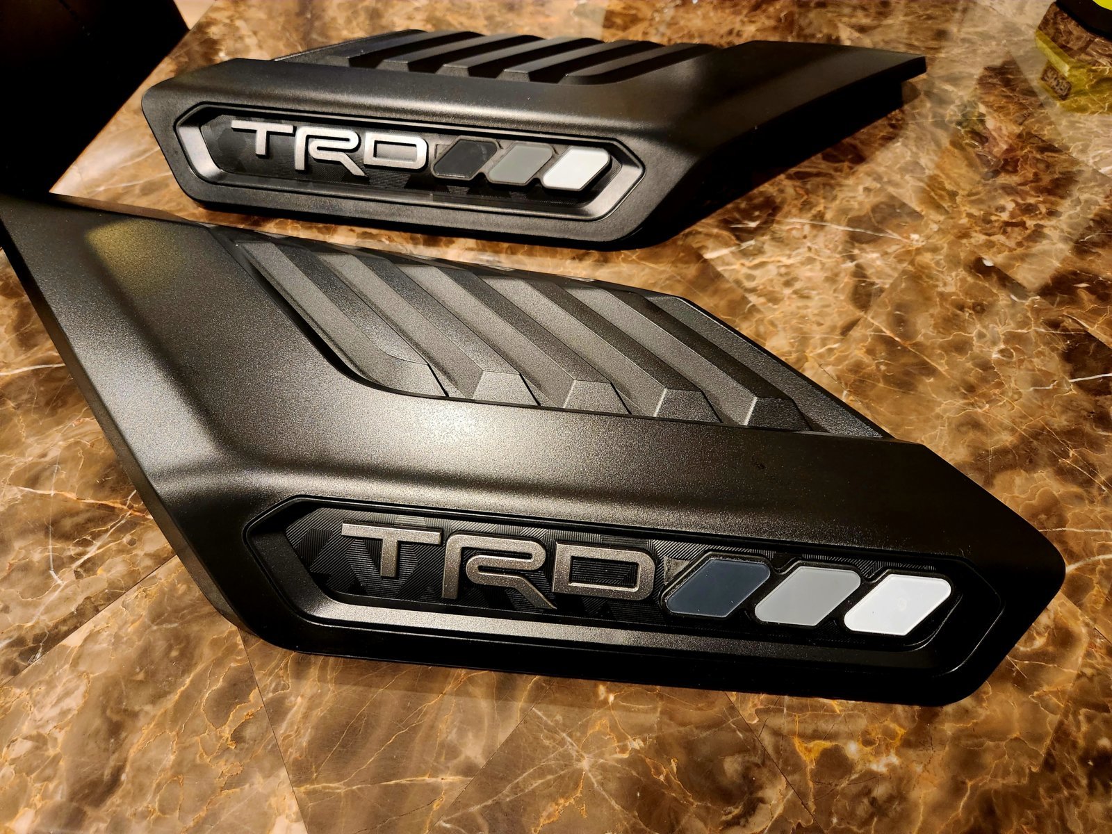

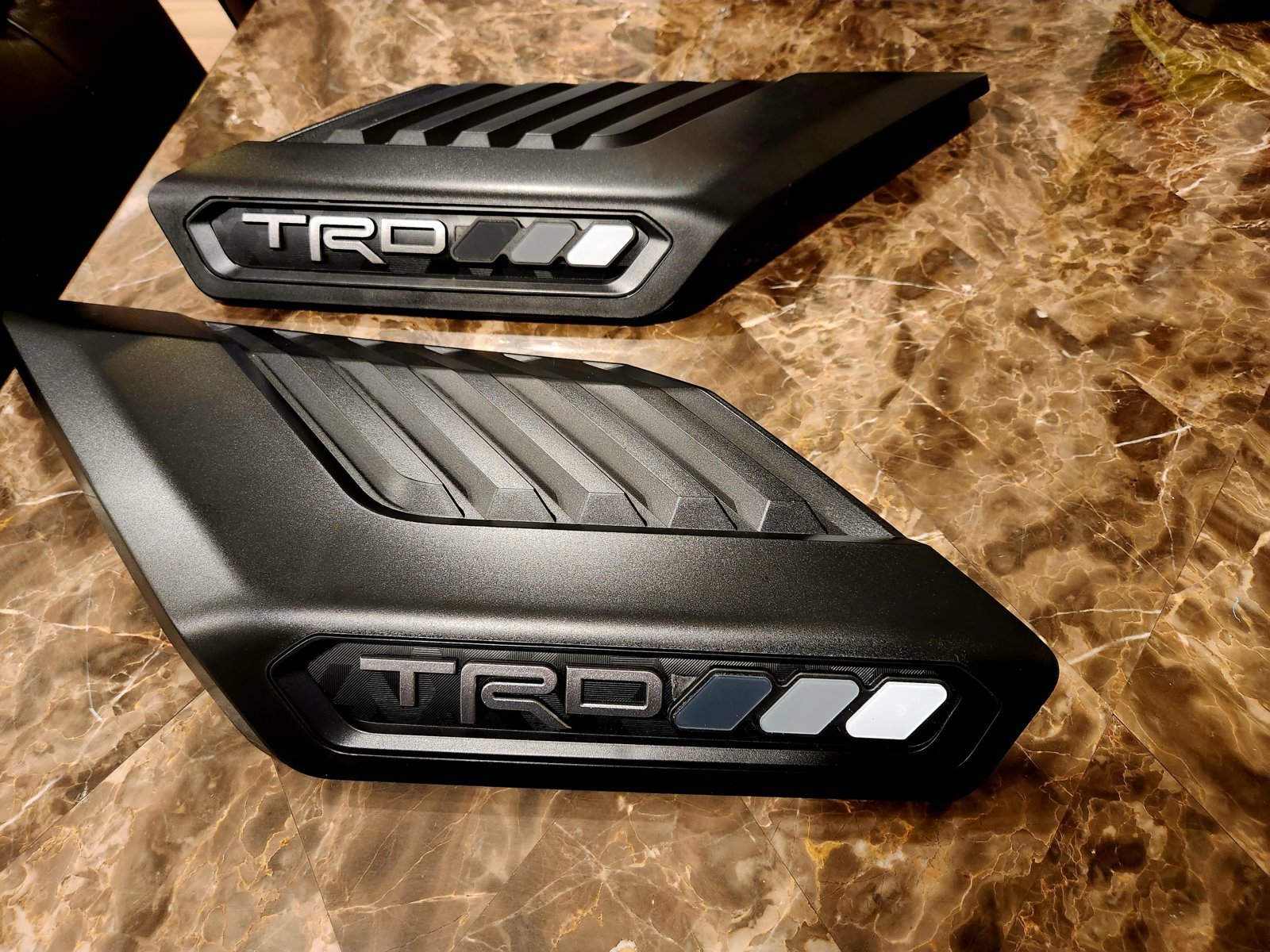

    Got my Pro Hood parts yesterday. Really like the look. Almost tempted to just put the Pro on my Offroad. I like the red pop on the green. I do think an Offroad will be better, did we ever learn the link to the red Offroad lettering that will fit this?
    I’m hesitant to drill out the Pro lettering, I don’t want to mess up the digicamo. Also, it’s not 100% clear to me the exact spot on the hood where this will attach, there is some room for adjustment. Is the dual sided tape on the part sufficient to keep it on permanently? I removed all the included bolts and snaps it came with. Thanks all I like this mod but want to do it right! Cheers!!
    PS I didn’t attach to my hood yet, it’s just placed on there without adhesive for the pic
