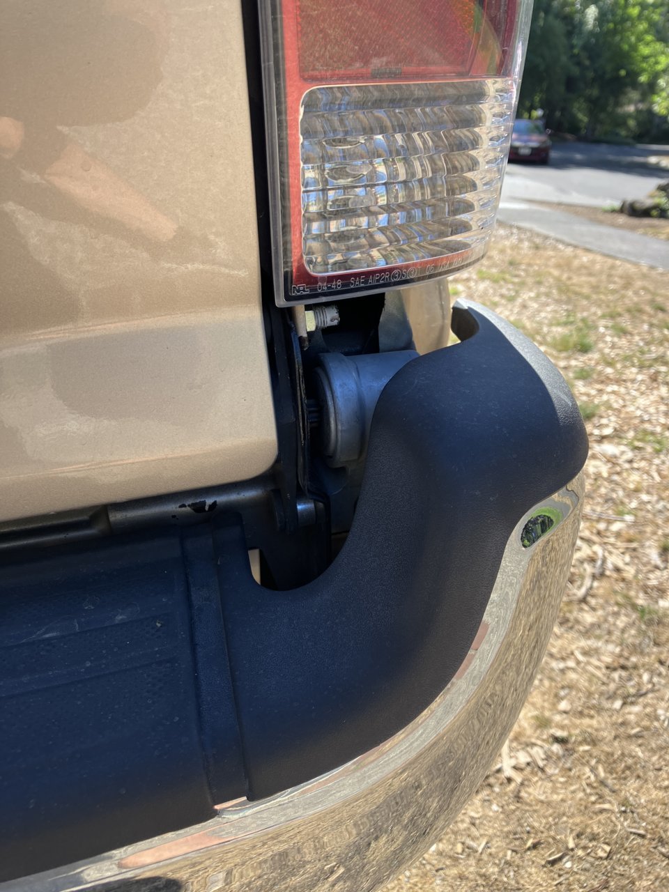

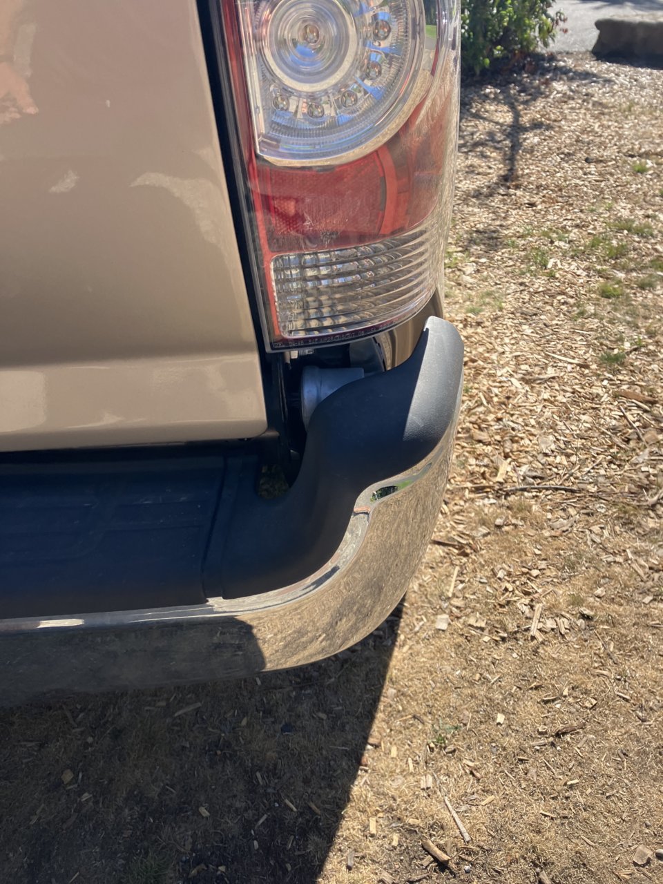

    My ‘05 Tacoma had fresh paint and was in very nice cosmetic condition. Probably as good as your FGT, possibly better. AZ it’s whole life and fully stock w no mods, only found one small dimple inside the driver door jamb. I was a little sad to cut but f it, I got over myself. Thin non-structural sheet metal is not gold. I dremeled the edges smooth and painted them.
    Using OEM parts is the key. Toyota reliability and replacement option. I only wish my 2nd Gen tailgate were heavier so it would actually open without having to pull. I probably just need a softer dampener somehow, but I think there is only one part for that.
    Not sure what you are asking about with the license plate bracket.

    Mine looks like this. Didn’t cut and replace the trim plastic nor paint the dampener black. I’d prefer to cover w steel bumper.
    And, if I pull while opening the handle it drops, just if I open directly up and don’t pull back it stalls. Though even that seems to drop now, after a few seconds. Perhaps because it’s on a slope.
