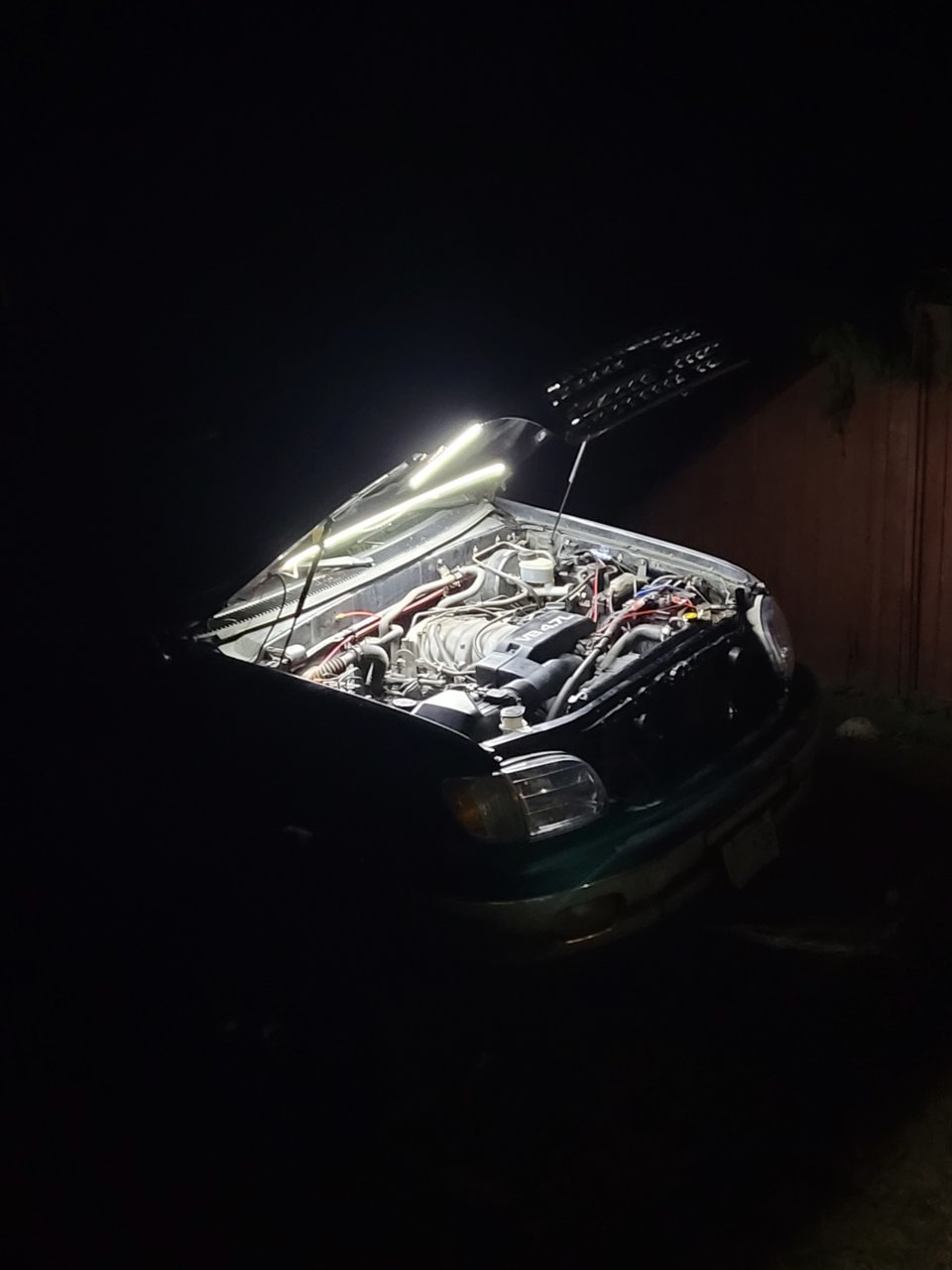

    Whoa! Why buy a light bar when you can just drive with your hood up! :drunk:

    This is how I have it also. No plans to change it. It works exactly how I want it to.

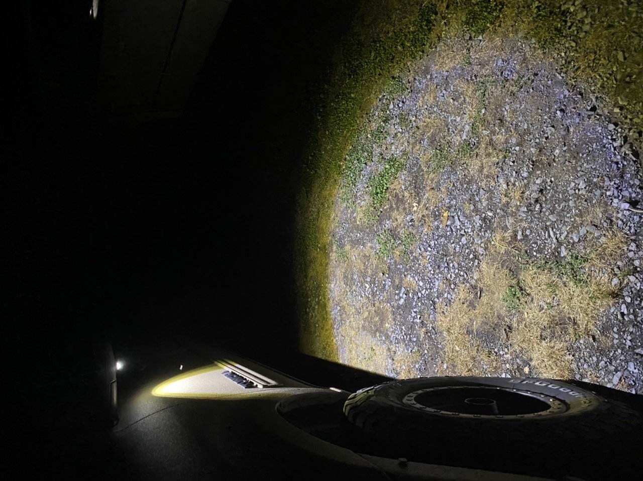

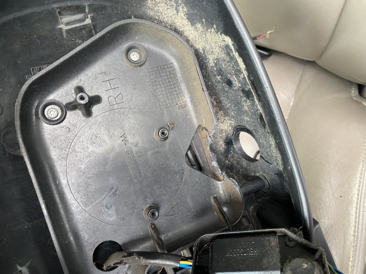

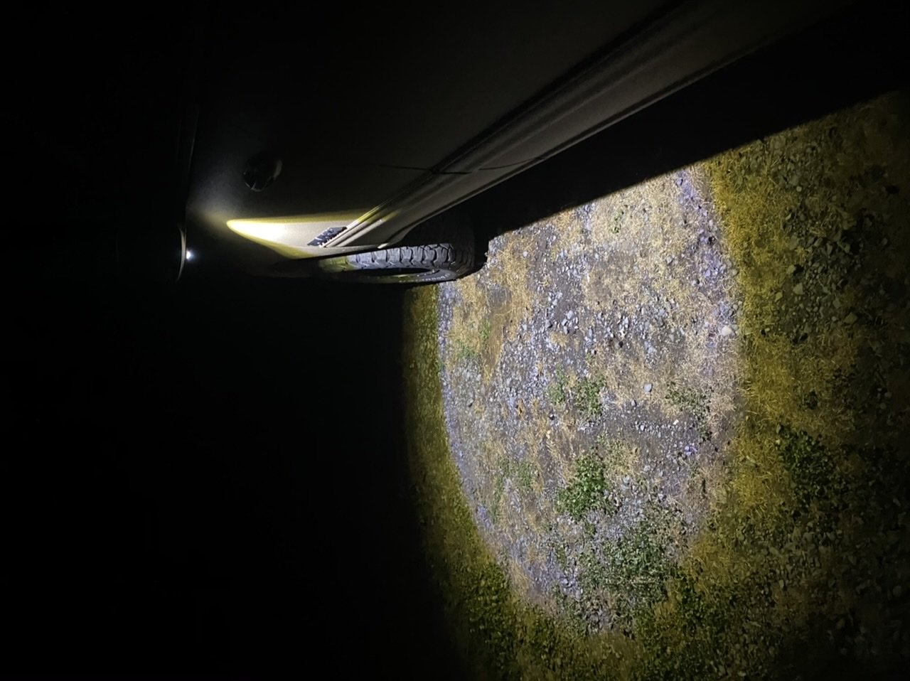

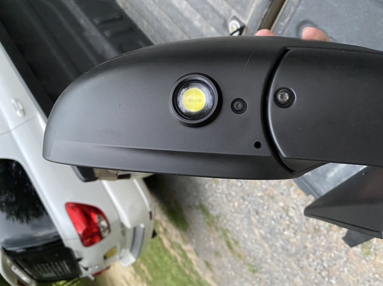

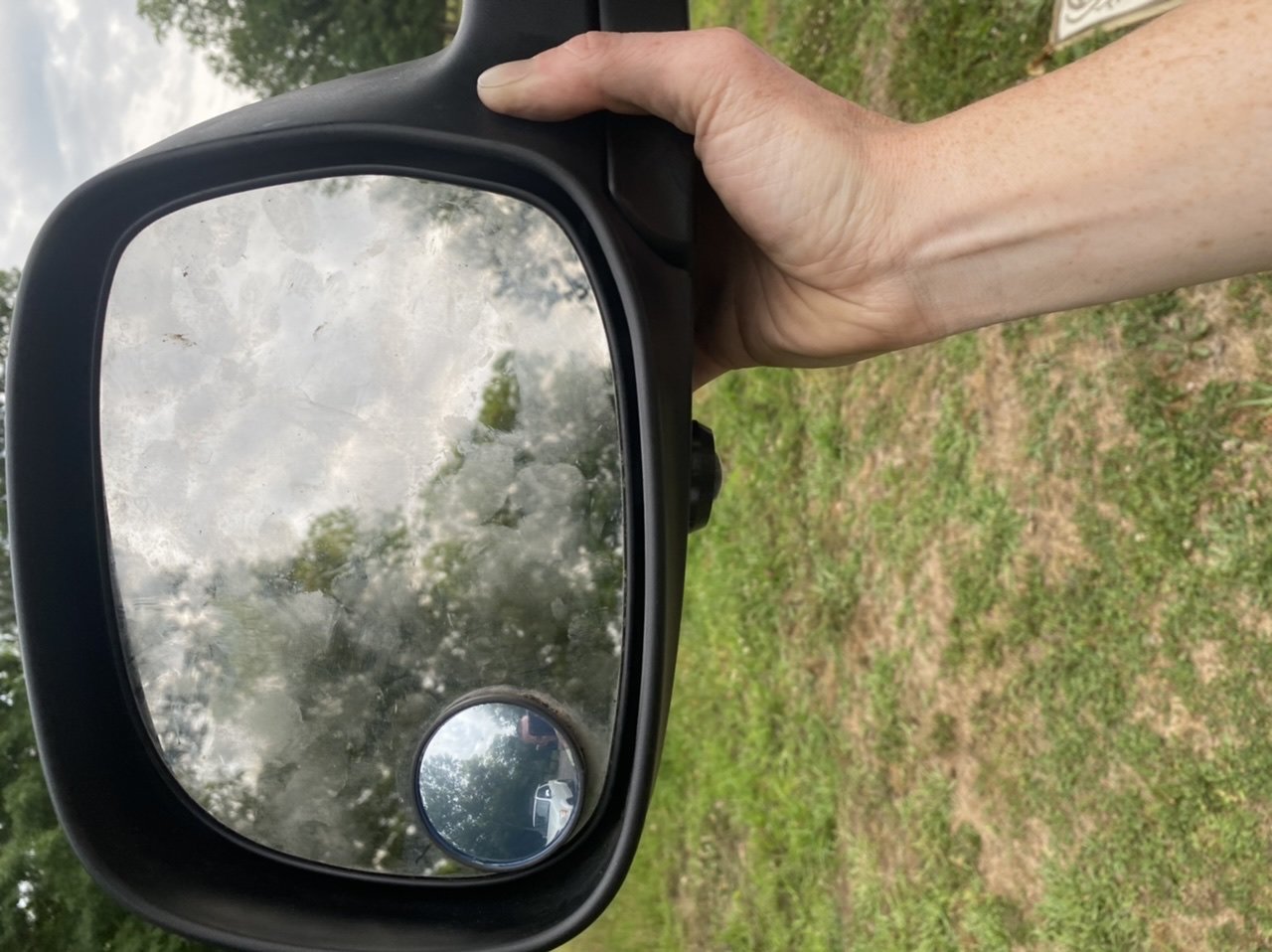

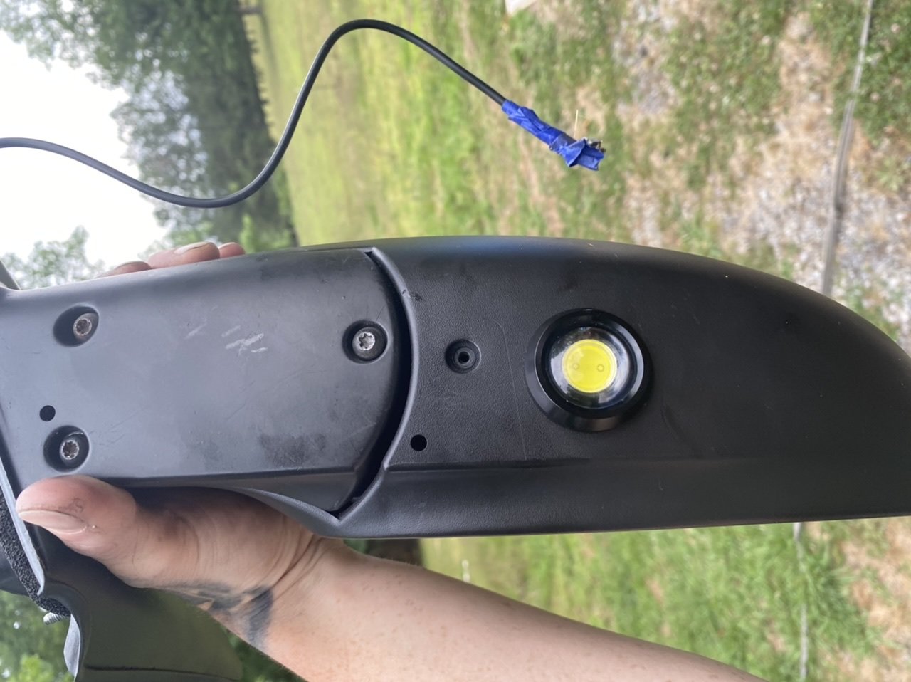

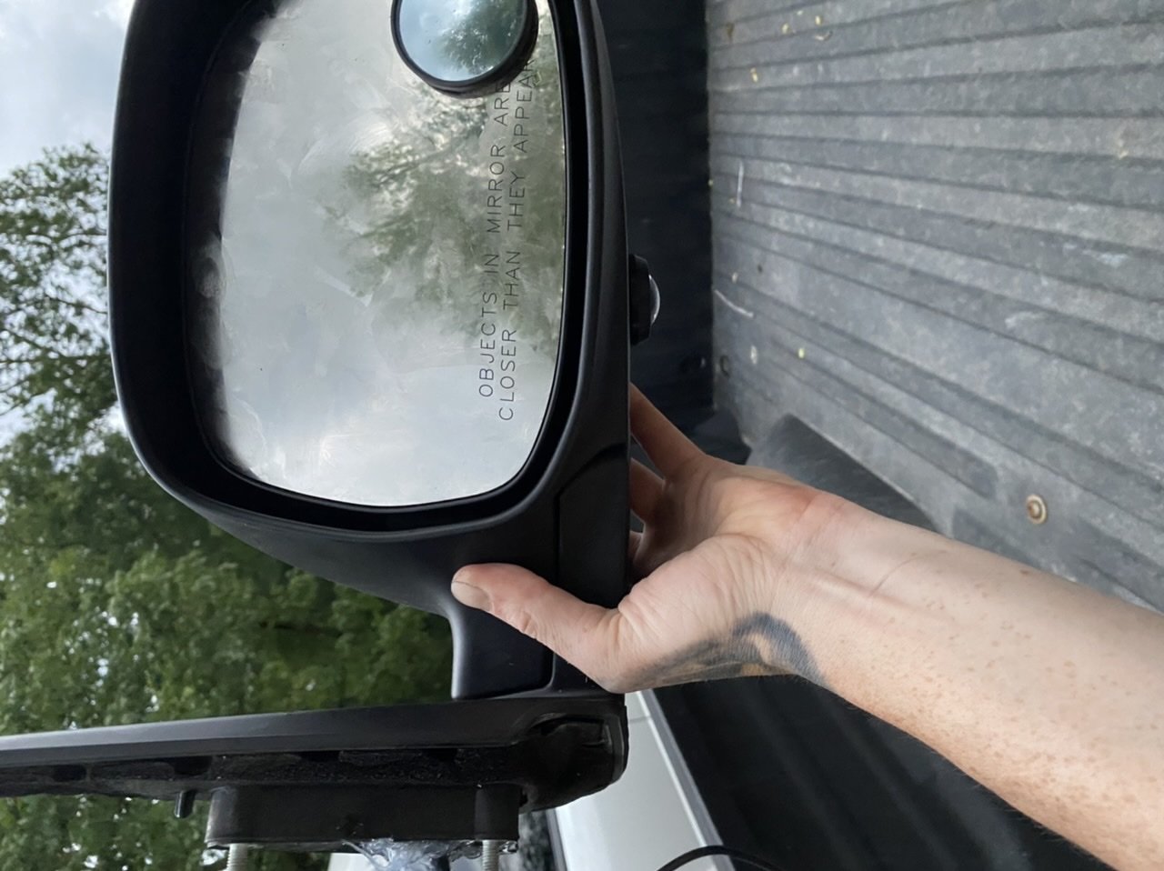

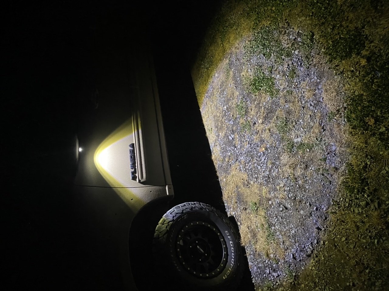

    Decided to bite the bullet and install lights in the mirror. Turned out pretty clean, spacing was off just a touch side to side. I think the step bit walked on me but it’s close. My wife assured me nobody will notice but my Ocd’ness knows it’s there. Sorry about the rotated pictures, no pc to flip em on

    Go for it, I was a little nervous drilling the mirror but it worked out pretty good. Hardest part was picking where to drill. The bottom of these mirrors aren’t 100% flat. I think I’m gonna top it off with a small strip of diode dynamics with @Professional Hand Model placement under the truck to cover my back doors.

    Nice job! I like that you reconsidered your initial job and returned for a Win.
    Having done my side blinkers inside the Mirror Assy I realize how tight it is to fish the wires through. Shoulda done the Puddle Lamps at the same time, but ain’t going back in anytime soon. :D

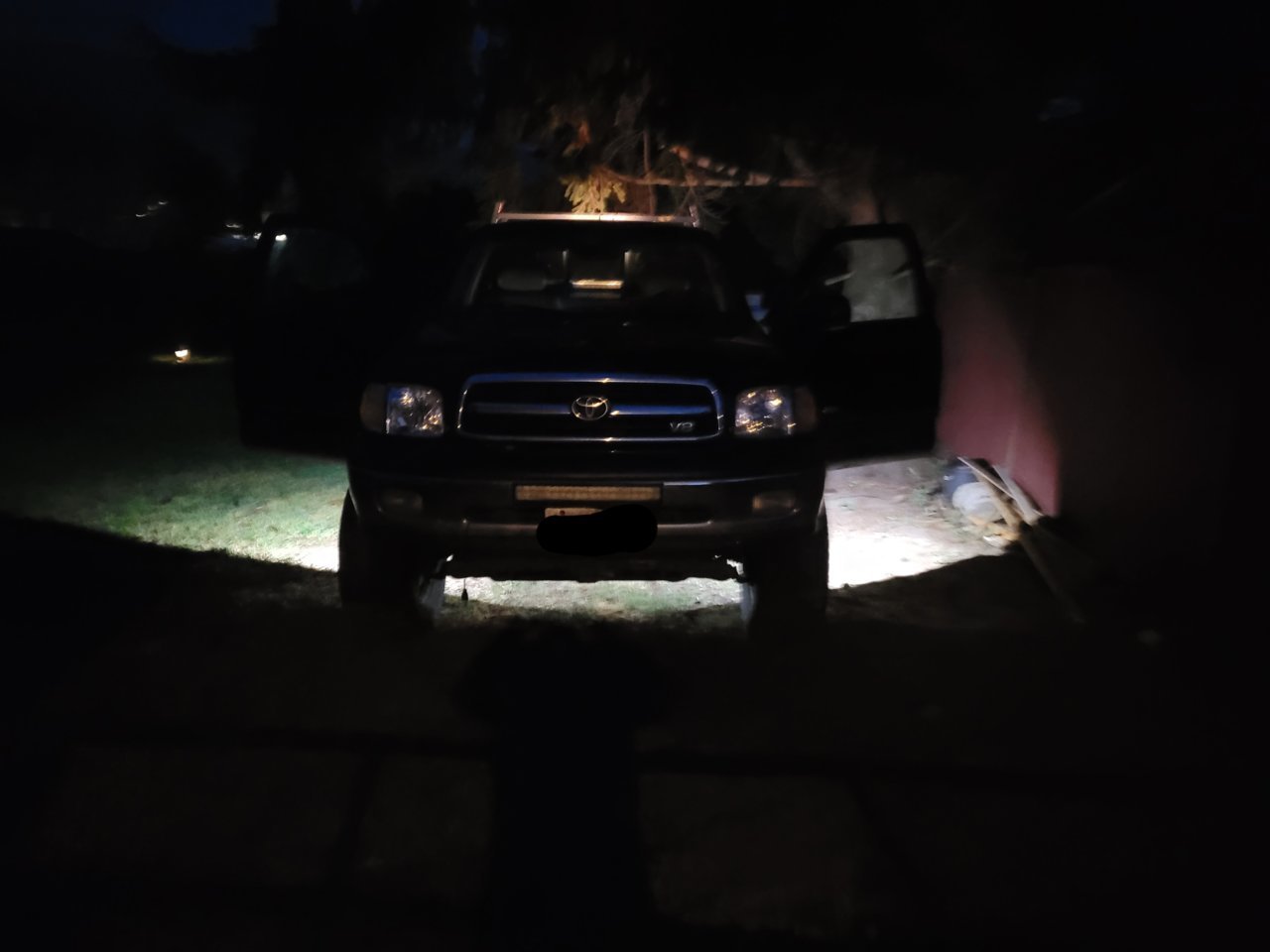

    Here is what we came up with. We placed these on a bar and attached it to the step board. Added a relay switch in the cab.

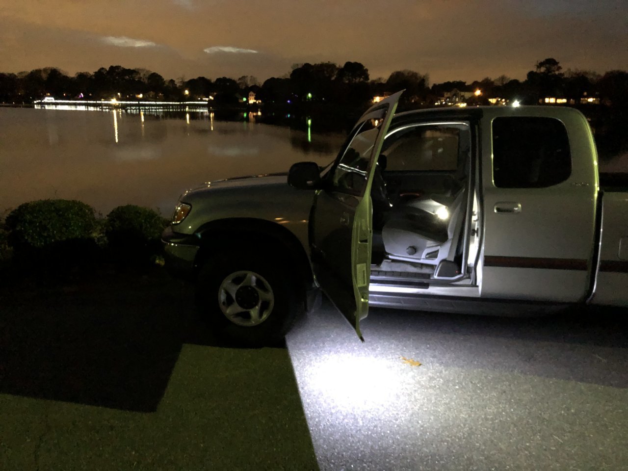

  15. Jun 7, 2021 at 3:28 PM
    #45
    abcinv
    abcinv OEM (+) Junkie
    Jan 13, 2019
    #24407
    860
    Tommy
    NW Ga
    2006 Tundra 4X4 Limited Dbl Cab
    Pretty awesome picture of the truck, the water, the city lights, etc. Oh, the puddle lights look great too.
    Nicely done sir!

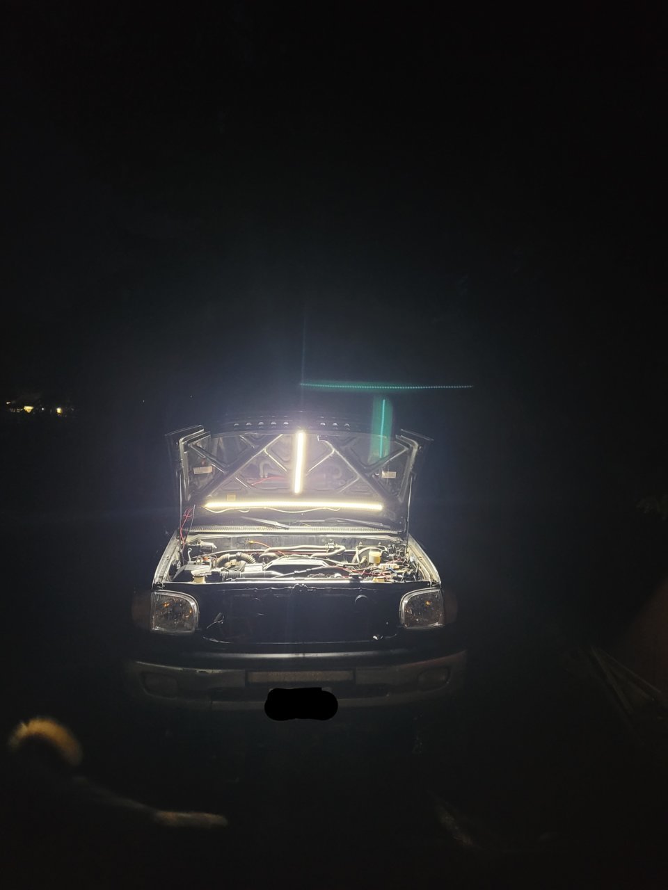

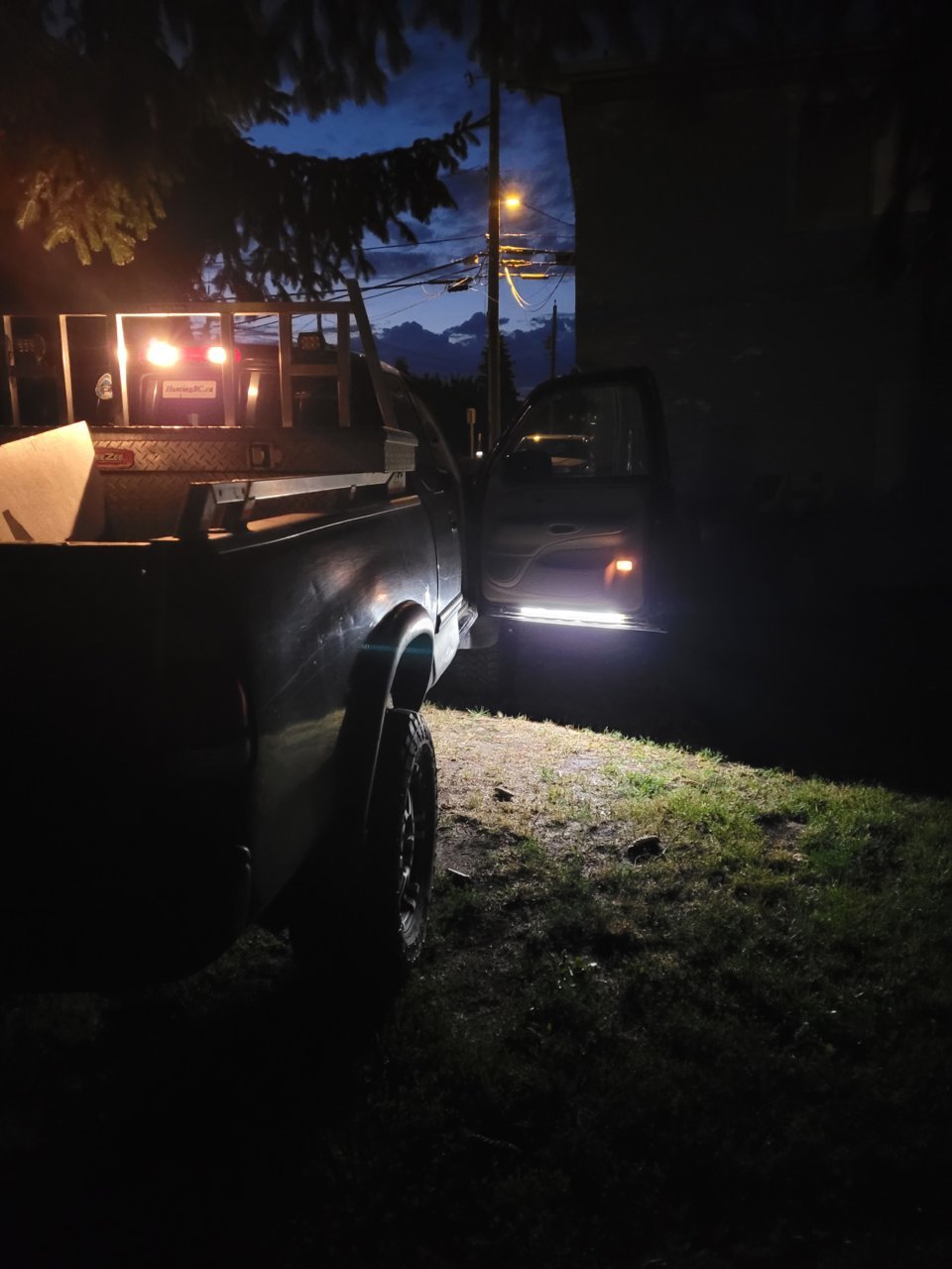

    [] Finally got around to putting the lights in. I like it. I plan on putting the under hood lights on a switch. And the left over lighting in the box of the truck
