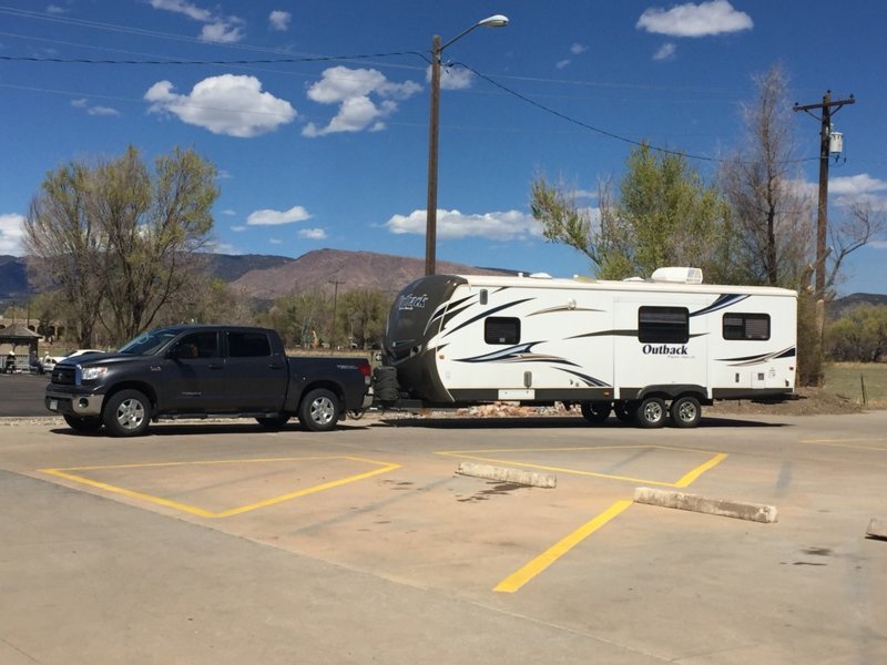

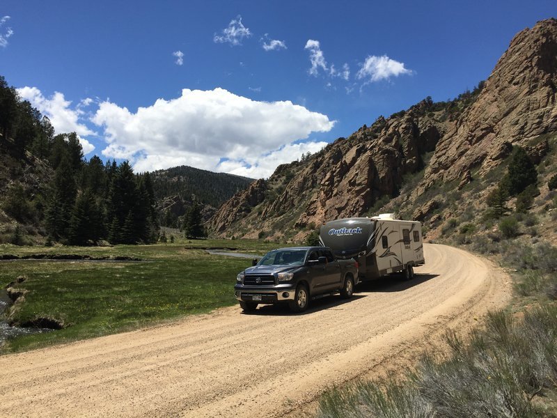

    I will say this, you are far more ahead of most people by doing the research first instead of trying to make a truck fit a camper after purchase.
    This was my 2012 5.7L Tundra and 28' camper. It was rough on my Tundra.
    Personally, and this is just my opinion you own the wrong truck. The 4.6L trucks are great for light duty work and medium towing. They don't have the power or all the extra coolers the tow package offers. Now I wouldn't pull that travel trailer with a 5.7L tundra or even a brand new 3.4L twin turbo.
    You will not be able to keep 65 mph anyway, and keep in mind that wonderful 26gallon tank that you need to stop every 120 miles to refill. (That sucks...ask me how I know)
    You will also need to have a pretty good weight distribution hitch. Not these 6-700.00 ones, but more on the lines of a Hensley...and those are 2500.00 on sale.
    https://hensleymfg.com/products/ultimate-hensley-arrow-anti-sway-trailer-hitchAnti Sway Trailer Hitch: Ultimate Hensley Arrow
    To be honest, I don't even want to type out all the reasons this is a bad idea.
    Every year I see total yard sales from campers flipping over due to losing control. Your tundra doesn't have the weight, brakes, secondary braking systems to tow that large of a camper.
    I would sell the Tundra and then see what budget you have to work with. Hell, I'd sell you my diesel (minus the King shocks) for 38k dollars. You can get into good trucks without spending 80k dollars. Then I would look for a 5th wheel camper. They tow 100% better, get better fuel economy, and have better camper layouts for sure.
