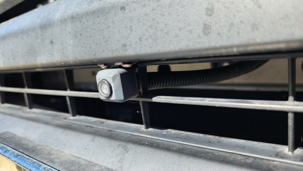

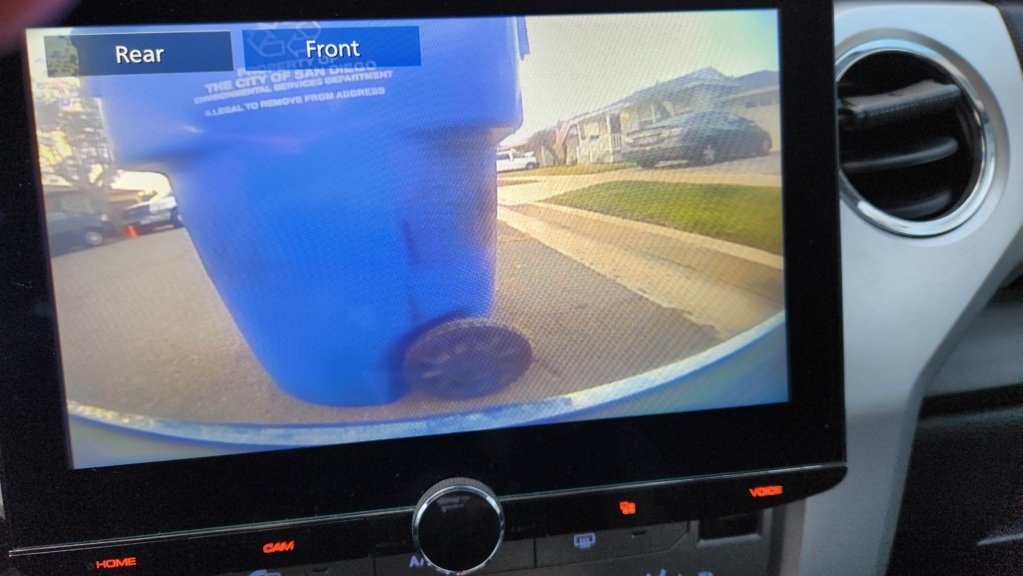

    When I swapped in the big ass Kenwood and Maestro I added a tiny little front camera, and it's a HUGE help when stuffing the big beautiful pig into tight spots.
    Programmed one of my steering wheel buttons to bring it up when I press and hold the UP arrow.
