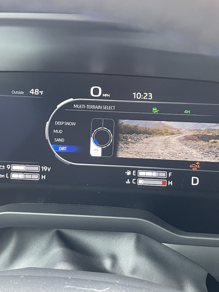

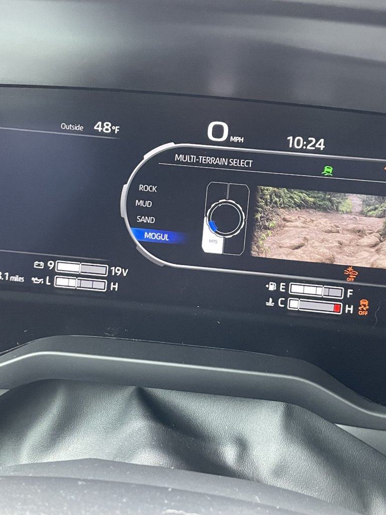

    Exactly same thing I felt and heard when switching between modes. Just did it this morning.
    I had to take the center console all apart though. The cord/connection would not give much at all. I’ve had it apart a bunch to install the Limited on down center console and then PPF so I might have routed things incorrectly when putting it back together..
    You get 8ish total new modes (four for 4H and four for 4L). I thought it was just 4 so that was a nice surprise.
    I also bought mine via Fred for $131 I think.

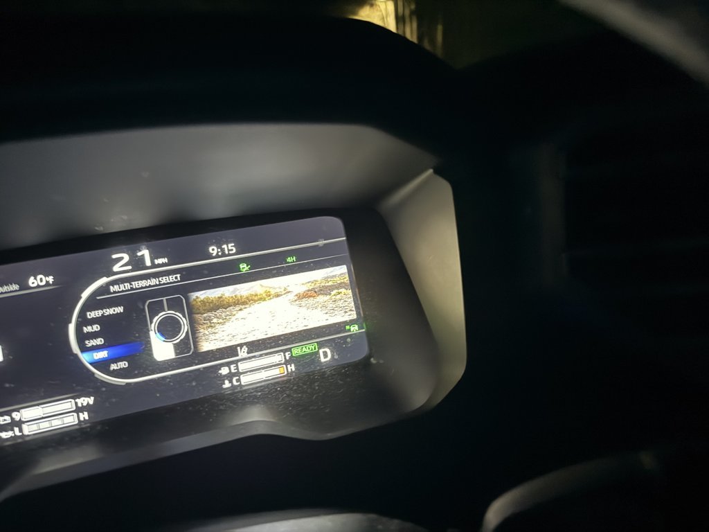

    So I just got 84970-0C010 and installed in a 22 tundra platinum hybrid.
    drive and tow light light up when pressed , Mts and crawl have no lights when I press button. All 4 button runtime lights are lit when headlights on. I’ve tried 4H, putting the car in gear (haven’t driven it in 4WD shifted to drive in my driveway) and nothing
    not sure why
    I have panoramic cams, avs, load leveling. It’s likely the avs or load leveling will not work?

    update, no idea why as I had restarted previously.
    MTS function Working fine on my avs/load leveling 22 platinum hybrid now. I do not have the TRD OR package.
    Weird, but I can confirm it works!

    Ok, figured it out. You cannot switch into MTS unless you are in 4WD and MOVING! I originally tried in gear but not moving. It will only switch into it when in motion. Crawl does nothing and will not switch on
    I have not tried to confirm it actually does anything other than look pretty
    Again: 22 platinum hybrid non trd. Have avs, load leveling air, and birds eye cameras all around. Switch was super simple and I was able to switch it without taking console out and even without removing 4x4 switch for help with the REALLY short plug!
