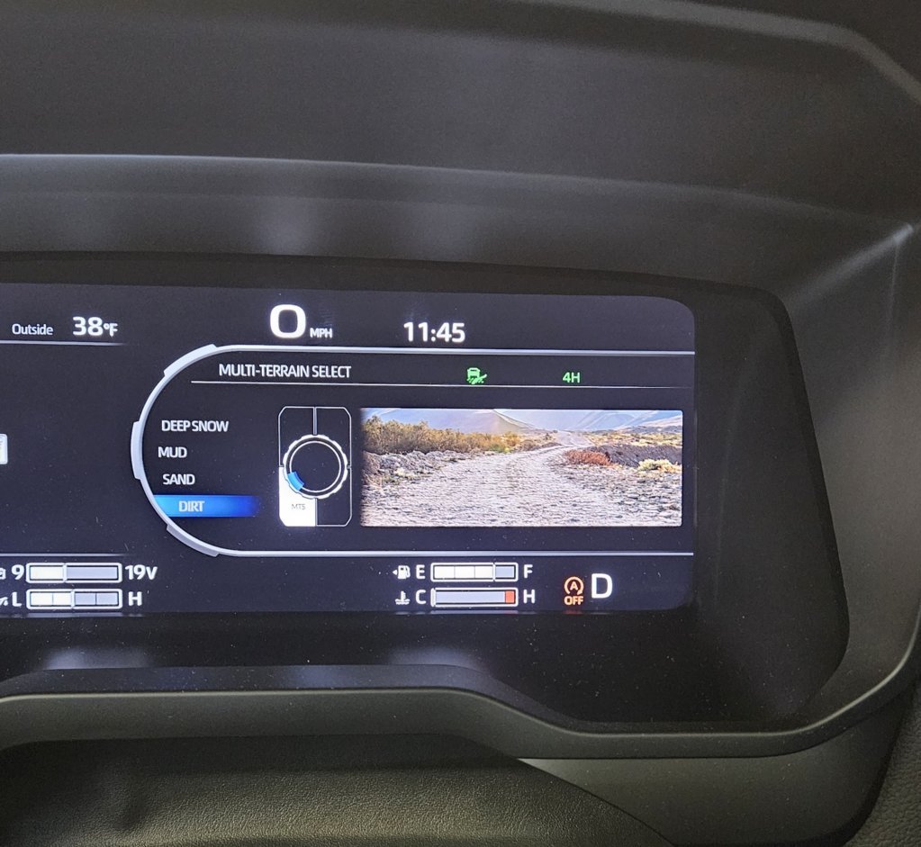

    I removed the side panel, but it didn't help much, I just used a plastic trim tool & pried switch straight up, it popped out easily, just that short wire is a pain to deal with.

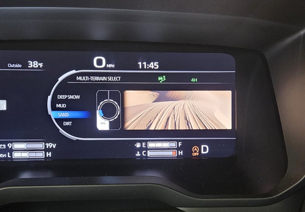

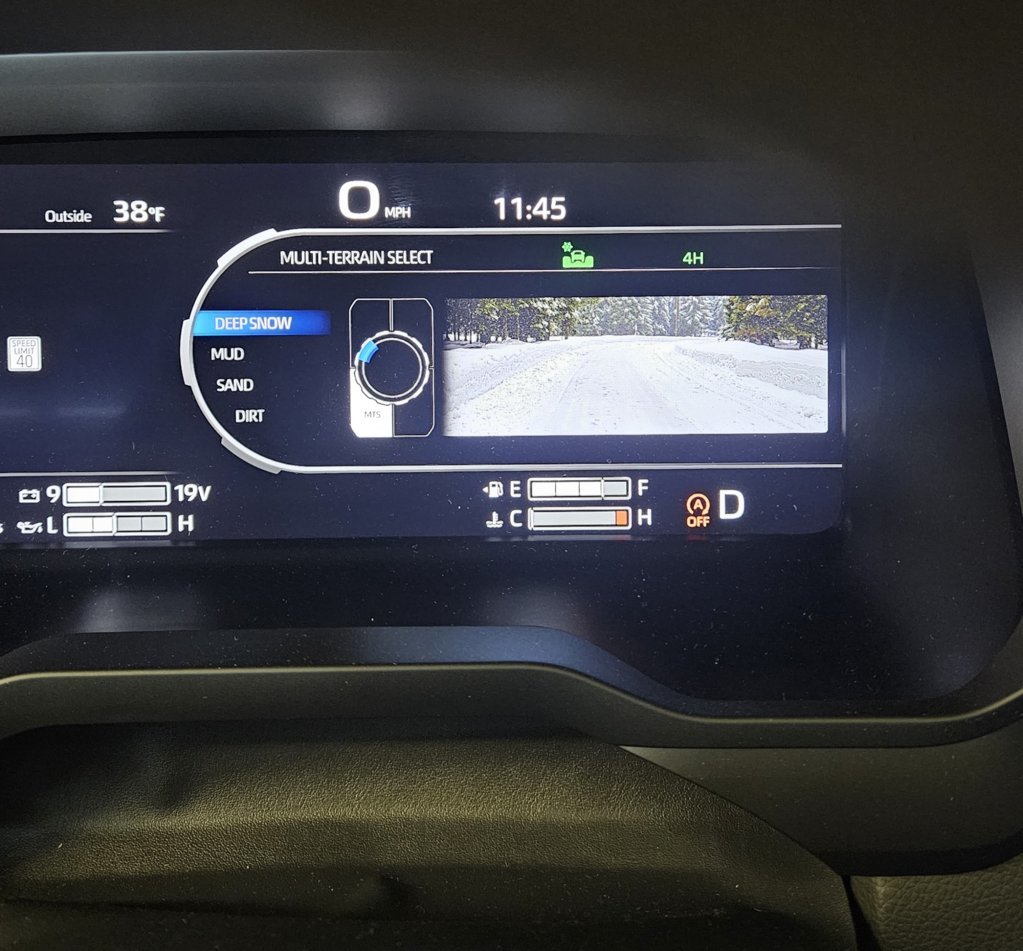

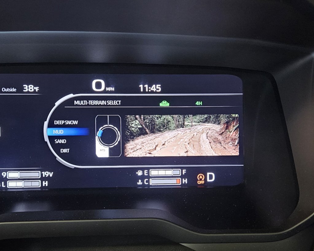

    Plugged mine in today. Worked for me as well. Limited hybrid 4x4 with PVM. For $175, you can basically handle 95% of trails near me. Sounds like a good deal to me. Assuming the trucks that have 4x4 w/o off-road package sit in the automatic range of the MTS, I don’t see why the MTS wouldn’t work. I noticed a difference just on the loose pavement going around my neighborhood. Can definitely feel a change in acceleration going from snow to dirt. Now to do more research into adding the crawl function .
    Also wanted to add that I just removed it straight out of the center console. Took a minute to plug the new switch in. Not too difficult. No scratches on center console. I have the matte cover as well.
