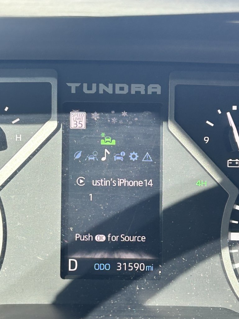

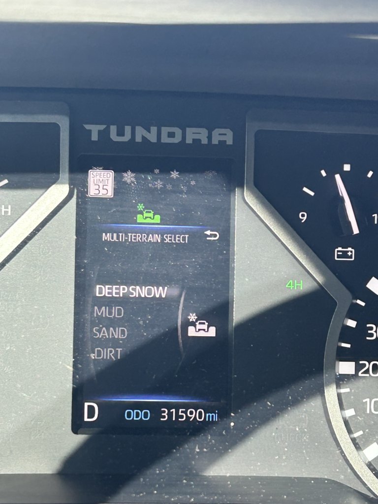

    it did, yes. Let me see if I can find out how to post a pic. I have a 24 SR5 with the upgraded softex seats and PVM. Standby, will try and post here soon.

    IMG_4856.jpg IMG_4855.jpg Ok, here is my 24 SR5 I put the switch in, and that’s it. Now able to get the MTS modes in 4H and different ones in 4L. Here is what the screen looks like when selecting…

    Thing I was really after was adding MTM to my PVM enabled SR5. If anyone figures that out, I’ll be super pumped! My truck had all the cameras and has the pitch & roll data, so the fact that it isn’t there drives me crazy!

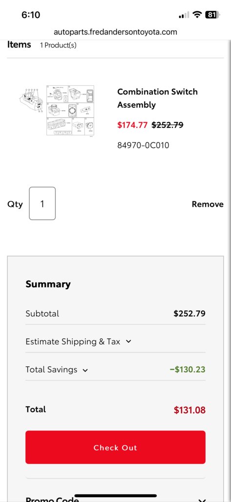

    Just an FYI there is a new part number for the 4wd Control computer:
    I wonder if this newer part would change anything?
    With the current parts deal the switch is $131.08 and the new 4wd control computer is $298.61. I may snag the switch at that price for my 2024 Platinum. Hmm...

    Where is everyone finding the switch for $131?

    I couldn't find it for that. I paid more for sure.

    2024 Toyota Tundra Platinum LR
    Fred Anderson online for me.
