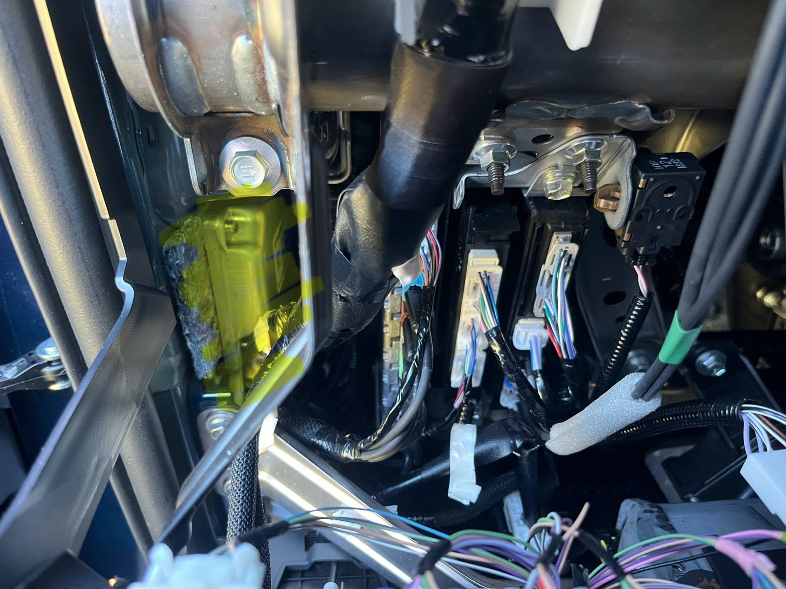

    After doing some research this morning I've come to the conclusion this is not easily possible. As the OP mentioned, there are two TC Control Modules: 895330C091 (TRD Pro and OR packages) and 895330C101 (non-OR). Given the inconsistency in reports for those with a non-OR package, swapping the switch alone is not likely enough. MTS disables traction control and VSC in most if not all the MTS modes and no one has been able to confirm this actually happens. The only thing folks have reported is the MTS selection screen.
    I was curious, though, if some TRD non-OR vehicles may have the OR TC module. As a I have a TRD Sport I took off some dash trims and checked the part number. No such luck - I have 895330C101
    While its a few hundred dollars for the OR version of the TC module, it is not easy to get to. I attached a photo I took this morning. The control module we are interested in is highlighted in yellow. You would need to remove all the trim in that area and find a way to disassemble the entire metal frame of the dash to access that area, then remove all those other control modules before getting to the the one we are interested in. Apparently, the Gen 1 Tundras had the TC control module under the front passenger kick panel and was super easy to get to. Not our luck.
    I applaud anyone else willing to experiment more with this but I'm no longer optimistic this is possible. Hope I'm wrong.
