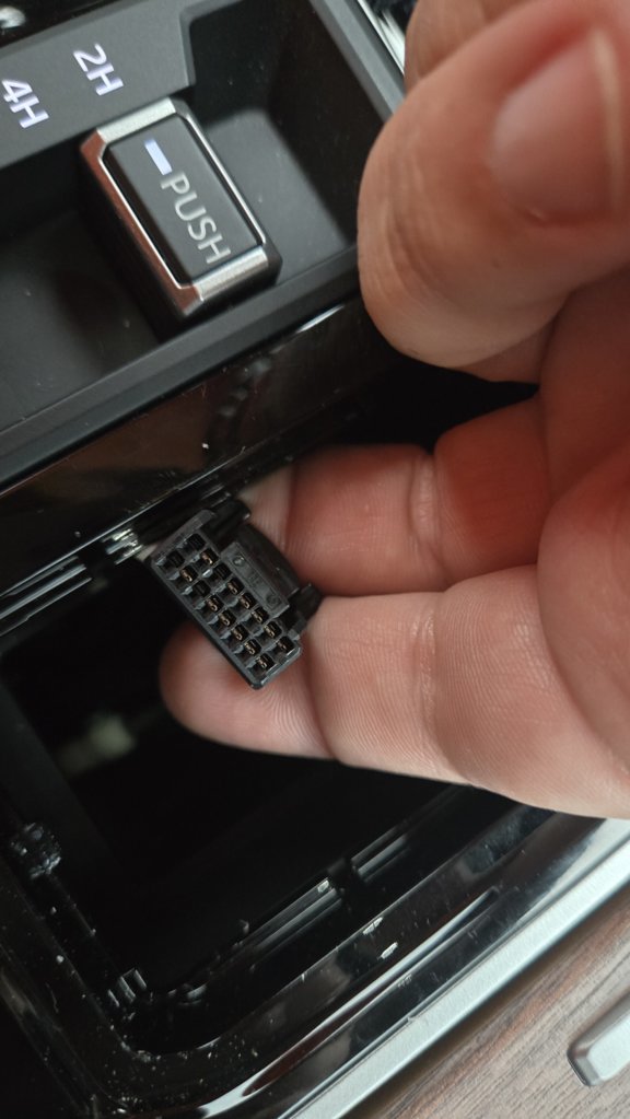

    Great summary. I've got some pics ready to send on the wiring for my harness that the MTS worked with. Hopefully this will add to some help on this thread and for @chrisgibbs707 with his rig. I'll try to upload tonight when I get some time.

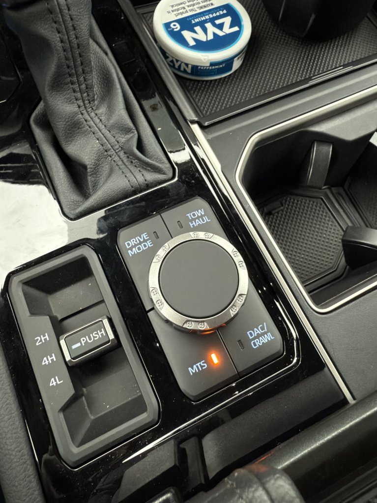

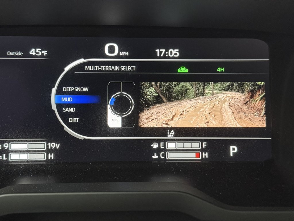

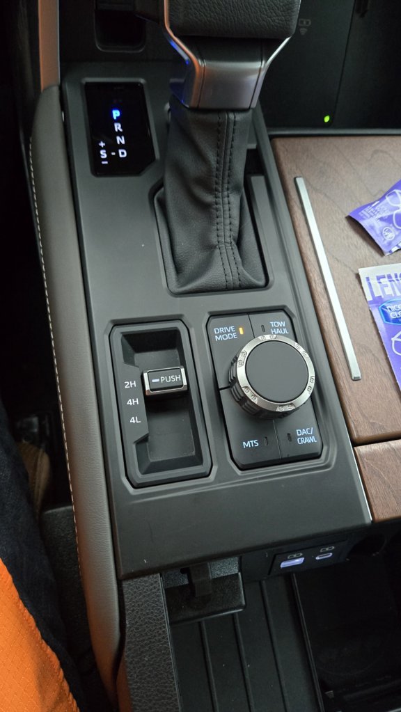

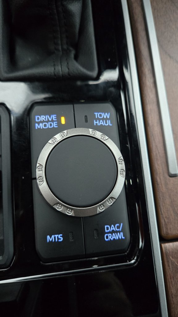

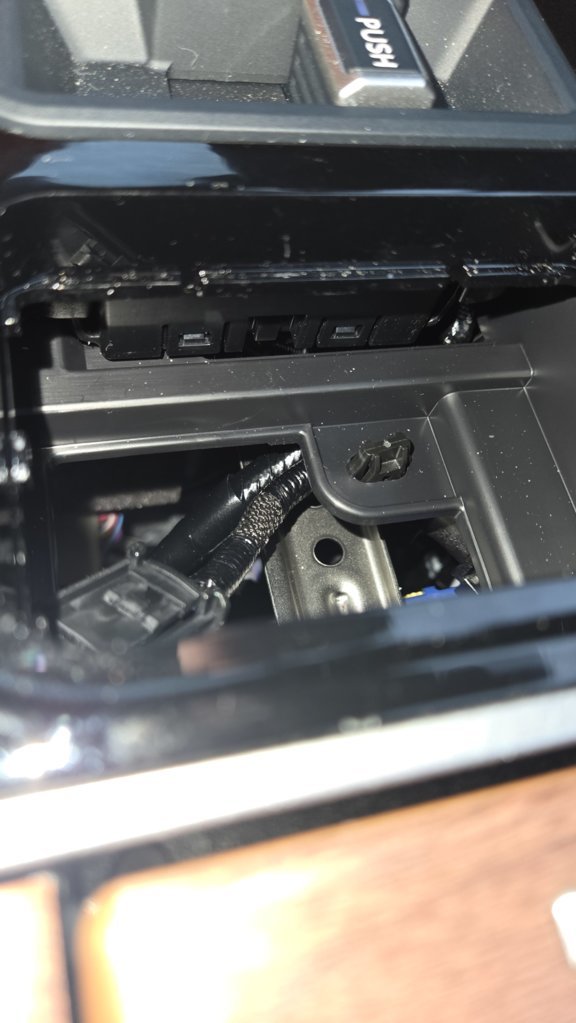

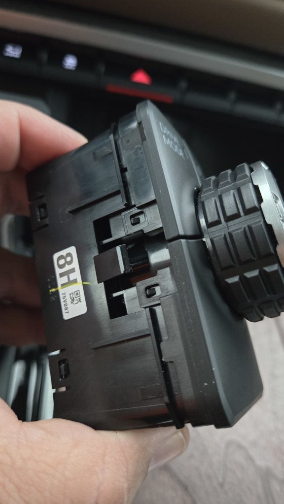

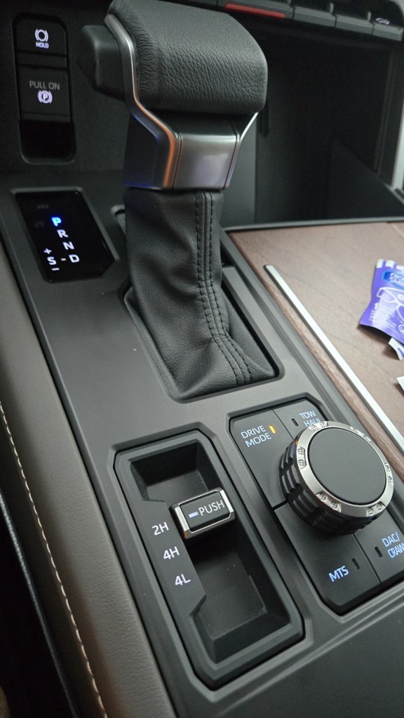

    Well, add mine to the list of working:
    I can honestly say I believe it to actually be affecting things within the electronics of the truck. As you move through the modes, certain ones will disable VSC and PCBA. Truck still has 700 miles on it, so I'm not going to go adventuring just yet and really, it's a pavement pounder.
    Pulled Original Switch
    Cable
    Installed (lights on to show text illuminated)
    Video (onedrive link) of it working:
    https://1drv.ms/v/s!Agi0uKAi5W42peUD9eEqmDvIhT1QjA?e=fJPMBy
    Added matte cover:

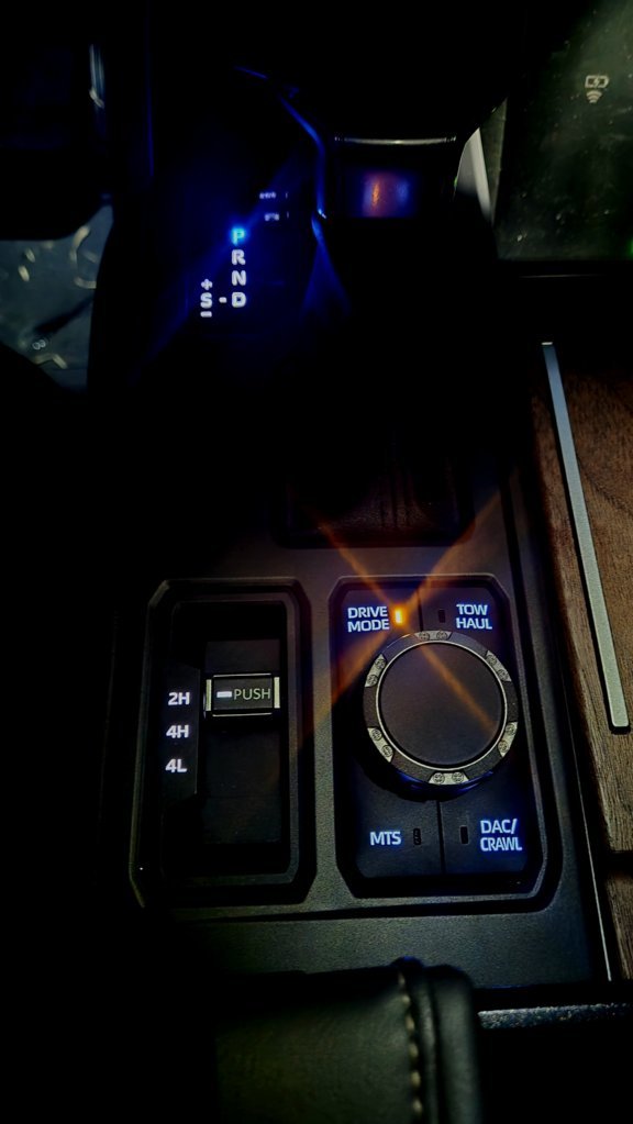

    are the buttons being backlit? The actual words on the button? I’m realizing mine doesn’t do this at all. In fact I don’t think my 4WD selector is backlit either.
  14. Apr 2, 2025 at 6:02 PM
    #344
    KMAGS
    KMAGS New Member
    Mar 24, 2025
    #132437
    15
    Ken
    STL MO
    2025 iForceMax 1794 Lunar Rock
    Heads Up | PRBs/TG | Tow Mirrors | X4TS Cover
    The only way I can think of is to have those rollers that people test 4x4 systems with, I've seen on multiple reviews.
    Trying it out with different modes, would be that proof.
    Yes 100% they are backlit, but only when my headlights are on (as other dash lights - light up - those do too).

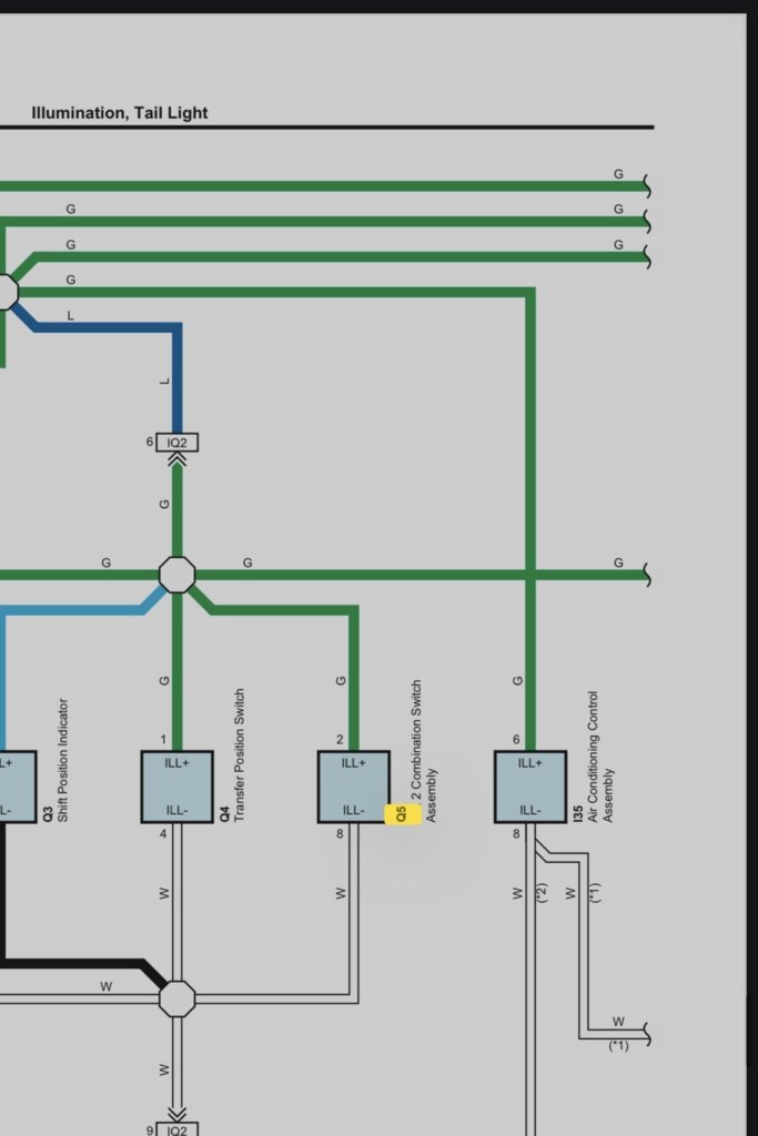

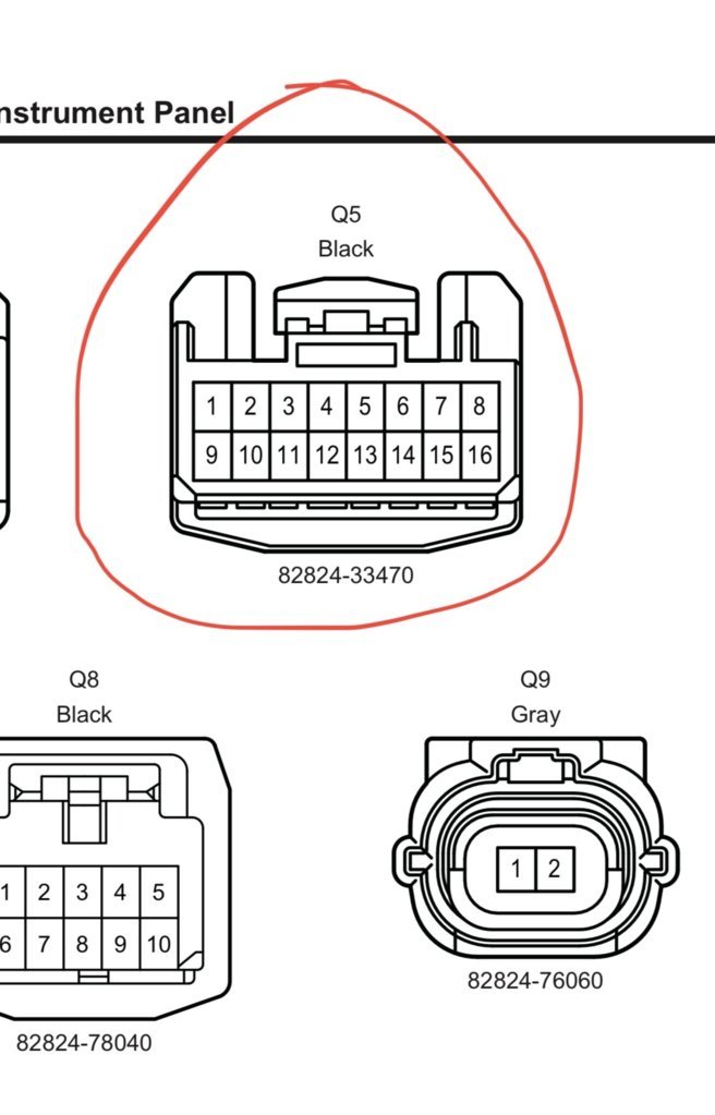

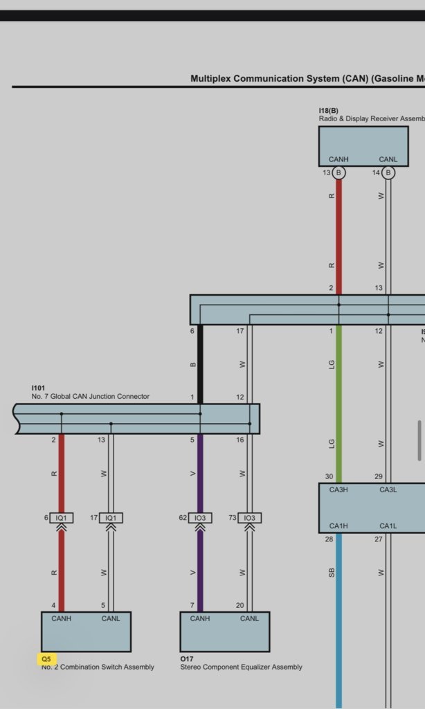

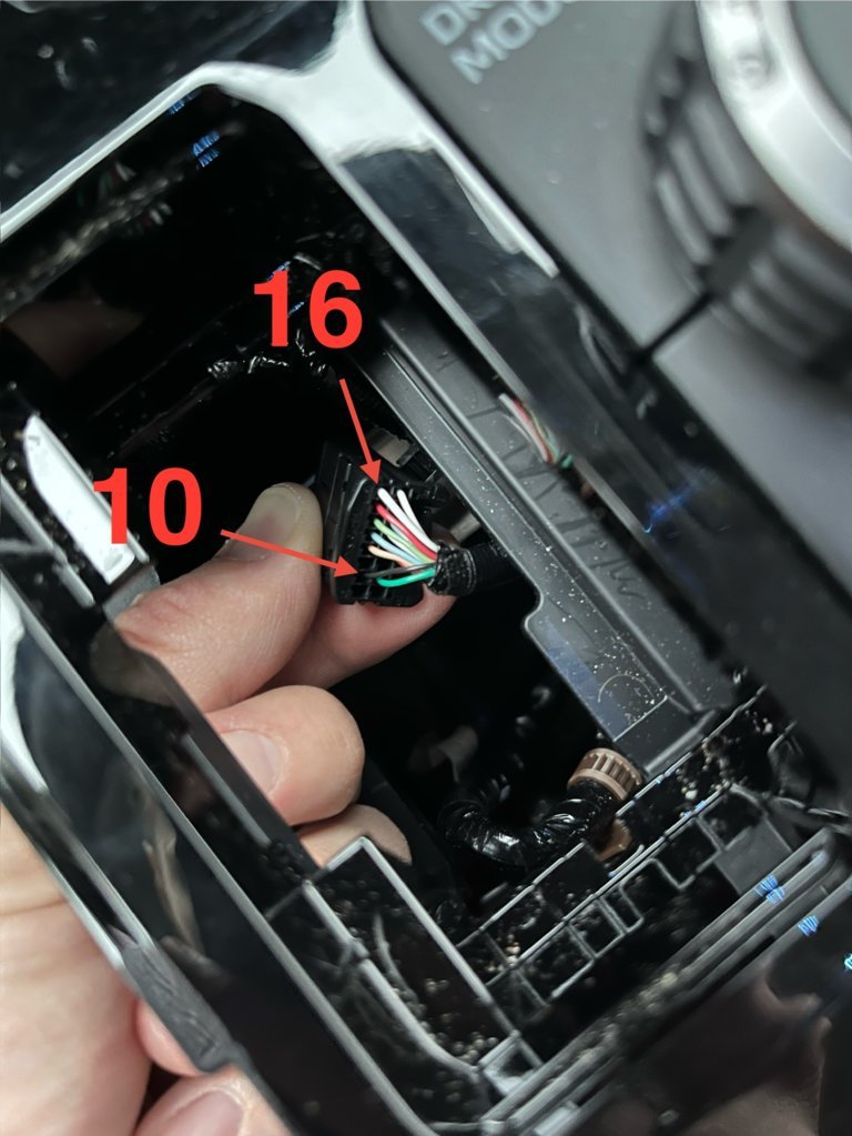

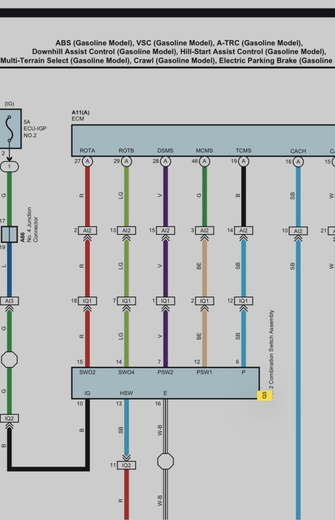

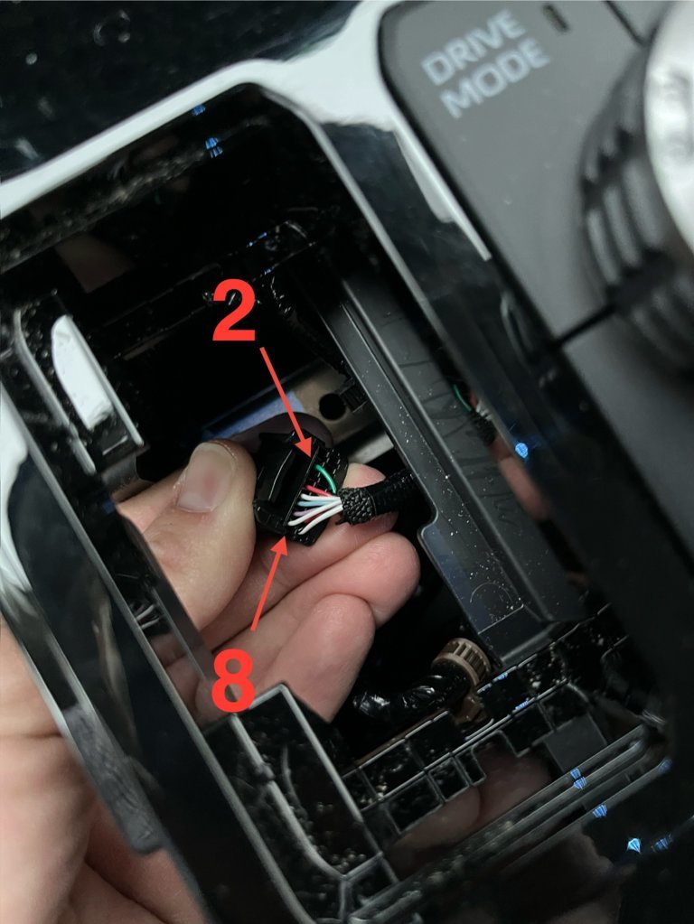

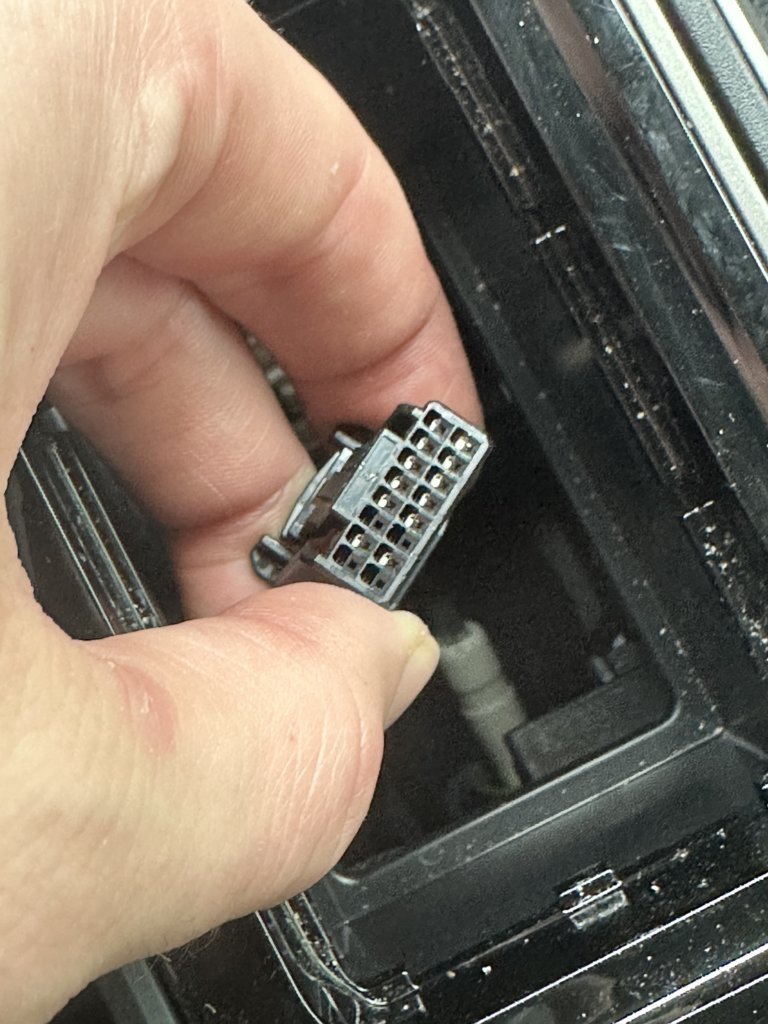

    Okay, this might be a lengthy post but hopefully it helps. My switch works from the swap and I’ll explain what wires I have to help identify why some may work and others don’t.
    the connector is Q5:
    You have to read the harness wires backwards from what’s above for the receiver in the switch. Here is the top row for mine. Have to read it from right to left in the count. Mine starts with green in #2, then I have wires occupied in #4-8:
    Then the bottom row reading from left to right (I flipped the harness connector end for end for the pic). I have a wire in #10 then #12-16 are occupied:
    So here’s what all that means:
    #2 - ILL+ or Illumination +
    #4 - CANH or Canbus high
    #5 - CANL or Canbus low
    #6 - P ??
    #7 - PSW2 ??
    #8 - ILL- or Illumination -
    #10 - IG or Ignition switched
    #12 - PSW1 ??
    #13 - HSW ??
    #14 - SWO4 ??
    #15 - SWO2 ??
    #16 - E or Earth/ground
    Now if someone had a dictionary as to what all the abbreviations mean that would be awesome lol
    Blufin, chrisgibbs707 and ziznack like this.

    So in other words, my harness has all these wires that are called out for this connector in the circuit diagrams. I suspect some of those that this switch doesn’t work with are missing some wires in their connector. Most likely the Canbus ones that do the communication.

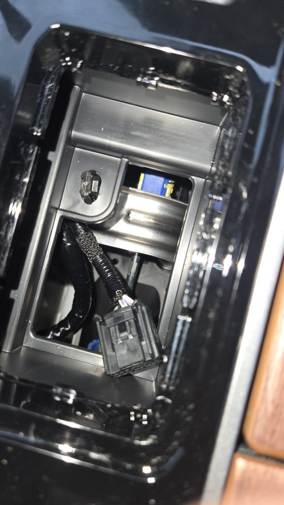

  17. Apr 2, 2025 at 6:16 PM
    #347
    mikewantsabeer
    mikewantsabeer New Member
    Jan 22, 2025
    #129257
    41
    Pacific County, WA
    2023 Tundra Limited
    looks like my harness matches (visually at least)
    chrisgibbs707 likes this.
  18. Apr 2, 2025 at 6:18 PM
    #348
    60centenergy
    60centenergy New Member?
    Jul 26, 2024
    #120421
    272
    Zack
    Greenville, SC
    2024 Lunar Rock SR5 Tundra TRD Sport
    Interesting. It does look like the pins are there like I have in mine. The plot thickens…

    Also, for those wanting to figure out DAC/Crawl mode, I am guessing the answer is somewhere within the circuitry from pages 11-18 in the 2022+ circuit diagram pdf. That’s the whole section for the gas engine DAC/Crawl wiring (among other things).
    If it’s not a matter of missing wires or modules, then it’s some kind of programming and if that were the case then I have no ideas on how to activate it ourselves.

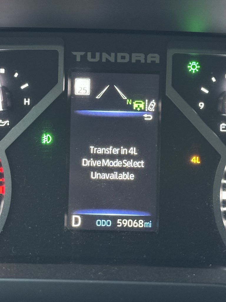

    I lied, my stuff is backlit. I put it in 4lo too and noticed it yelled at me for drive modes. But pushing MTS button is completely unrecognized. Oh well.

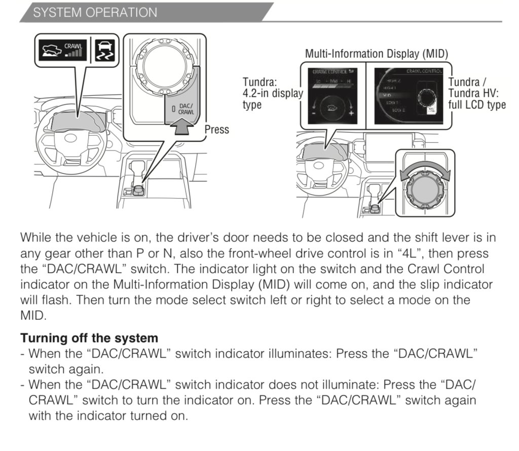

    so my buddy has the trd offroad and when he is in 4L to get the Crawl to work he has to turn his locking differential on. I was going to do this to my platinum, don't know if it's worth it for the MTS, I mean the drive modes look cool and all.
    KMAGS likes this.

    Very odd. Not on my ‘23 Lim TRDOR. Think about that for a moment. If you locked the rear axle then Crawl would not work across the rear end. It’s whole purpose is to modulate all 4 wheels independently to get maximum traction out of the wheels with the most grip.
    mikewantsabeer and ziznack like this.

    No mention in the manual of locking the rear end. *BUT We may have found why some say adding the MTS switch say it didn’t work for Crawl. - Drivers door must be Closed, Xfer case in 4L, must be shifted into D or R. Doesn’t come on in P or N?
