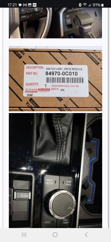

    To summarize the 10pages before this post:
    This is NOT a 100% solution. There are some SR5s that this isn't working for them.
    It looks like Limited and up - this appears working for most.
    WORKS:
    Only the MTS system will get enabled by this switch swap and those only show up in 4H and 4L - 4 modes on each. From some other posts, some mention you CANNOT turn on MTS while stopped even in 4H/L - you need to be moving.
    Hard to confirm, but many have stated it's affecting their trucks (throttle, abs/traction).
    DOESN'T WORK:
    Crawl does not work - it looks like something is missing, some ECU - no one is sure, no one has that working.
    This appears to NOT add the 'under the truck' camera.
    People have tried looking to see if it's the rear diff-locker - but to no avail.
    People have replaced some of the ECUs - but to no avail.
    Correct Part Number: 84970-0C010
    (Don't accidentally get others as variations of the same switch are out there as 84970-0C020 84970-0C030)
    Dealer that will ship for free, and appears to be one of the lowest priced:
    Combination Switch Assembly #84970-0C010 | Autoparts.toyota.com
    In time someone may figure it out more...

    Here is a picture of the actual part from the very first post on this 10 page marathon,I honestly do not understand the confusion :facepalm:

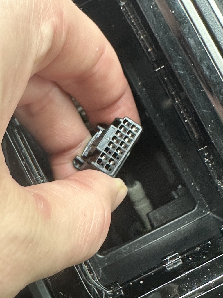

    Welp I’m about to give up. Switch arrived and installed today in my 23 Limited. Only drive and tow modes working.
    remembered I need to be driving per someone else’s post. Went for a drive, put it in 4hi, nothing.
    currently resetting computers via battery disconnect but I doubt it will make a difference.
    Very odd that mine would be any different than other limiteds that have had success. Only thing unique on mine is the factory load leveling air bags

    Just asking to ask - did you try to enable MTS while stopped? while moving?

    Have done both. I’d be curious if someone who has it working could take a picture of the plug in like mine attached? Clearly missing 4 pins, wonder if the others look the same or not.

    I’ve exhausted my options. Have tried about everything. Took the center console apart to make sure the plug is fully seated. Reset ECU via battery disconnect. No luck.
    If anyone wants to take this off my hands, $130, i can ship.
