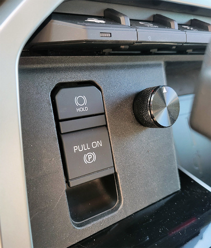

    Just a quick post with my take on mounting the control nob, and to let you know that instead of taking 1/2 the rear apart to get to the OEM subwoofer's wiring/etc, you can pick the same signal wires right in the bottom door sill wire loom. 2 twisted pairs of those black/gray+green/brown wires; easy to split open the protective wrap, then tap.

    I like what you did with the control knob. I still have mine sitting loose in the center console because I haven't found a mounting spot I'm happy with. I do find the output a bit underwhelming though. Considering adding another Kicker unit.

    I couldn't find a good spot for it, and Kicker's original design seemed unnecessarily bulky.
    Thought this would be a good place for it, and my 12yr old agreed. Always trust a pre-teens opinion.lol.
    Took it apart, took the console apart a bit, and found there is enough space there to drill+mount as you see.

    Didn't like the Kicker plastic knob.....so a few dollars later and a visit from Amazon fairy, and we have this end result:
