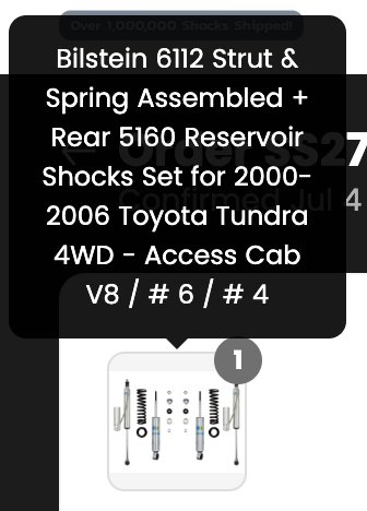

    Hey Tundra people, long time reader first time poster. I have found many answers to my question, many different answers, but no first hand experiences.
    Have you, or someone you know, installed Bilstein 6112 front struts (part#47-310049) on a 2000-06 access cab? 2wd or 4x4 doesn’t matter to me. I want to know what clip setting you used, and lift gained. A picture would be great too.
    on Bilstein’s website they say not to exceed the #6,#4 clip position on a 4wd v8 access cab. They also say that the max setting #6,#4 position will only allow 1” of lift- but that the same setting on a double cab will provide more lift. I don’t understand how that works with identical struts and a heavier cab. Looking for first hand experience and real world numbers. I just want a good 2” lift that is a decent $ to performance ratio, need to fit 255/85r16 at4w tires under it. Hunting in Montana the roads get really rough but I won’t be rock crawling. There’s aren’t any 6112s in stock, no you can’t buy 255/85r16 at4w’s yet, and this lift isn’t even for my current truck. Hoping to sell my 05 2wd and buy a 4x4 soon, love it but need more tires to spin.

    Well. As @Shifty mentioned....make sure you read up beforehand. I purchased a set of 6112's from a Jeep shop NIB for around 560-$600 shipped just to find out Mr. Billy does not recomend or warranty use on RCLB applications.
    I messaged @shifty` about this and we speculated weight or maybe Billy did not due R&D bc not many RCLB V8 4X4 SR5 where sold?
    I finally emailed bilstein and they said :
    "Standard cab and AC cab vehicles have a shorter driveline then DC and encounter suspenion and driveline suspension and geometry issues quickly when lifted. "
    ** please note this is just off memory, i did send shifty Bilsteins email too. But this was their (billy) justification to limit to 1" of lift on non- DC body styles.
    Now , i personally think its a weight or clearance with spring to factory UCA thing as the 6112's are beafy. I have spoken to two shops that have installed them no problem on 2002+ RC and AC and both stated to use same circlip unless DC and that 05+ DC (crew cabs) have more weight on fuel tank side. I was told for RC and AC #2=1", #3=2" and to not go any higher without aftermarket UCA or clearance could become issue.
    * please note this is all non-first hand experience , but a few guys witg AC and RC do run them on here and dont post a ton. If I could sell the 6122's i would prob go toytec. But have come to like to KYB ride quality for my use. The whole lifting IFS thing and different circlips is weird to me as well, but, plenty of people love them. Sorry for long post.
