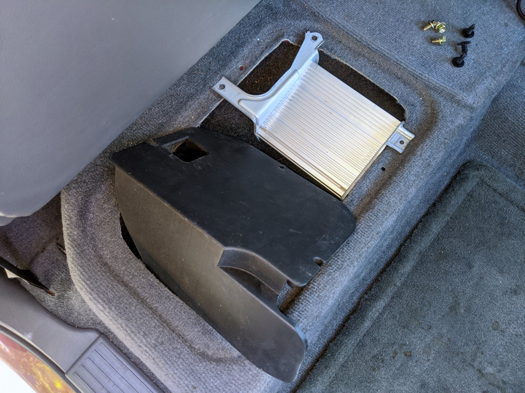

    Trying to help one of our Tundra brethren with getting their factory amp correctly re-mounted in the pocket under their rear passenger seat. Can someone who still has theirs intact (or has pics of it installed) please post up pictures of how and where it's mounted?
    I swear it was mounted up underneath the dark grey carpet in that under-seat pocket, but ... stupid me, I love pics like @bmf4069 but I apparently failed to take any pics of mine when installing my Q-Logic box.

    Bracket is tucked under the carpet edge, shown laying above it for reference. The plastic cover goes over the carpet edge. The 10mm's pictured bolt the amp down, while the push pins hold the plastic cover.

    Perfect. Excellent. Thanks!!
