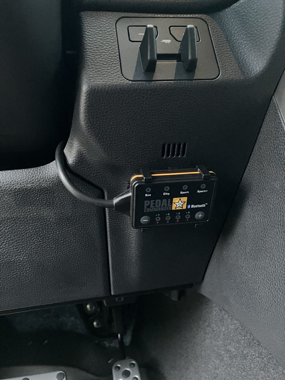

  25. Nov 13, 2023 at 6:46 PM
    #85
    Buildn
    Buildn 2022 Tundra Limited CM 6.5 Bed TRD Off Road
    Jul 18, 2017
    #8630
    954
    Medina, Ohio
    TRD Air Filters, Front door windows tinted to match the rears. Wheel locks, Talons Garage cat shield, Tyger Automotive soft tonneau cover, WeatherTech floor mats with Tuff Skinz Custom Emblem kit, Toyota OEM Emblem Black Out kit. AVS vent covers on all four doors, Red Tundra letters on front bumper & TRD highlighted in Red on front grille. Tailgate Tundra Letters in Black.
    I had the software update and still some lag. So I put in a Pedal Commander.
    Fixed. It’s plug in play, doesn’t void Toyota warranty. I leave it in City mode. Takes care of any lag. You can adjust the throttle in other modes to the point of laying a wheel and being thrusted back into your seat. It doesn’t make your truck any faster it just removes any delay or lag you get when pressing the gas pedal.
    zcardoza1, grizzy86 and 22whatwedo like this.
