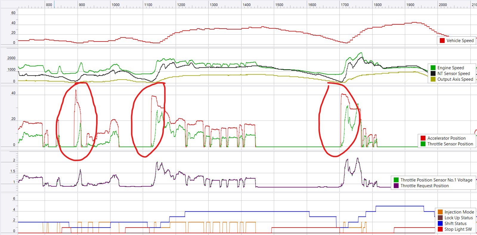

    So far in my testing I found that as you slow down to near stop, there is a downshift from 3rd to 1st gear, or 2nd to 1st gear and when that downshift happens there is a window of about 1.4 seconds and if you apply accelerator in that window its kind of ignored.
    Unfortunately you can only really see this with the dealer scan tool both the. It may be helpful if they offer to do a drive along you ask for them to bring a techstream device and watch when its downshifting.
    There are Bluetooth devices and apps that can also show the shift status pid, but I'm not sure if they update quick enough to catch this. Techstream and its VIM can read data ever 125ms, and most Bluetooth devices only report at 1 second intervals.
    I can replicate some delay with that method now, although most of the time it results in a very brief delay, but I have caught a much longer delay that lasts over 1/2 second so there may be a 2nd factor in that that is more rare.

  30. Oct 14, 2023 at 7:17 AM
    #60
    rlc177
    rlc177 Data Logger
    Jan 2, 2023
    #89650
    290
    Northeast PA
    I'm not sure the hybrids run a different logic, however since all power goes though the transmission I feel that if there is a shift related issue that both powertrains could be subject to the same delays. Try doing a few 0-60 runs safely and see if that helps wake it back up.
