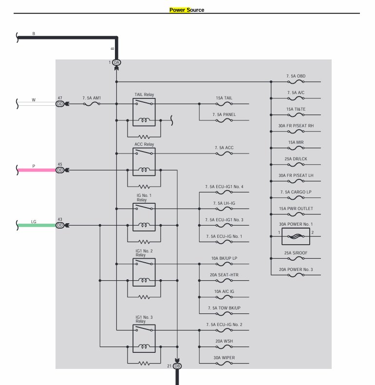

    Is the AC not blowing or not producing cold air?
    Which mirror, the outside rear view or the inner mirror on the dash?
    Looks like everything you report out is fed off the same line, but it only has the 180 and 150 main fuses that feeds it.
    It has your A/C, mirrors, windows is the Power No. 3 fuse on the bottom.
    Inner mirror is powered by the ECU–IG No. 2 fuse.
    Do the doors lock/unlock?
    Cargo light work?
    Do power outlets work?
