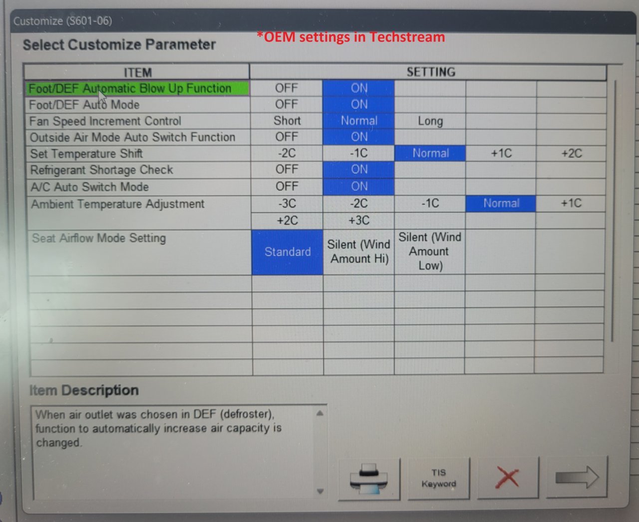

    For anyone doing this in Techstream, here're the customizable options in TS, under "Air Conditioning."
    I changed 2 things:
    -adjusted temp as all of you, by -2 degrees
    -turned OFF the automatic "blow up" function when turning front defrost ON
    (always pissed me off that the fan goes full speed once you press that button; now it won't!)

    So, does this do anything except spoof the system to make the temp is 2 degrees different, so that now when you set it at 70 it would be like having to set it to 68 before the change? If that's all it does, I don't see the point in doing it. Easy enough to bump it to whatever number you need to be comfortable. I don't care if that is 68, 70, or 62. Or does this also the blower operation somehow?

    I believe that's all it does, fooling it (and you) to think things must get colder than they really should.
    That AC compressor won't work any harder than it can, due to this change.
    It's a mind game, for those who keep their setting on "low" and now feel it's as cold as it should be. LoL

    The adjustment is 2°C or 3.6°F
