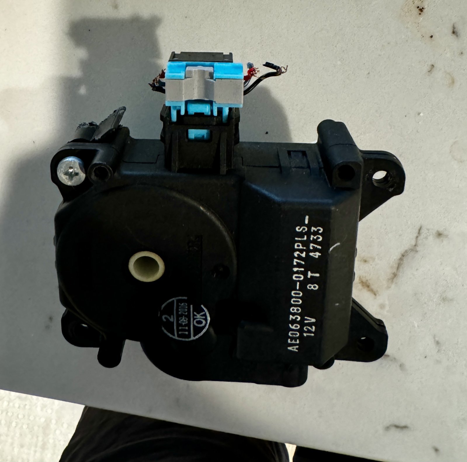

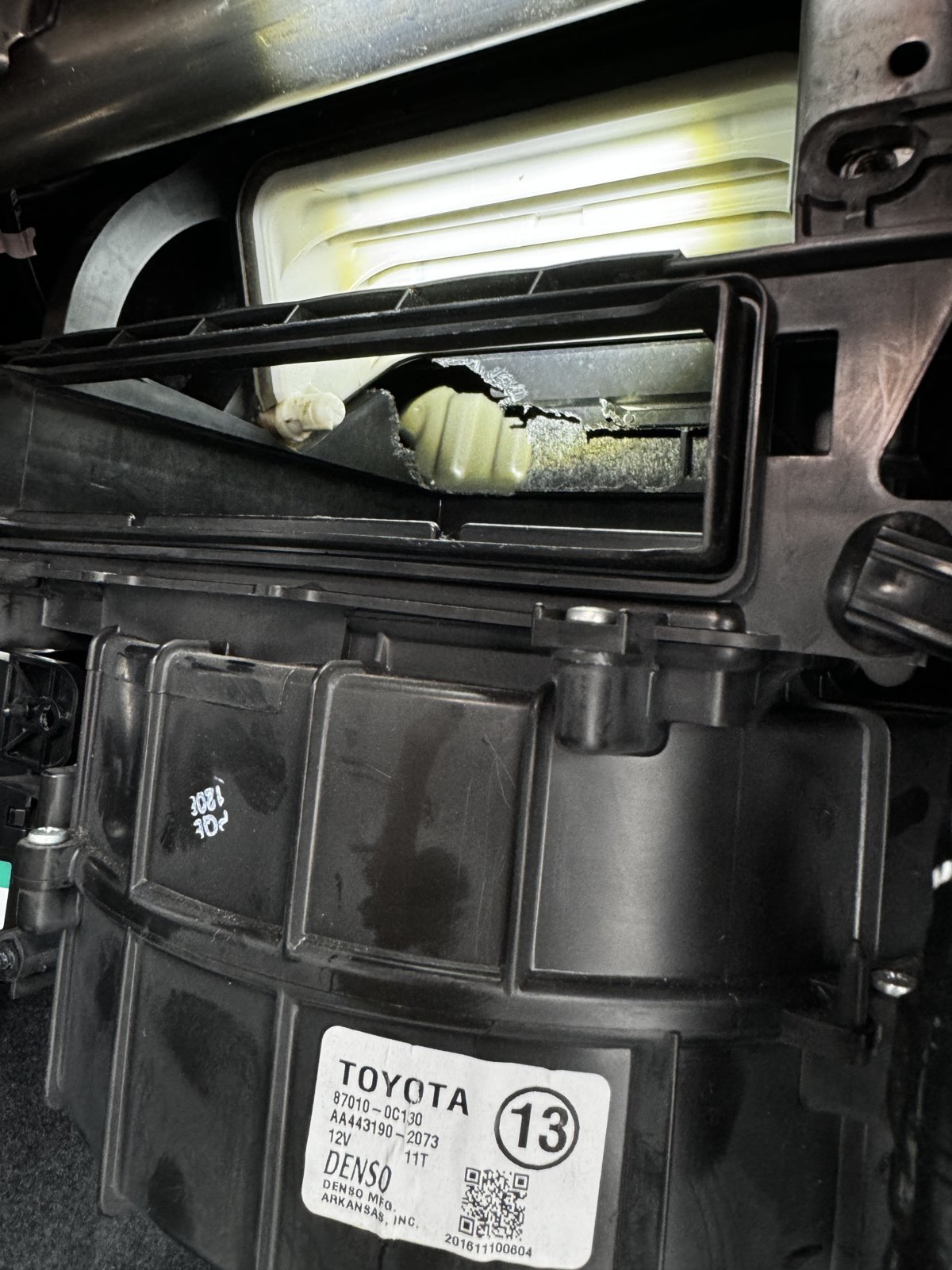

    Wanted to provide a follow-up in case someone runs across this in the future..
    After digging into the passenger side dash, it ended up being a freaking mouse. Little guy found his way down to the filter portion of the box, and instead of chewing through the filter, it chewed its way out of the plastic box!
    In the process of doing so, it chomped the wiring harness to the blend door servo in half; since the servos are daisy-chained on that harness run, with the blend door servo being the first, it killed them all.
    The icing on the mouse-$hit cake was catching the little guy in a live-catch trap :mad:. I couldnt find any evidence of the rodent still living in there somewhere, but set up a trap over night anyway as a precaution. Sure glad I did, because this mouse was HUGE.
    Photos through the cabin filter slowly for your entertainment and my pain :annoyed:
