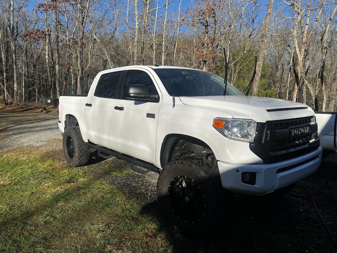

    Just bought a 2017 Platinum. The guy I got it from had it lifted (8” readylift) and 37 13.50s. I’ll probably drop it from 8” eventually. But for now, I was on a curvy road this weekend and 3 times going around a curve when lightly on the brakes, the ABS kicked in for no apparent reason. The first time I thought maybe I had hit some black ice. The second and third time were later in the day when it had warmed up into the 50s and the roads were dry.
    Is it possible that with the lift, the sway of the truck in a curve is pulling on the wires of a sensor? Just have a sensor going bad? I took it to a buddy this morning and he put the scanner on it but it doesn’t show any codes.
