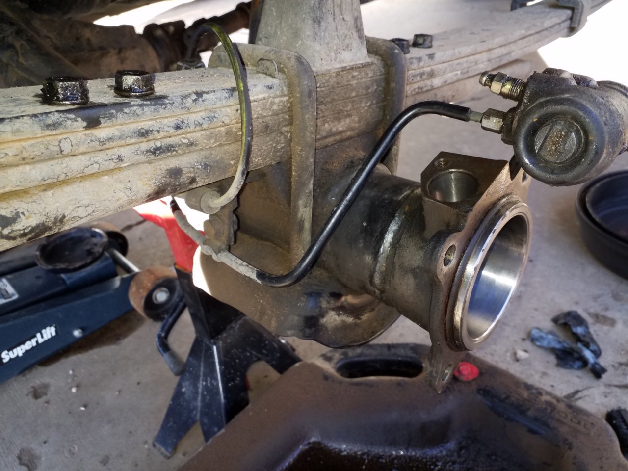

    They're right on top of the axle housing by where the axle goes in.

    If it's the front wheels, look on the inside hub. You'll see a wire bundle going to the sensor which is fastened by one bolt.
    Lastly, I still haven't had the issue return after I ensured sensor alignment in the bore. It's been over six months now

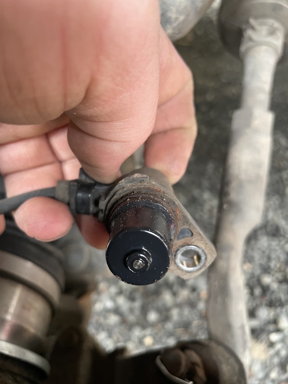

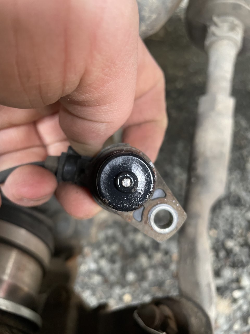

    First off, thank you everyone for your replies. I have the truck in jackstands right now. Here is the drivers side sensor (I think…it’s the only other thing that doesn’t go to the calipers). It looks decent to me. 1777A205-4436-44F3-8E2A-08DD68E5FDD2.jpg

    That's the wheel speed sensor. They are *probably* fine if you don't have the abs light on the instrument panel. When you reinstall them make SURE they stay straight in the bore. When you tighten the bolt it will tilt it towards the bolt due to it being offset. I would recommend you lightly sand the hub where the sensors attach to make the surface uniform. Rust builds up and may impact the way the sensors seat in the hub.

    I may have to take them off then. I just bolted them back in. I haven’t driven anywhere yet.

    Good news is you can easily correct a tilted wheel speed sensor without lifting the vehicle. That's ultimately how I fixed it. Just slide under there and make sure the sensor is flush but not tilted. The fastener doesn't need to be cranked down, just enough to hold it flush.
    If you still have issues I would get a scanner that can access live data and then drive and brake and watch the four graphs to see if a particular wheel speed sensor drops off line before the others do. I ended up buying a $20 wheel speed sensor from Amazon when I was troubleshooting. It did not fix it, but once I straightened the sensor out all my problems have gone away and I'm still using the $20 sensor today. I kept the OEM sensor and if the aftermarket one fails I will simply throw that one back on.

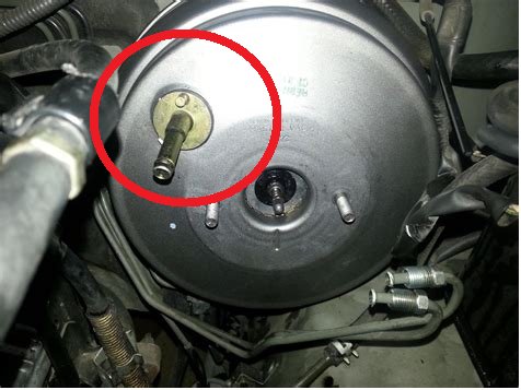

    Do you have the fancy master cylinder or the brake booster master cylinder?
    If you have the brake booster pictured below, you can pull the vacuum check valve (circled in red) from the booster and blow through it to see if it that's functioning properly.

    Let me go look real quick!

    Nothing...it's (the master cylinder) completely different that the picture you gave.
